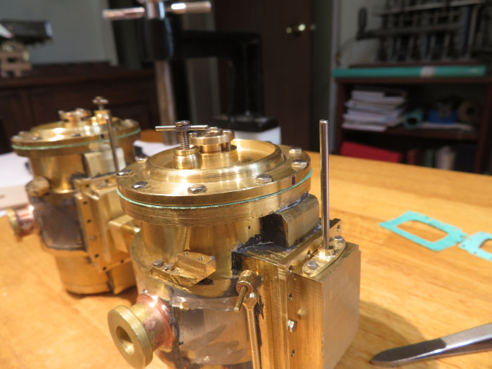

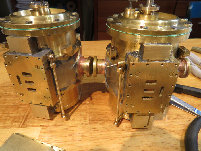

Thanks  guys! It assembled well, no leaks I  can find and all passages flow. Will know for sure later when high pressure added.

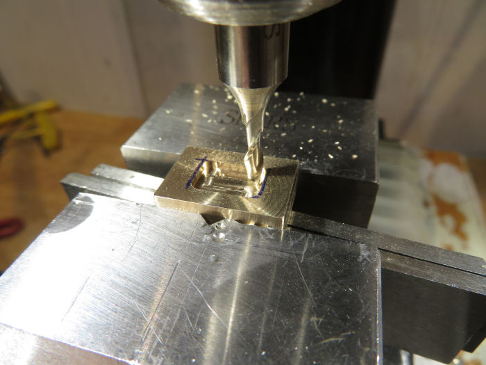

The lower cylinder drain valve handles/rods were turned up out of some rod stock, the horizontal pieces are screwed into the sides of the cylinder cap and ring, and the handle/rod pieces loctited together. They are dummy valves, at this scale the holes through would be too tiny to be of much practical use. I put larger screws into the bottom of the caps. I still need to do some more cleanup work on the flat passage bars above and below the steam chests.
Got a start on the valve sliders. The parts were sliced off the end of a piece of round bronze bar, taken to thickness on the lathe, squared up on the mill, and am milling the recesses in now.

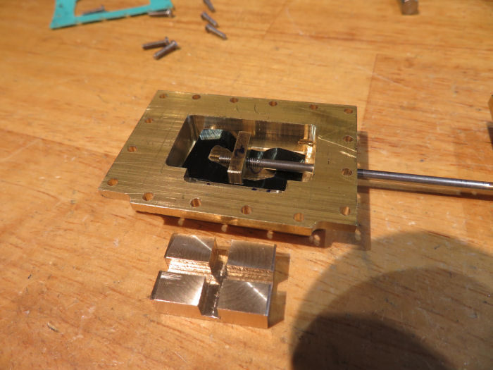

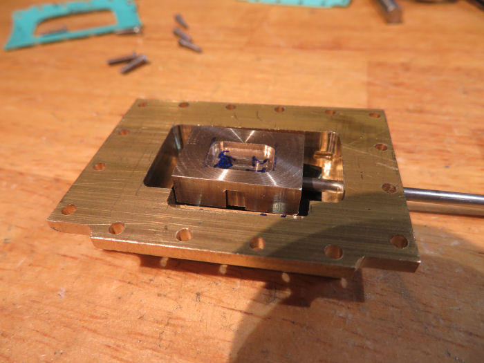

On the original engine, the valve slider is sprung against the outside of the cover, one reason is to keep it against the valve face when the cylinder rocks and the valve face goes past vertical. Its spring bolts to the top/middle of the cover to keep it in place, and to give the tension some adjustability. For the model, the available space makes that impractical, so I cut/bent up some sheet spring stock left over from clock pendulum work and laid that into the cover under the valve rod.
and with the valve set in place:
and the cover attached to the steam chest
