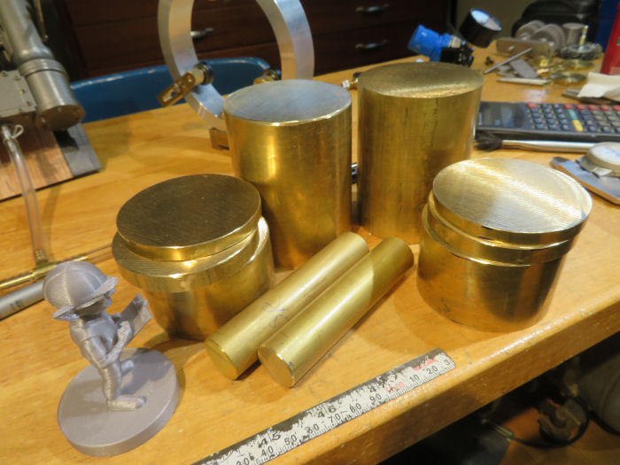

This morning, I got started cutting metal. The cylinder parts are being made from sections of a 2-3/4" brass round bar, plus a piece of 7/8" bar for the pivot trunnions (which also are the steam/exhaust passages).
The passages go from the trunnions, and around through the inside of the thicker rings on the outside of the cylinder to the steam chest. On the real engine these passages were cast in place in the cylinders. For the model, I am going to make the center rings and trunnions as subassemblies, then slide them onto the cylinders from the lower end. It is critical that the trunnions are in line with each other on either side of the cylinder, or it will not rotate freely. So, I will take the medium-length rods shown in the previous picture, drill/bore through the sides for the trunnions, and silver solder the trunnions to the rings. Then I can mill in the passages, with steps either side for covers to seal up the passages again. Then will bore out the center of the rings/trunnion assemblies, and slide them onto the cylinders (after the cylinders are turned). The other thinner discs in the picture will be the top/bottom covers on the cylinders. The full size engine has the cylinders cast/bored as blind holes, I will through-bore and cap the bottom of the cylinders to get the same look.  Its a lot of steps, hard to describe it all but it will be clearer as I proceed.

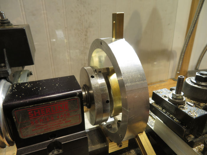

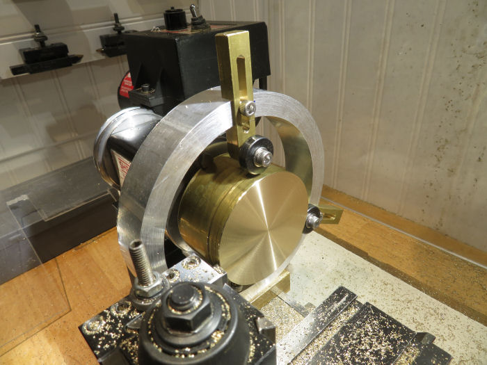

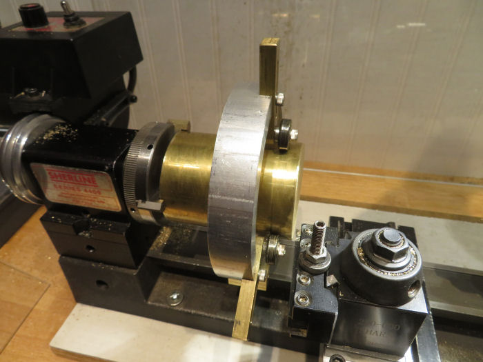

So, on to the parts! First steps were to clean up the sawn ends of all the bars. The top/bottom covers were easy, held in the 3-jaw chuck with the jaws reversed. Then moved on to the medium length bars. Perfect chance to try out the new steady rest I made the other day from a piece of aluminum pipe section and some roller blade ball bearings. Given that the reversed chuck jaws are fairly shallow, this gave enough stability to be able to face the ends without worrying about the bar being dislodged and falling out.

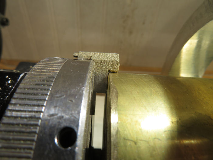

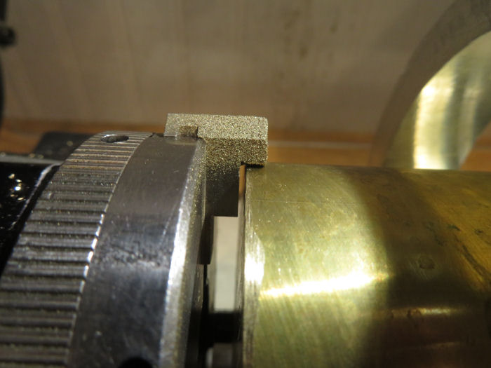

The sawn ends are not perfectly square, so with the bar straight in the chuck one or two jaws might have the bar fully seated,
while at least one has a gap:

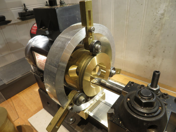

As you can see, not a lot of engagement for several pounds of bar hanging out! With the steady rest in place, I was able to adjust the arms till the bar ran true and all three bearings were in contact for the full revolution. I adjusted the arms initially with them right up near the chuck, then moved the rest out to be near the outer end of the bar.

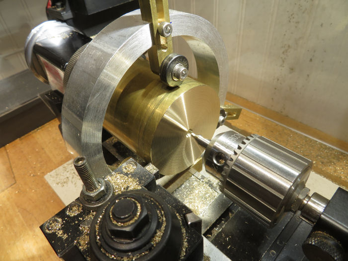

After trimming both ends of the shorter bars, I started in on the longer ones for the cylinders, with the rest moved out farther. The two ends of each were trimmed true and to length,
then center drilled so I can take the rest off and switch to supporting it with a live center, to turn down the outsides of the bar ater.
The steady rest is working very well, well worth the time to make it! Next I need to turn the trunnions to size/shape, with the flanges at the ends and the ends bored out - there will be an o-ring fitting that goes inside the trunnion ends to connect to the other piping. Then I'll set up to drill through the sides of the ring blocks to take the trunnions, and then be ready for silver soldering.

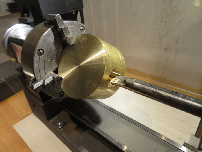

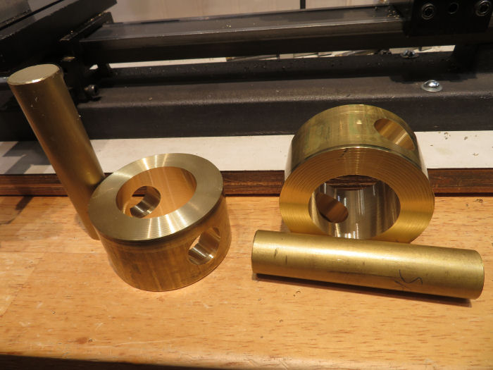

Today I started in on shaping the center ring blocks. Went through a couple ideas on how to hold/align then for cross drilling, then went back to a way that I've used before on rectangular blocks - using the sides of the jaws on the 4-jaw to clamp it in place. A little trial and error to get it centered, tightened it down, and it worked great. Drilled a starter hole through, then a smaller boring bar bnefore a larger one whicvh didn't chatter as much once the hole was large enough. The holes go all the way through the block, and will accept the trunnion rods once they are made.
Back to the flat setup with the steady rest, and bored out the centers part of the way to finish size. This is so there is a lot less mass to have to heat up to silver solder in the trunnions. I'll have to go back and trim the trunnions after soldering, but its still worth it.

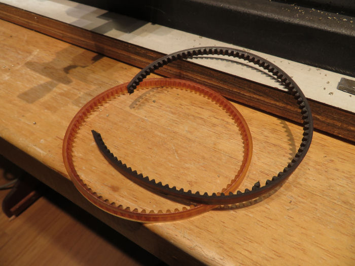

Got most of the way through the first block when the old belt on the spindle gave up. Fortunately I have several spares, since this happens every once in a while. These belts are the same ones used on sewing machines, so they are easy to get. This batch, it was actually cheaper to order them from England even with shipping. Go figure. LOTS cheaper than ordering the exact same belt number from Sherline as a spare. Price of one from them got me 6 from another seller. In the lower right you can see where a tooth broke off - I wonder if that jammed in the pulley and the shock snapped the belt? They are polyurethane belts with a bit of cord embedded around the outside.
Here are both blocks with the centers bored out, ready to turn the trunnions down...

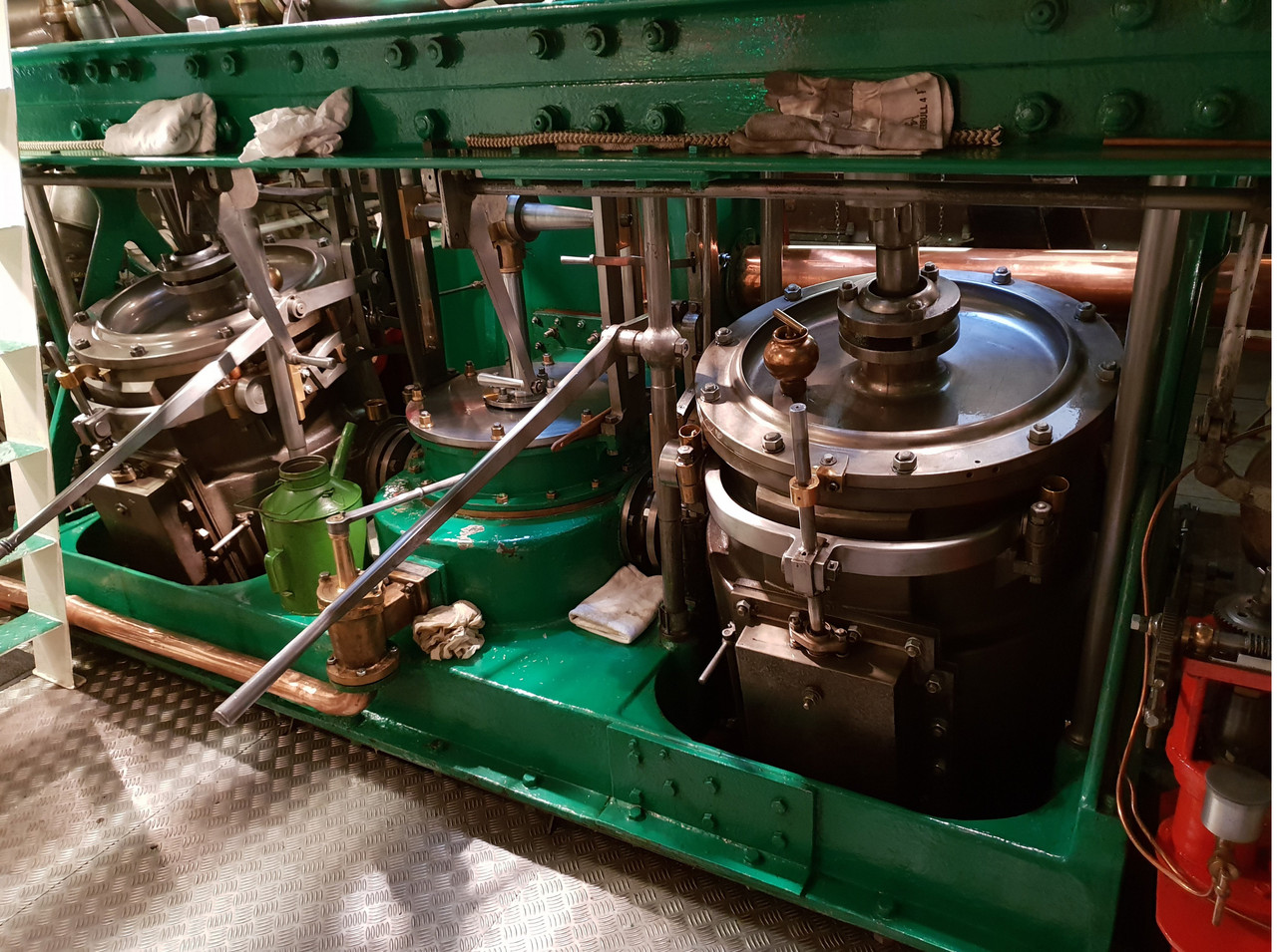

Hi Great to see this new engine build  :popcorn: :popcorn: :popcorn:  Did they use the river water for the initial firing up all those years ago ..and then relied on the condensate afterwards  ??  It is a good film and the engine driver gets a free sauna occasionally  :ThumbsUp: :ThumbsUp:
Willy
  • Posts: 2212
« Reply #12 on: May 19, 2026, 09:01:43 pm »
Hi Willy,
On board, there is a cistern where condensate and river water collect. This water is then used to supply the boiler. It is the last steamboat still fired by coal. The boiler is of the old "locomotive-type" design. However, I assume there is an oil separator to remove the steam oil.
  • Posts: 23620
« Reply #13 on: May 19, 2026, 09:52:18 pm »
Hi Michael,
Do you have a diagram showing the layout of the engineering deck on the ship, showing positions of the boiler, engine, etc?
