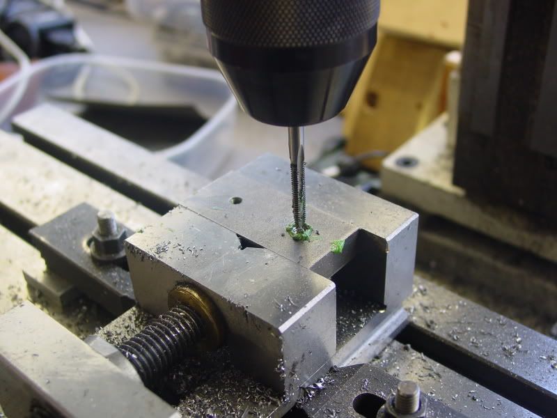

Well as my beam engine is an hold due to a few problems I decided to start on a rotary table as done by deano and also built & catalogued by Arnoldb. The pics show where I'm at for now as I'm going to get a piece of steel for the table Monday (I hope)

OK a bit more done today. I didn't take pics of the tapping of the holes for the shaft but I guess you all know how that goes. Also opened out the hole for the bearing in the base. That pretty much was my days work. More to come tomorrow ;D. My next real hurdle will be finding a worm and gear to suit as I'm not confident in that dept.  :( I will see if I can buy something close for this job as I don't want to stuff it all up.
