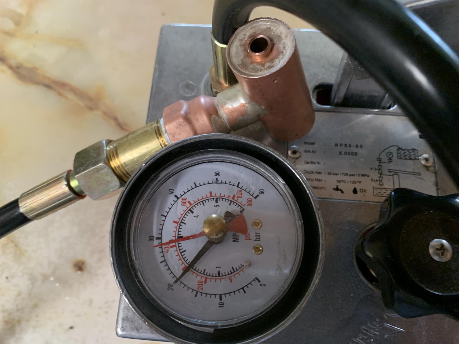

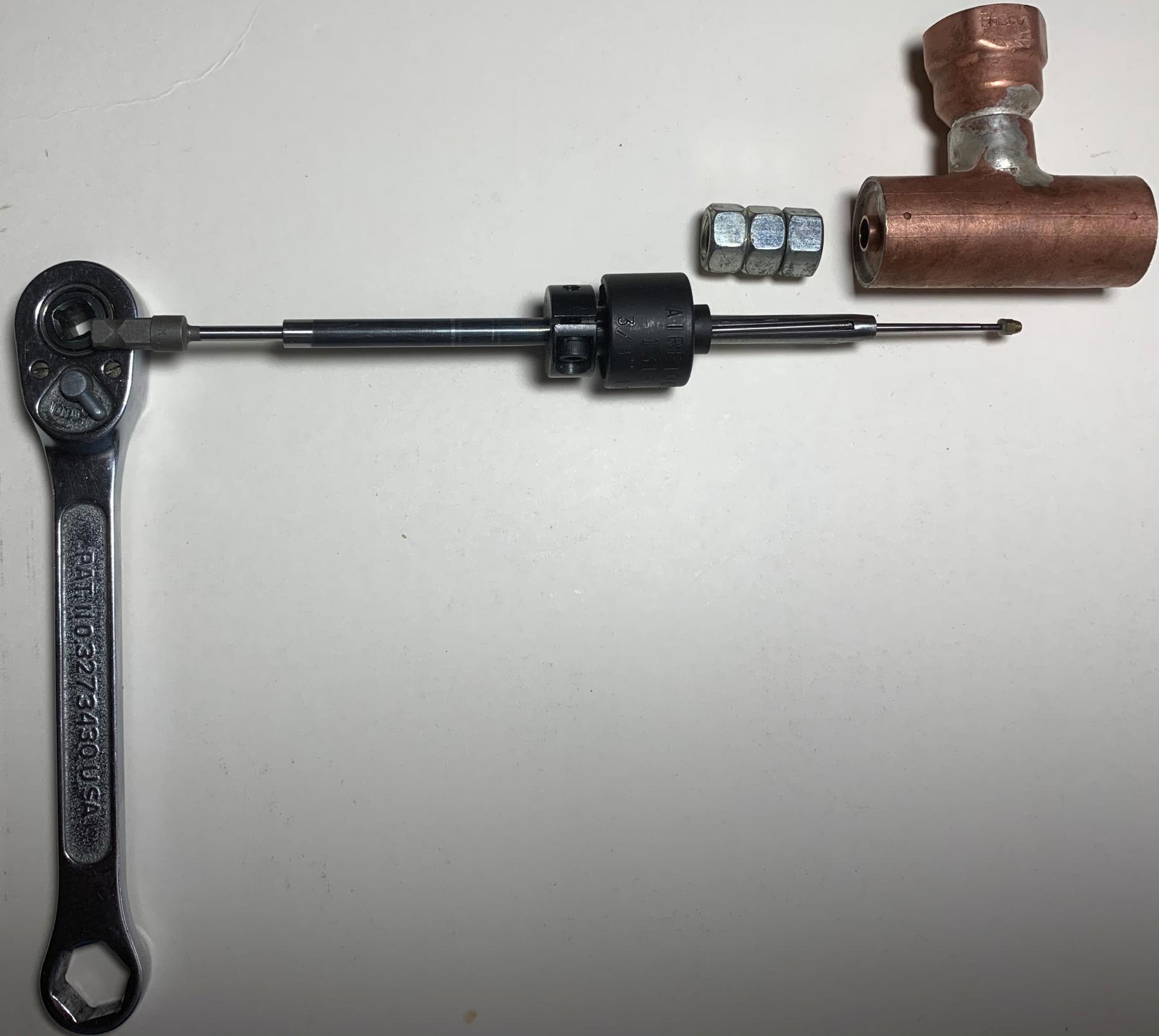

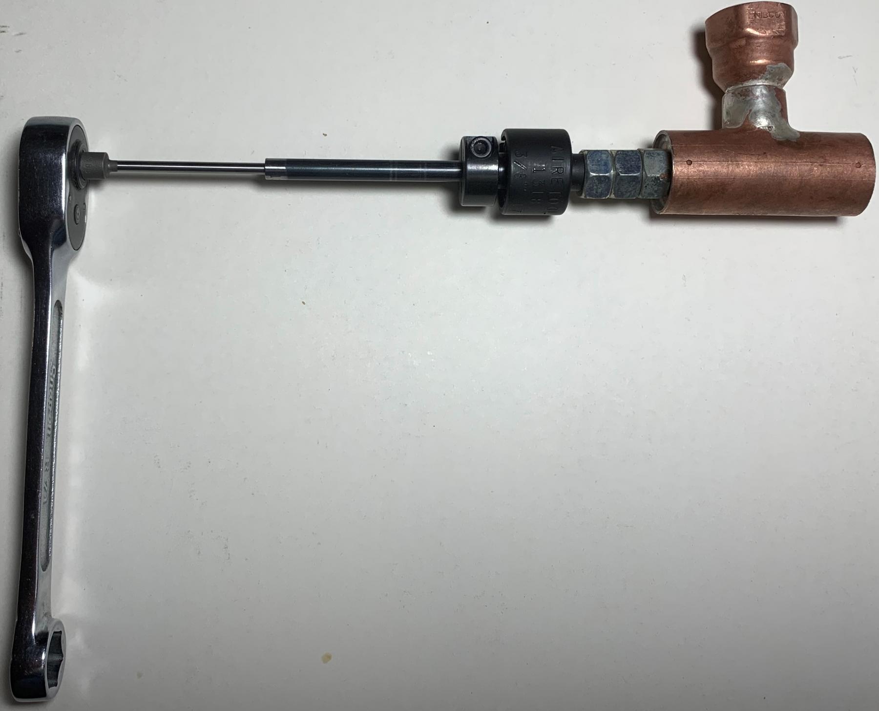

« Reply #5 on: May 03, 2017, 11:02:03 AM »
I thought I would get this overhaul wrapped in 3-4 days just by turning a few boiler accessories…but it was not so!
I did threaded bushings for the holes, then fill it with water (3.3 litre !) and tested the whole under water pressure, but no pressure at all, huge leaks from inside the brass flue tubes...
picture 1 :
I removed these tubes by drilling through them, with care to avoid that a tube fall inside the boiler !
photo 2
3 of them were cracked lengthwise, almost completely, hence the leaks !
photo 3
I rebored the end plates, and put back 4 larger copper tubes, by expansion, with 2 shop made cone plugs driven by a threaded rod and nuts.
Photo 4
My boiler with its new larger copper tubes on pressure test again, to my surprise, was now waterproof ! During the test 1-2 water drops were visible beyond 9 bar at the junction of the tubes with the boiler end plates, and no leak anywhere else on the boiler, pressure remaining stable at 8 bar (115 psi) for more than 30 min.
Maybe I might caulk these junctions with tin solder…
