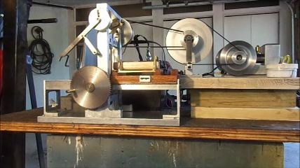

This is a video of the Odds and Ends hit and miss engine I built this past winter, driving the sawmill I designed and built last year, thru the clutch I designed this winter. It is running a new sawblade that Jim Dunmyer sent me. He has built this sawmill and exhibited it at a number of shows in USA, and done some experimenting to see what blade would cut with the least amount of drag on the engine. The sawmill works like a charm. The new design of clutch seems to work perfectly with no drag at all on the engine, when engaged or disengaged. The Odds and Ends engine (designed by Philip Duclos) works very well . Right at the very end of the video, where it quits going into "miss" mode, the engine had warmed up and was running a bit rich. After I was finished the video I turned the needle in about 1/4 turn, and the engine speeded up at the leaner setting and went back into its hit and miss cycle. ----Brian Rupnow

Brian that is awesome, I love to see engines doing something. You have been busy.

Thank you Don and Rick. If anyone is interested, I can post the link to a download for a complete set of plans for the sawmill or the clutch.---Brian

Wagonmkr--The Rupnow engine would power the sawmill with no problem. The following links will get you both the clutch and the sawmill.---Brian
http://download1476.mediafire.com/w6tc1wc53oug/8p5p4buuaaiug9d/MODEL+MULEY+SAWMILL.zip
http://www.mediafire.com/download/44yvgnp4saeajaa/CLUTCH_DETAIL_DRAWINGS.zip
