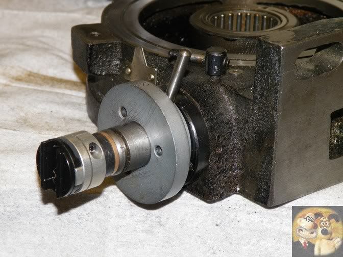

The Oilite bearing is the one I was waiting for. The ID is 14mm and the OD 20mm, The length was of no importance other than I needed to be able to part a washer off either end.
The LH bit is the cam action to disengage the worm from the wheel and is also the support bearing for the worm shaft, and the RH item is the worm shaft itself
The first job to be done was to part just over 2mm from either end of the Oilite bush, these will be my thrust washers.
Now a bit about Oilite machining. USE NO LUBE OR COOLANT, it already contains oil and you don't want to contaminate it with anything else. The next bit is most important, DON'T LET IT OVERHEAT, otherwise the oil it contains will turn runny and drip out of the bearing, not what you want to happen. Just take it steady, pecking away and letting it cool, then peck a bit more. My cut, which would normally be over in a few seconds, took me about two minutes for each end.
With it being made of a sintered material, it can easily break if you mishandle it, so take care when deburring.
The two washers were then lapped on the cut face until they measured the same thickness all around the washer. I used 1200 W&D used dry (again no oil or water). One turned out at 2.10mm and the other 2.15MM, perfect for the job in hand. That job took about 10 minutes.
This is a bad shot, I couldn't control my shakes, but what it shows is removing 4mm (roughly the thickness of the two washers added together) from the end that goes into the RT, closest to the worm. After machining this cast iron bearing (wobbling about all over the place because of the centre hole offset, the hole ran perfectly true) it was polished and chamfered on the end by hand while the chuck was turning.
The other end had the remaining 0.25mm taken off, purely because the turned face on the end looked like it had been done with a chisel. Again it was polished and chamfered.
So that was the sleeve done in a matter of minutes.

Now ths is where I change my mind from my previous plan of making my own Oldham coupling end. For two reasons, I had made a balls up of my initial calculations which would mean I would be doing finger gymnastics trying to assemble the coupling and set up for no end float at the same time down the length of a fairly small diameter tube.
The other reason was that when I stripped down to the thrust washers this evening, the wear pattern on the faces was absolutely perfect, so rather than spoiling a good thing, I decided to go with what I had.
So I cut some soft brass slugs from a bit of 2mm rod, ground down a couple of grub screws to the right length. Then it was just a matter of a slug down the hole followed by a grub screw, this will stop damage to the threads, set up the zero end float and tighten things up. It turned out perfect, no detectable end float and the whole lot turned as smooth as the proverbial babies bum.
So that left me going the normal route people would take, just fitting an Oldham coupling to the 12mm handle spigot. My problem, 1" diameter coupling, fine, 10mm bore, not good.
So a spell on the lathe with a boring bar had it opened up to the right size.
I need to mention a little about couplings such as this, especially the ones with this type of clamp system. On no account try to drill them out to size, all the cross cuts will deflect the drill, and the hole could end up almost anywhere. By boring, that problem doesn't occur, and only takes a few minutes anyway. That is a warning that should be followed unless you want to end up with a wobbly coupling.
So everything was to my liking, and it was time to assemble everything into a RT. Just a reverse of the strip down procedure, and I assembled everything with bedway oil, which will also be used during it's machining life, that is why ball oilers are fitted and not grease nipples. But again two little things I did extra.
If you notice the main clamp screw on the casting top, I have knocked the tightening finger pin all the way thru to one side, this makes it much easier to do up/undo, but the screw must be in position before the main table is put on, otherwise you won't be able to screw it into the hole.
The other, is the clamp ring that is screwed onto the end. It has four locating bolts, but also four adjusting screws that are used to remove end play in the spindle assembly to RT. A few minutes spent adjusting those and the locating bolts will get rid of all end play, but still allow smooth rotation of the worm spindle housing.
Just a little mechanical marking out/measuring exercise to find the PCD of the bolt holes in this flange. It will be used when the support tube is made.

The main cast iron sleeve was first shortened on the RH end by the thickness of two thrust bearings, then the centre hole was drilled and reamed to accept the two internally fitted needle roller bearings, which were loctited in place at either end of the hole. I found the easiest way to do those two jobs was to bore out my soft jaws and hold onto the main flange. That made both shortening and drilling/reaming a dead easy job, otherwise you would need to set up in the four jaw to get the thru hole done, as the part behind the flange is offset turned to allow adjustment of the worm engagement.
This picture shows after the bearings were fitted and held together with the special nut.
Unlike the Vertex RT conversion, this one cannot revert back to manual operation at a later date without some shaft rebuilding, purely because, if you look at the left hand side of the spindle, the skinny bit on the end has to be cut off, and a combination nut/Oldham coupling made up to get the drive to the RT.
Once the new coupling end was made, it was tightened up to give no end float, but also be free rotating. Once that state was achieved, a brass slug was dropped down the tapped hole in the side of the coupling followed by a very tight grub screw. That will make sure it doesn't come loose, but also not damage the threads, allowing disassembly if needed.
The motor shaft was shortened by 10mm, done purely to keep the tube as short as possible.
Once things were roughly assembled, the length of the tube can be worked out. The measurement was from the end of the spindle flange nearest the RT to the face of the main motor flange.
The end of the tube you can't see was recessed to the exact width of the spindle flange with a nice tight wringing fit. This end you can see had a recess put in it that was a tightish fit on the spigot on the motor flange.
The flange on the tube wasn't made too big in diameter and was about 4mm thick. The bore down the tube only really need to be big enough so that things don't foul down the inside, I made it about 4mm larger than the coupling OD. The OD of the main part of the tube was 6mm larger than the diameter of the spindle flange. This was all done as a wingit job, made to fit.
This is what it should look like when put together.
