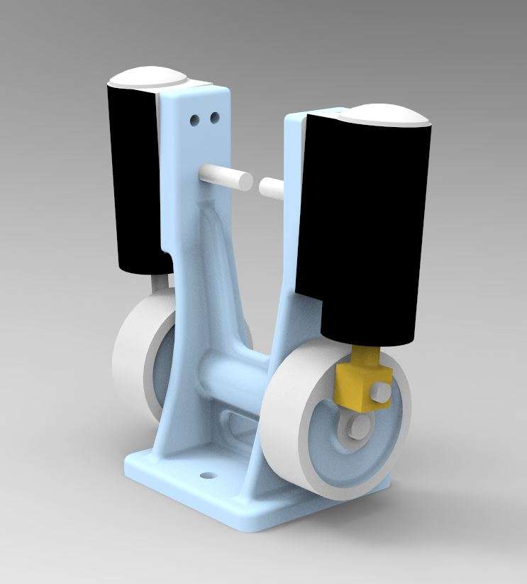

As usual I drew it up in Alibre in my preferred metric sizes which came out at 11mm bore x 12mm stroke.

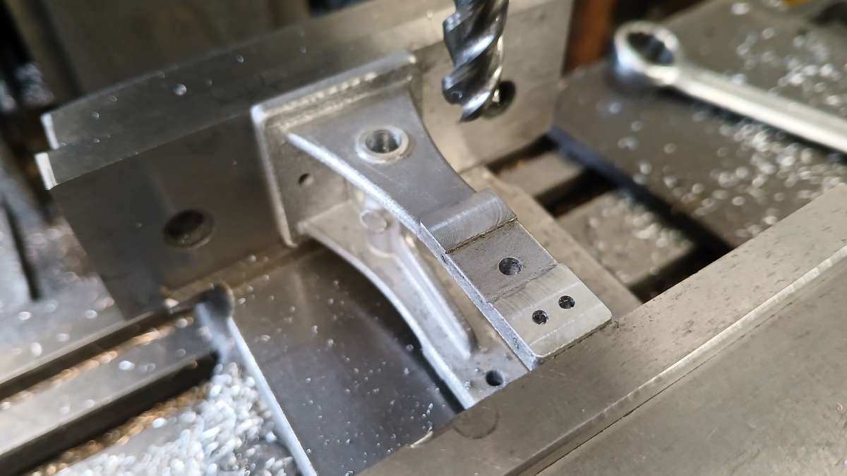

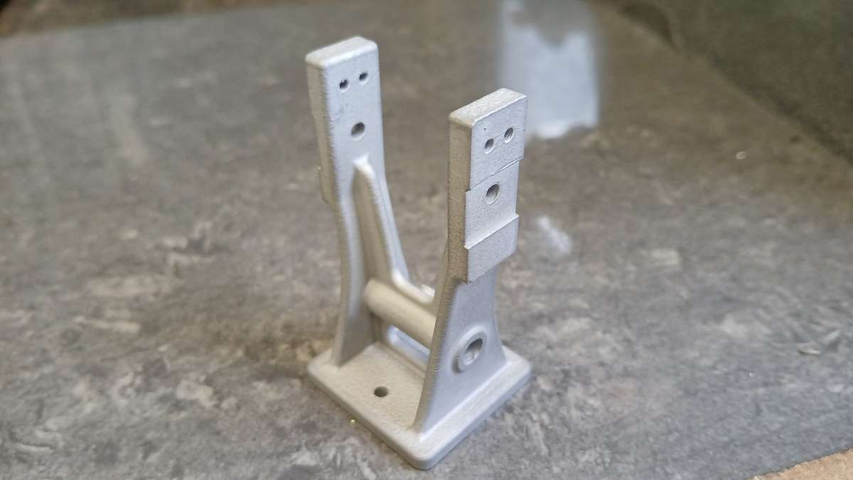

I also got the frame for this one (and something else) 3D printed in Aluminium by Craftcloud. Again I’m very happy with how the print came out, the bead blasted finish did not need touching so better than any castings I’ve had.
I did not take a lot of photos of this one as a lot of it is much the same as the previous two wobblers that I have recently described but here are the few I did take.
I included holes in the print which helps keep the cost down, they just needed opening up with a 0.2mm undersize drill and then reaming. The face of the bearing pockets and port faces also had the 0.5mm machining allowance I had included milled off. The material cuts fine with an aluminium specific carbide milling cutter though HSS would do just as well.

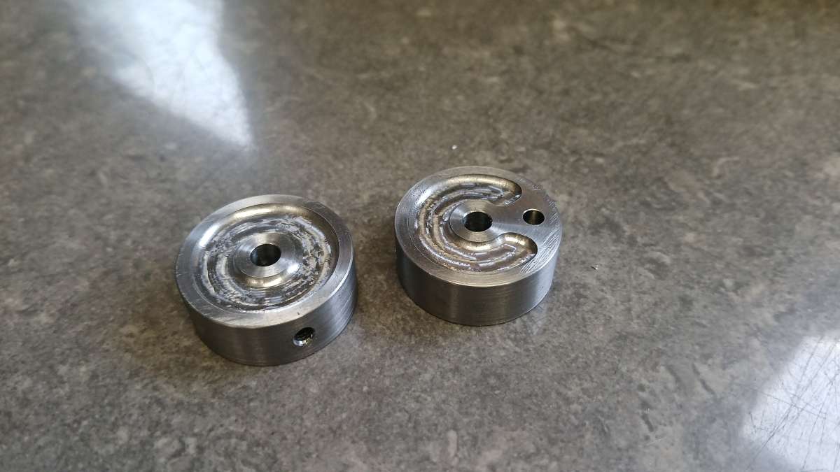

The 24mm diameter flywheel/crankwebs were cut from 25mm steel, reamed and the recesses cut on the CNC

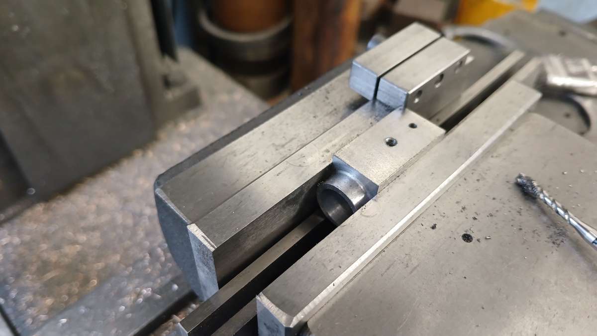

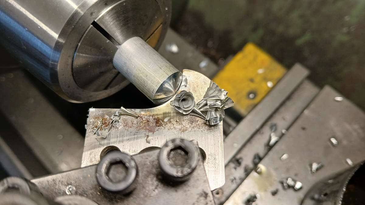

Cylinders were from some scrap cast iron, milled to overall size, bored and the rounded end turned before going back into the mill for the pivot and air holes. The outside was rounded in my usual way of milling facets and then blending with a file.
A HSS spindle moulder cutter was pressed into service as a form tool to round the cylinder top caps

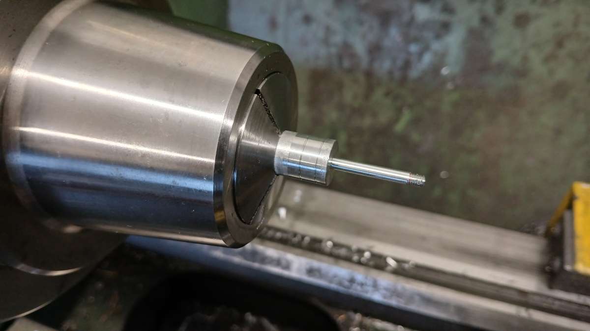

For a change I decided to make the pistons and their rods as a single item from 6082 rather than a separate stainless steel rod. Just a couple of oil grooves on this small one.

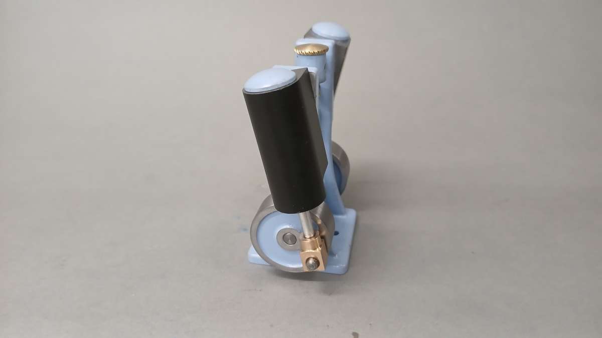

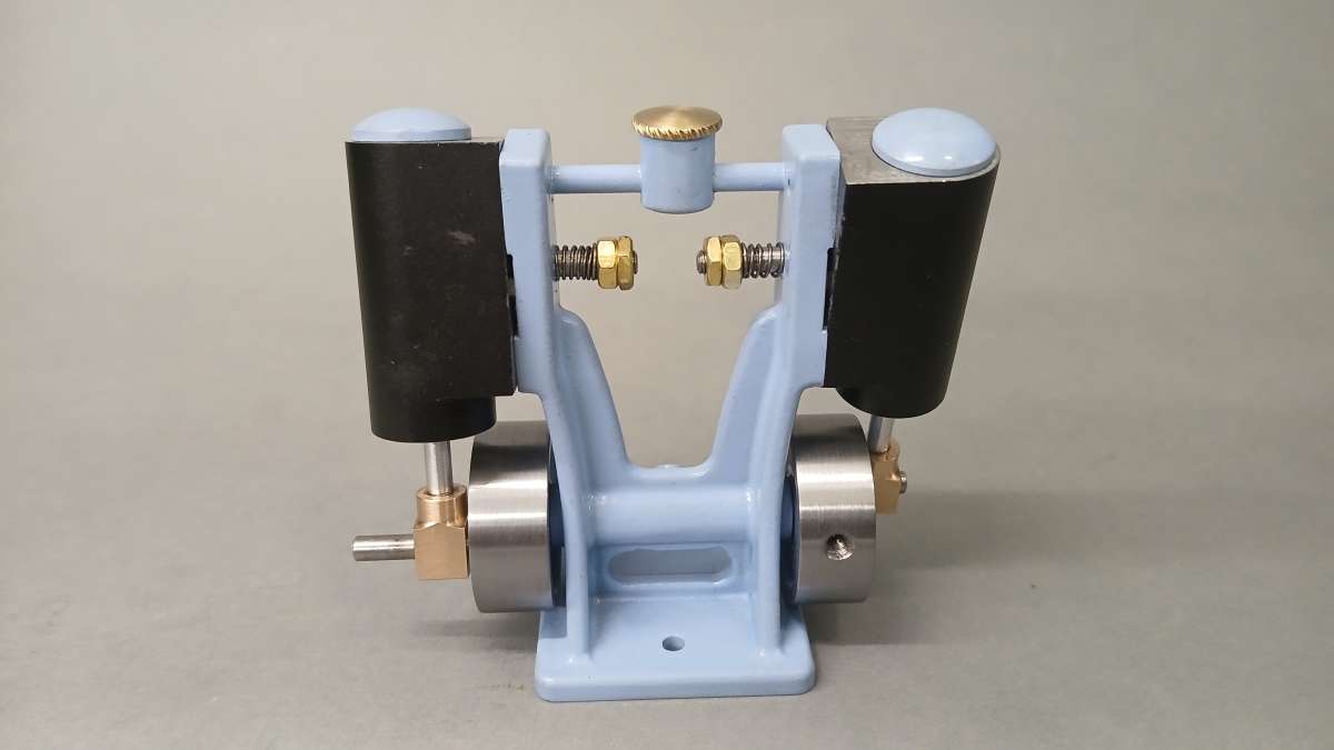

« Reply #1 on: February 20, 2026, 07:23:06 PM »

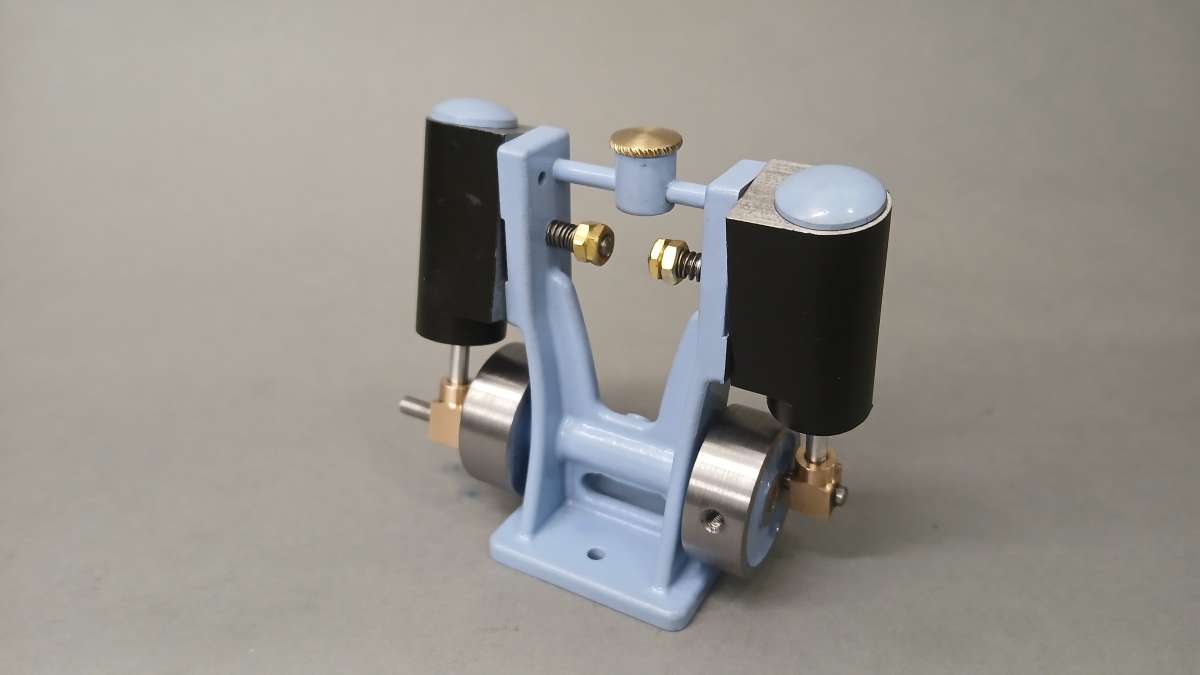

After a quick test run the engine was stripped down and cleaned with thinners before a lick of paint that was allowed to dry overnight. Then back together and ready to play. :pinkelephant:

« Reply #2 on: February 20, 2026, 07:28:35 PM »
Very nice and a good throaty sound! How did you fix the cylinder caps, Loctite?
  • Posts: 1362
Re: BLT Bassett-Lowke Twin Replica
« Reply #3 on: February 20, 2026, 07:30:01 PM »
...and is that a little lubricator in the middle? Oh yeah the original ad says that's what it is, but it isn't a displacement lubricator is it, it doesn't seem deep enough?

Thanks All
Yes the caps are just loctited in place, do make sure you allow enough time for it to cure as they can fly quite a long way if they pop off.  :-[
It is more of an oiling point, undo the cap, put in a drop of oil and that will find it's way to the cylinders and port faces. At least that is how I interpreted the way it looked.
Dave, it is very easy to upload an .STP file and get a quote. Just watch how the units come out, I find I have to use the "scale" tab and set everything to 1000% otherwise it wants to print some very small parts. Easy enough to check as it gives the overall dimensions of the part.
I had two engine frames done and including taxes and postage it cost £55GBP, this wa sthe smaller of the two so about £25 for this one and the other £30. Playing with quantities helps as they tend to have a minimum "job cost" so it was about £52 if I just had this one frame done adding the second only put the total up slightly.
