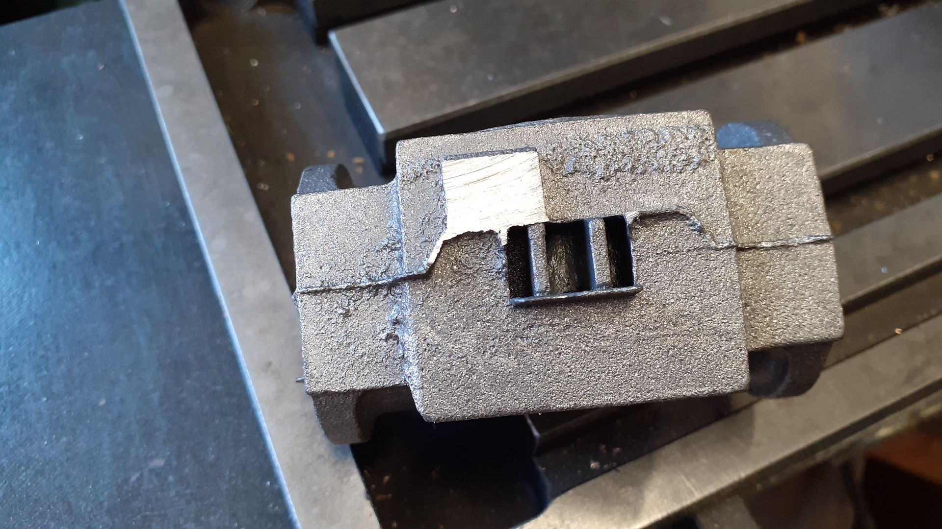

This is an MkI no.8 which means it doesn't have a trunk guide, just a single sided crosshead. The original pictures make it look like its done, painted, mounted nicely and someone has even gone to the trouble of labelling it with transfers.

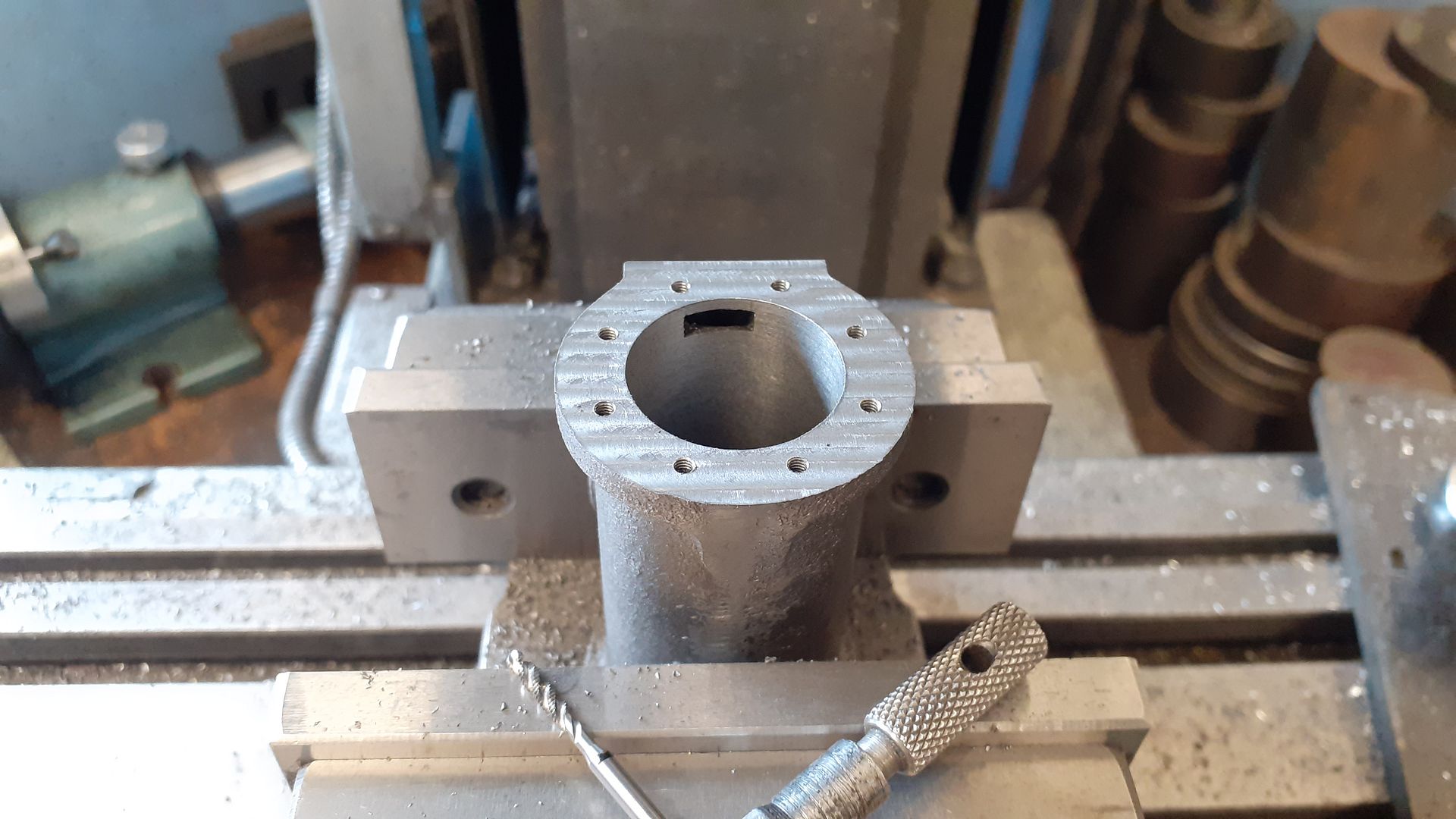

I guessed that wasn't the full story when I got it as it was cheap, so eyes wide open! The engine doesn't run, the valve has been remade and there was an actual nut holding the valve rod tightly in position. The valve also scraped along the port face and the valve chest. The holes from the ports to the cylinder are slots rather then drilled holes and one is particularly wonky. There is also no valve gland and rod goes straight into the valve chest.

More pictures and also I have now detected there's a mix of metric and Imperial ::)

Really great what you're doing! That port angle really surprised me. So much so that I thought maybe it was an intended  feature for some reason I didn't understand. Since it's square cornered it must have been cast in place, or was chipped out with a chisel. Probably cast in place with a core.
I've seen good illustrations of those rectangular section steam cylinder port cores and core boxes to make them -- Terry Aspin's drawings. I guess that one must have floated out of position during the iron pour, or partially broken inside the casting and twisted.
What do the ports look like at the steam chest end? Are they aligned there?
Online Sanjay F
  • Posts: 2513
Re: A messed up Stuart no.8 Mk I
« Reply #3 on: December 13, 2025, 04:38:14 pm »
That's a good point, I never looked at the steam chest end! The slots continue all the way through to the ports, you can see them on the photos.

My guess then is that the core broke inside the cylinder and twisted. The passageway stayed connected however because these cores probably had a piece of wire inside to reinforce them. After the pour the sand core falls apart and the wire is withdrawn. Still, if it's a single break there will be some misalignment between the two rectangular channels. I guess the original builder might have cleared some of this with a needle file or other tool, or maybe they had enough overlap to work as is.
