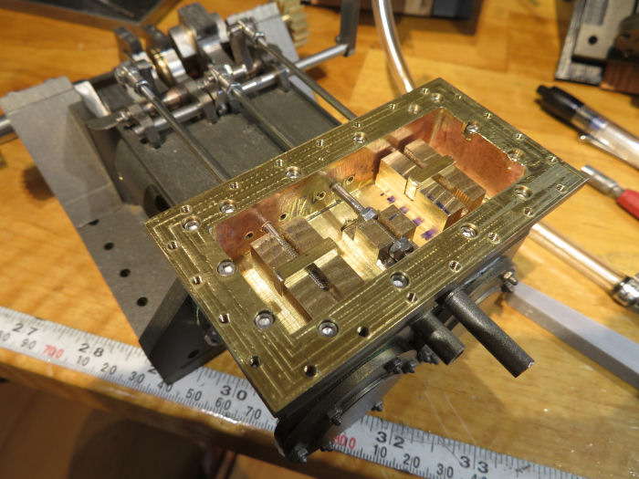

On to the next couple engines!  After some MORE time playing with the Marion engine,  :cartwheel: , Its still running quite well, finally turned off the compressor and got a start on cutting the blocks for the Bucyrus and Erie valves. The Thew valves will be a bit different so will do those separately. So far have the four bronze valve blocks trimmed to overall size, ready to start shaping details in.

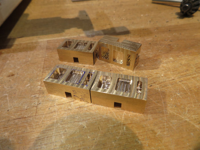

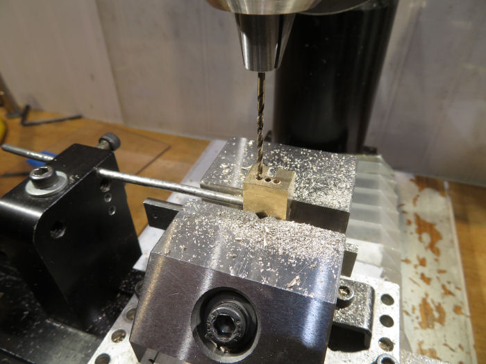

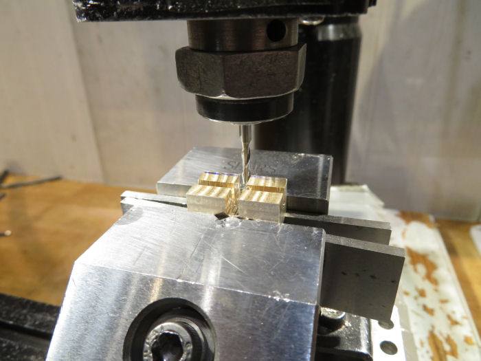

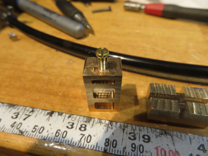

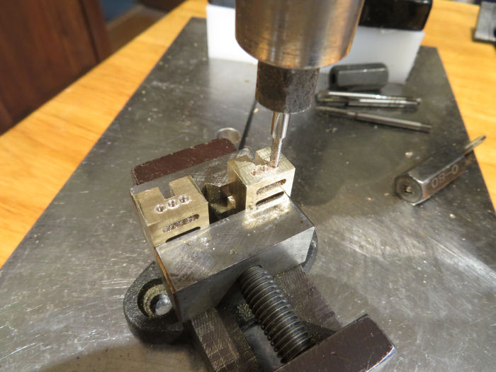

After wrestling the bronze blocks away from the shop elves, I got started shaping them down. All of these steps were production-lined, using the work stop in the vise to position the blocks the same spot repetitively. Started by milling the slot down the length for the valve rod, and a cross slot for the adjusting nut. On these two engines the rod is too close to the valve face to have room for even small-pattern nuts like I did on the Marion valves, so I'm going back to the more tradition model engine style with a wide bar with threaded hole near one edge for adjusting the valve position.
Then drilled three side-by-side holes in each one to connect the two end chambers. Since the whole valve is shallower, also had to switch from two 4-40 holes to three 2-56 holes. Like on the Marion valves, these holes extend from one end through to where the far chamber will be.

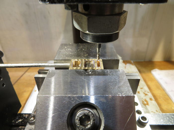

Then set up to mill the chambers in. To speed things up since I am making four identical valves, I got set up for one cut at a time on the first valve, then repeated the cut for each of the others. That saved a LOT of time stopping to measure and sneak up on each position. The center chamber is .050" deep, the end ones are .150" deep to connect with the drilled passages.
The four valves so far...
Then tapped the ends of the holes for plugs,
and loctited in the ends of 2-56 brass screws. They were then cut and trimmed off flush.
Still left to do on these: make a batch of the adjusting nuts, and lap the bottom faces of the valves. Then I can start installing the first pair on the Bucyrus engine and getting it timed and running. After that, I need to drill/tap the cylinder drain holes in the Erie cylinders, and get that one assembled and running. Then can do the drains on the the Thew engine, and make/install its valves. Going to be a busy few days!
