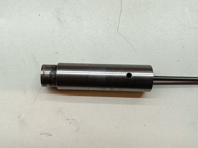

Started the displacer cylinder by turning down the outside of a mild steel rod to 15.4mm first (to suit o-rings I have) rather than have to use a wooden mandrel later and find I couldn't get the OD right. Next I drilled the hole for the connecting pipe, figuring it would be easier to do on a solid metal rod than a very thin walled one. Following that, drilled then bored out the ID to 14.25mm leaving a wall thickness of about 0.6mm. I only have a 6mm boring bar and the displacer is 52mm long so I decided to do one half, flip it round then do the other as absolute concentricity and finish isn't essential.
Since the displacer is 12.7 dia I have a radial gap between it and the displacer cylinder of 0.75mm which should be ok.

Next I need to make the end cap and the rectangular plate which will be soldered about 6mm in from the end which will allow in to fit in a recess in the frame while compressing the o-ring by about 20-25% which I think is about right.

Made the rectangular displacer cylinder collar to size and made some small holes for the screws and the centre of the cylinder. Prepared the frame, glued the two together then drilled through to make sure the holes are nicely up. Separated the parts then bored out the collar to fit. Next the diasplacer end cap then solder the bits together.

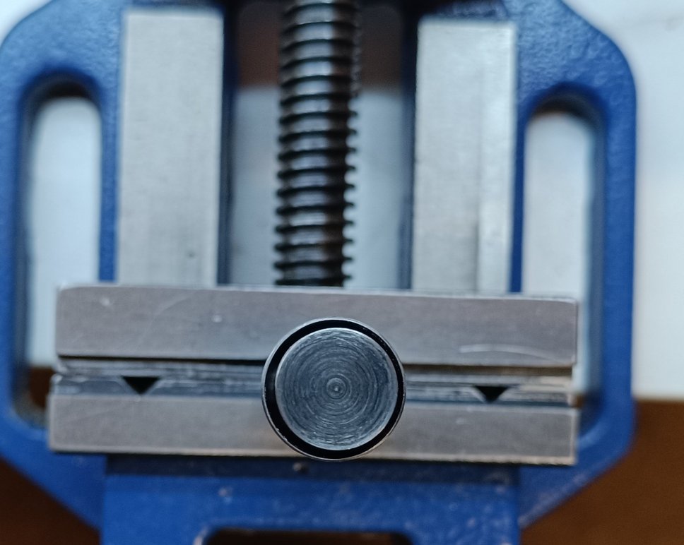

Today I made the displacer cylinder end cap and left it about 0.5mm wider than the tube for better solder contact area as per vtsteam's advice. I then silver soldered the cap and then the collar near the other end. You might just see there's about 1mm showing either side of the o-ring and I'm aiming for about 1mm compression so 3mm will go into the recess which is the next task. I also threaded the four blind holes that shorter versions of these screws will go into. The hole facing the camera in the second photo is for the pipe to connect to the power cylinder.
I was pretty generous with the solder to make sure the thing is airtight but it'll be a while before I can test that. Now it needs some cleaning up!

Time to make the connection to the frame so I drilled and threaded a 10mm through hole then bored a 3mm deep rebate none of which was much fun: the off-centre part induced horrible vibration, the outside jaws meant I had to keep stopping to apply cutting oil and it was hard to see what was happening. I had to do the boring at a lower than ideal speed which also generated some high pitched chatter. In the middle of all this I accidentally disassembled the quick change tool post and for the life of me couldn't get it to go back together such that the handle ended up in the right place! After about half an hour of cursing it finally agreed to play ball. To top things off, when I removed the part from the chuck I found I'd also been trying to thread one of the jaws - I thought the last millimetre was hard going!  :lolb: I now have a little groove in the last tooth of that jaw but hopefully it will have nothing more than a cosmetic impact.
Anyway, here's the part and happy to say it at least fits together well despite all the tribulations.
