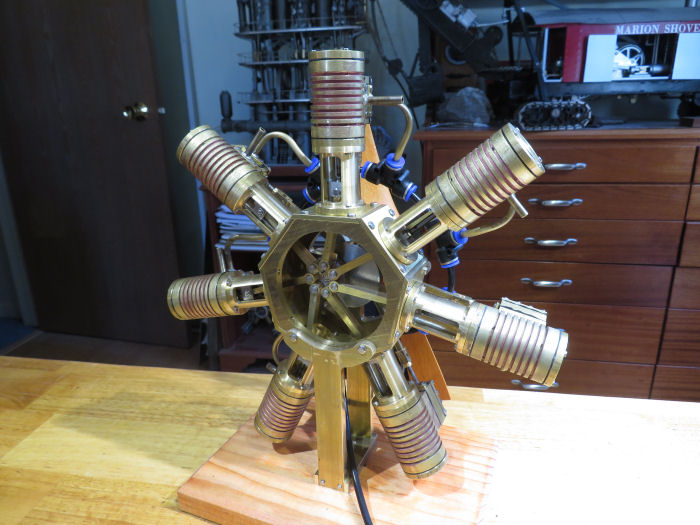

Here is my build of a 7 cylinder double-acting radial steam engine. It is not based on any real original engine, but is patterned loosely on the internal-combustion radial engines common on early aircraft. Being double-acting, there are 14 power strokes per revolution of the crankshaft, so it self-starts very easily, and runs at a fairly slow speed down to about 10 psi. For the video below, I had the air line from the compressor set up for 60 psi with a needle valve inline to control the air flow and speed, rather than adjusting the pressure regulator. I find this works much better, since if the engine gets under load or has a sticky spot and slows down, the pressure in the line goes up and gives the pistons a little more power.
The propeller for an engine this size would be quite large, and have to hang off the table, so in the interests of space and safety I put on a cut-down prop instead. It gives quite a good breeze even at slow speeds!
A couple pictures of the engine:
And here is a video of the engine running:

For some reason the motion of the crank connections doesn't look like I expected it to (dunno what I was expecting but there you go!). What are you doing about lubrication? I might have missed the answer somewhere in the build thread but you're making engines quicker than I can read about them  :Lol:
  • Posts: 23436
Re: 7 Cylinder Double Acting Steam Engine Complete
« Reply #5 on: August 01, 2025, 09:32:43 pm »
Thanks guys! This was a fun build, went a lot quicker than I expected, but thats mainly due to production lining the steps on each part.
Paul, the connections for con rods and such are all stainless steel and bronze, I just put a drop of oil on them once in a while and they are happy. The piston rings are viton O rings, again with some oil.
