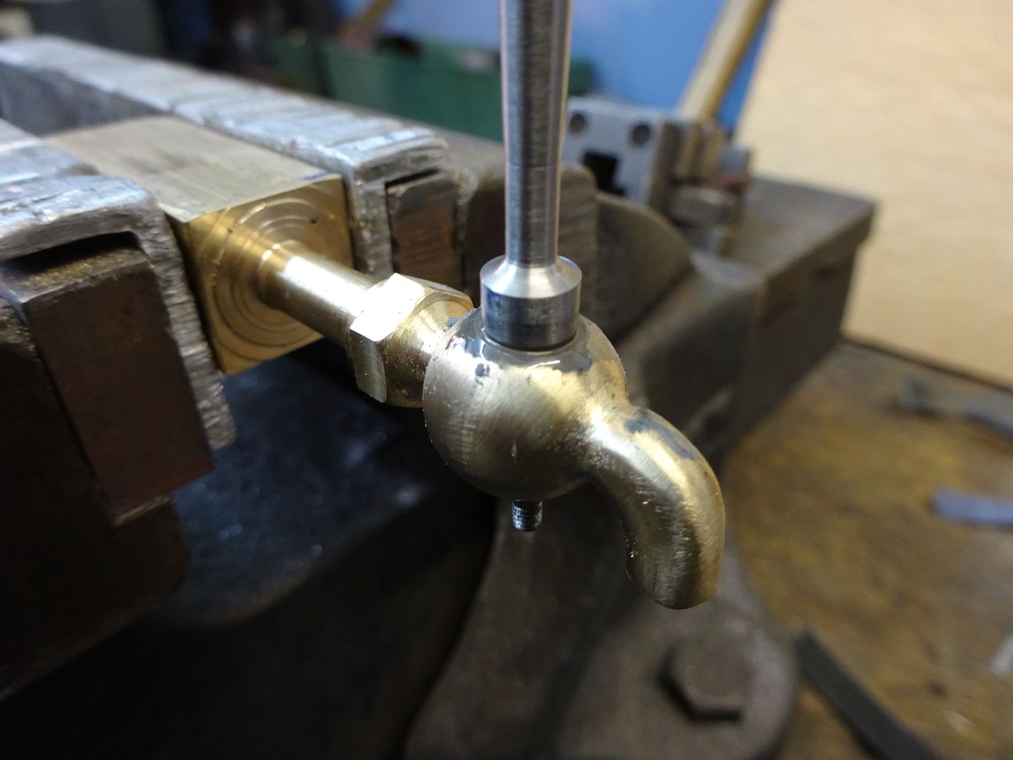

I have a loco to repair, the drain cocks on the underside of the cylinder are of the taper plug type working together from a lever in the cab.
Please tell me is there a specific reason that these type are used and if a valve with a parallel plug machined with a shoulder to the rear.
I have been thinking this through and I maybe snow blind with it now so hence the appeal for some wise words.

I believe that a taper was used to allow the plug to be ground/lapped into the valve body. It did not require precise machining to obtain a good seal.
A parallel plug will require an accurate bore to be machined along with a matching plug. A taper plug will just require a tapered D bit reamer to be machined at the same setting as the plugs.

As Roger says the tapered cocks tended to be used where they were sealing against pressure. On something like a water supply from a tender to pump a parallel sides valve may have been used.
Tapered are easy to make, lap to a good seal and can be held in close contact by either a nut pulling the tapered cock into the valve dody or a stuffing gland and nut pushing it in.
Some model makers use a parallel design but have a PTFE insert which is a firm fit and takes care of sealing and any slight deviation in machining.

One view - I can't remember where from, and will have to paraphrase: "The taper plug cock was invented by the ancient Romans, and has been used ever since. It has been a piece of crap for 2000 years."

..... It has been a piece of crap for 2000 years."
I quite agree! I built two sets of tapered three-cock gauge-glass valves for my 5" gauge Britannia and just couldn't get them to seal. Eventually, I remade them as parallel bore with two miniature "O" rings and they worked perfectly. There is a write-up somewhere on my website if anyone is interested.

As mentioned, lapping them will get a great seal. I've  used fine Timesavers compound.   They seal and work great.

Yes lapping seems to help a lot, I use Silicone Carbide powder and oil
Also cut the cock and the tapered reamer at the same lathe setting

I think a suitable reamer will be made and a stock of bodies made for the winter shedding.
