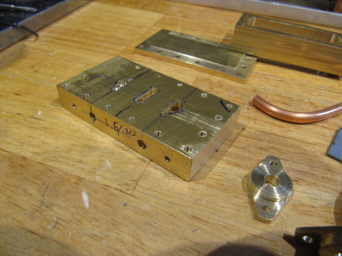

Back in the shop again this morning, and got the ports/passages for the control valve milled/drilled in. These will direct steam/exhaust to the appropriate ports in the cylinder valves, depending on which direction the control valve is moved. Each end port has a passage out to the side of the valve body.
and the middle port has a hole out to the flange on the bottom, which will get the exhaust pipe soldered to it:

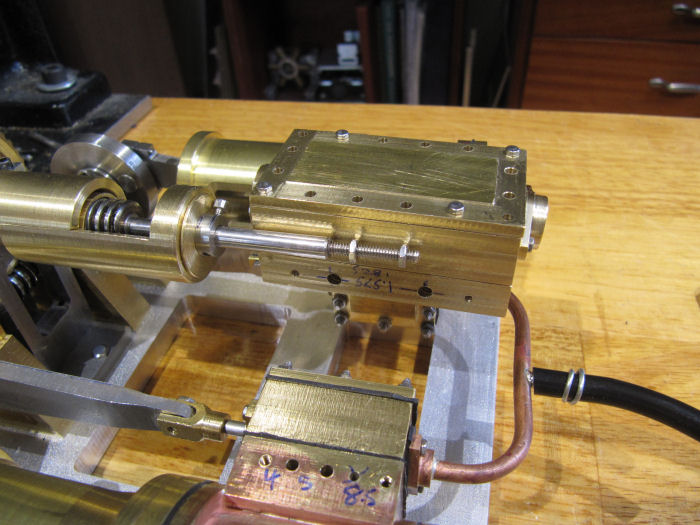

Also cut the valve rod to length, and drilled/tapped the end for a length of 4-40 threaded stock cut off a 1" screw, which will serve to hold the valve slider. In this picture the valve body is set next to the valve rod to help judge the length of the valve rod needed.
Then set the valve body onto the rod to measure the height needed for the frames to hold the control valve to the floor plate.
Next up will make the support frames for the valve body, which will leave the valve slider, the two manifolds out to the cylinders, and some gaskets to make. Oh, and some more pipes for the inlet/exhaust. And the lower chain guides. And anything else I'm forgetting. But, getting close to running it for real!

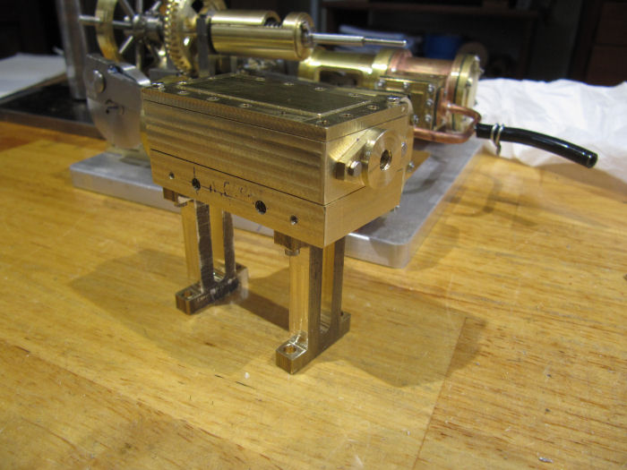

« Reply #226 on: June 16, 2025, 06:54:04 pm »
and a simple set of stands made for the control valve...

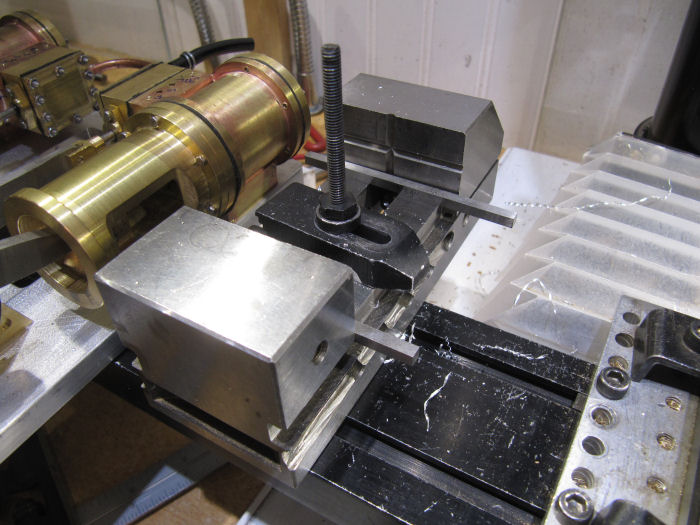

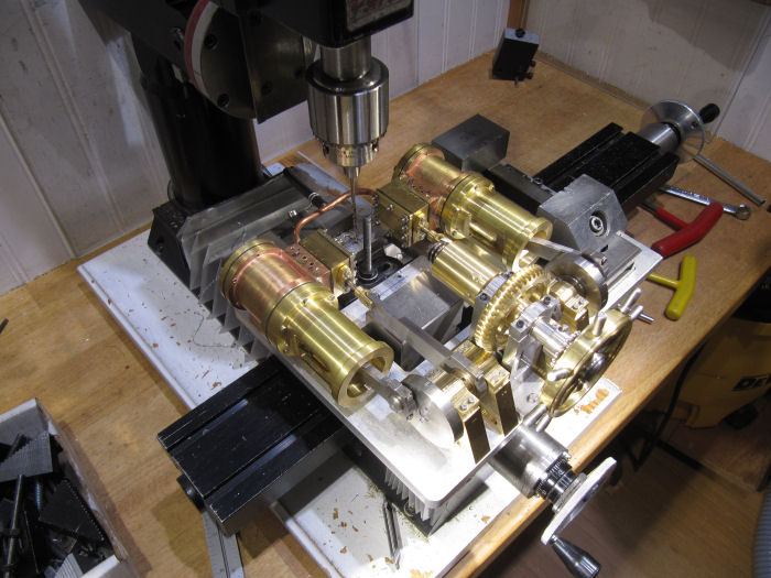

Took a bit of experimenting to find a way to hold the engine for drilling the floor plate without disassembling it all (and did not want to use the 'unexpected rapid disassembly' method that SpaceX uses on their test rockets), and came up with this spare vise clamped to the mill table:
that would hold the floor plate through the openings for drilling:
That got the holes drilled for holding the control valve frames to the floor
Before bolting it up permanantly, it needs to have the gaskets for the steam chest made, the exhaust pipe soldered to the flange underneath, gaskets made, and the top face lapped for the valve slider. In the meantime, the shop elves were making up teams to use it as an air hockey table...

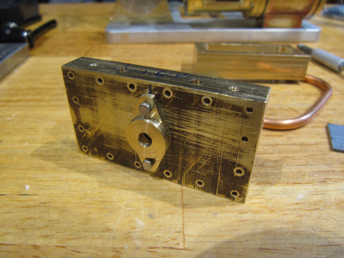

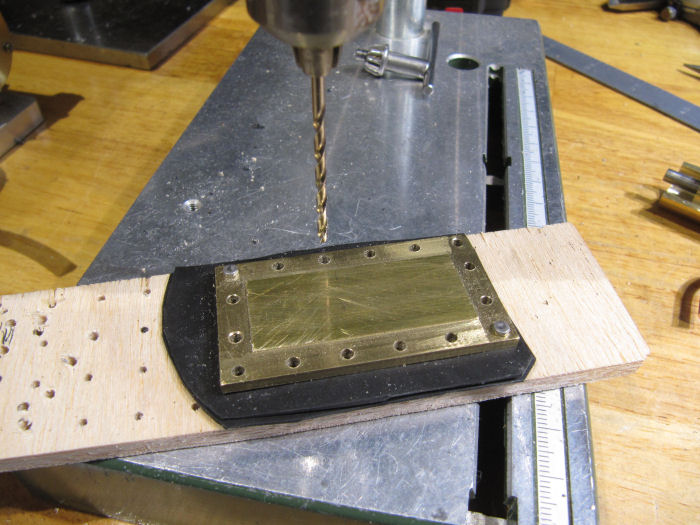

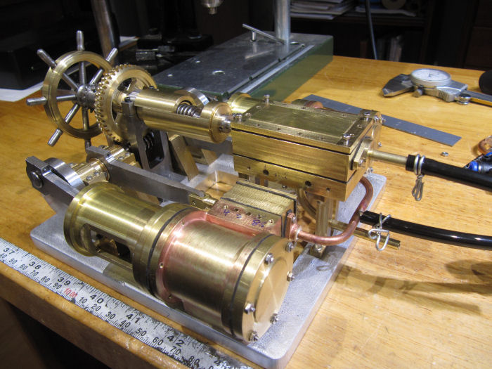

This morning got the gaskets made. The way I like to do them is to use the cover plate as a drill guide, and drill through the gasket material into a piece of wood with the clearance size drill. First drill a corner, put in a screw to keep it from slipping, another drill/screw in the opposite corner, then go around and drill the rest. Since the gassket material is flexible, it leaves a tight fitting hole around each screw.
Then put onto the steam chest, and trimmed around the outside with scissors and the inside with a fresh exacto blade.
Easy sequence, no punches needed. Then the valve face was lapped smooth on a diamond sharpening plate, first coarse side then fine side. Also made and installed the exhaust pipe into the flange on the bottom.
And the base was screwed down to the floor plate, here it is with the parts all set in place on top of it.
Next I'll make the manifolds that take the steam/exhaust passages from the control valve base out to the ports on top of the cylinder steam chest bases, then go back and make the control valve slider. At that point it should run with input from the steering wheel!

Hi "C" , interesting shapes on the ports to control the action requirements ..never seen this before  :ThumbsUp: :popcorn:
Willy
  • Posts: 23181
Re: Chris's New Steering Engine
« Reply #236 on: June 18, 2025, 10:41:00 pm »
Willy
Hi Willy!  These ports have a triangular shape to give the engine a softer start then higher flow, to act as a throttle. On the other steering engine based on Michaels engine, the port ends were angled for the same effect, and the Mann Steam Wagon had the same pointed openings as this model.

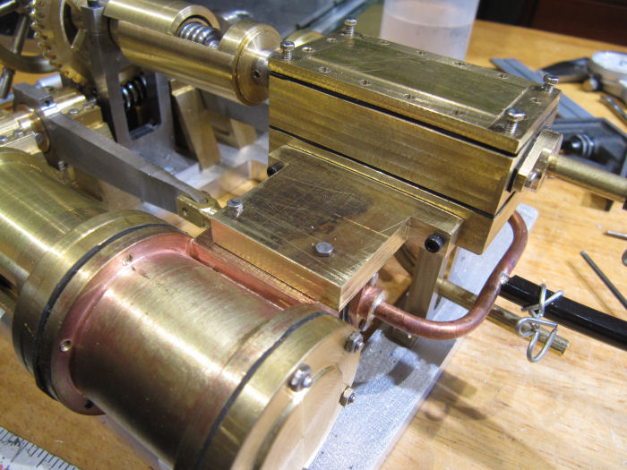

  • Posts: 23181
« Reply #239 on: June 19, 2025, 04:14:51 pm »
Got the manifolds to connect the passages on the cylinders to the control valve finished up, just need to make the gastkets for them...
That just leaves the slide valve/adjusting nut assembly, and the lower chain guides and chain to add in!
