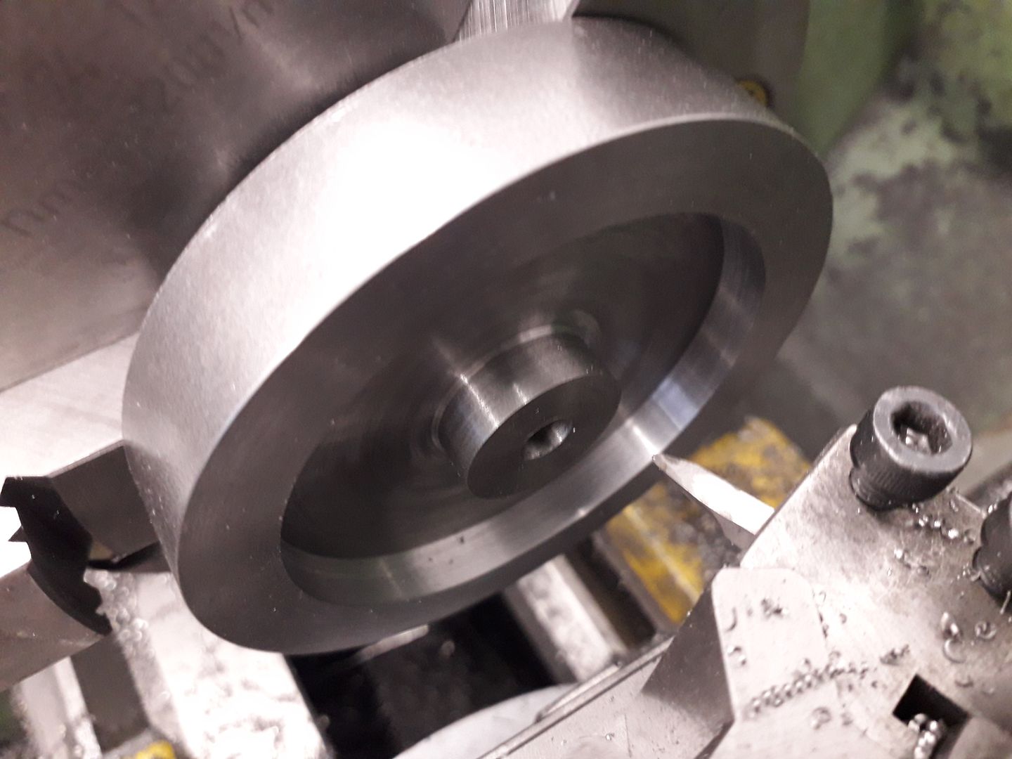

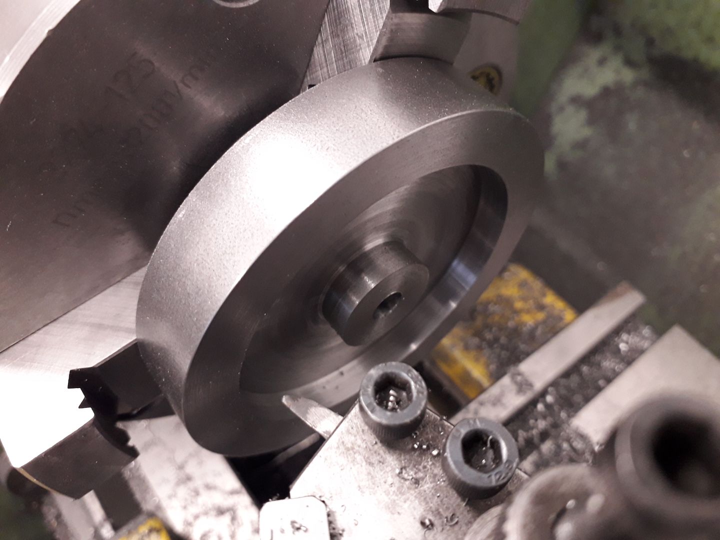

I need to cut a recess in my simple flywheel like the attached. I've done this before using either pointy left and right hand tools, simply digging in a bit somewhere in the middle of the area to be removed and working up to the inner and outer shoulders but I wonder what the effect of (gently!) using a parting tool (say 2mm wide) would be to make a better defined starting point? I guess there would be uneven load on the left and right edges but would it be significantly bad?
Is there some other 'proper' way to do this operation on a lathe with simple HSS tools?

A parting tool will not work as there is no side clearance, so it will just rub.
I normally do it the way you have described.
Phil P

I have done it as described, using HSS tools I grind myself.

the tool is very easy to grind, with sufficient clearance on the left-hand side depending on the diameter so as not to rub, then just move the tool and with the lathe turning in reverse to finish the part near the hub.
making a clearance on each side risks weakening the tool with chattering if the metal is very hard and the cavity is deep.

I usually do it much as you describe except I don't swap between left and right hand tools. I work out towards the hrimwith the lathe running in the usual direction and in towards the hub with the lathe running in reverse. Saves time and you feed in to the same handwheel depth to get a flat bottom. Careful if you have a screw on chuck when runing backwards.
If the topslide is angles a few degrees you can also mimic the draft angle of the cast looking flywheel you are trying to make.

I was turning the flywheel for Val I have a lathe tool that is HHS and a fairly sharp tip. Used it like a boring tool on the outside of the lip running the lath in reverse. Then put the lathe in forward and turned the hub. I think I just happened to have that tool ground that way. It also helps that I have an indicator that clamps onto the ways to have the two halves match up.

Thank you Art. When running in reverse I take it you're working on the 'far side' of the rim so the same tool can be used (to cut on top as normal)? I don't think my cross slide will reach that far without swinging the toolpost round which then puts the tool at the wrong angle.

Would this be a long thin tool shape like the one in Jason's photo that you angle depending upon which corner you're working on?
