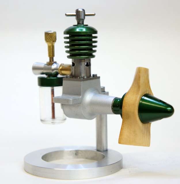

I recently inherited a very very good Set of Drawings from  german Gentleman,i paid 50€ for those 21 pages of excellent Quality and now thought it would be a interesting but also challenging Build .
Please check the Actual size of the Engine beside my thumb.
My idea was to make this engine maybe at 200% scale as a side project beside the Deutz engine .
Would scaling the Drawings work by just double the dimensions ,or would the Engine then become to heavy i wondered.  Maybe on some parts material could be removed more ? For example when i douböe the dimensions of a backplate or certain wall thicknesses ,it wouldnt make a lot sense to just double the numbers. My concerns are about the internals,rod ,crankshaft and liner and Piston,.
Has anyone here already did something like scale up such a model
Here a picture, please look closley to spot the actual size of this beast,it can be overseeen  :o

could your casting be for the 0,30cc Kratmo ( a very rare engine ) , because to me it looks it has some web cast on the frontside

As it is so small I don't think scaling it up by 200% will be too much of a problem, you can always compare it with some other engine designs of the new capacity and make any adjustments needed. I'm assuming you mean scale the sizes by 200% not the capacity, if it is capacity then there is not much of a size change so just apply the scaling factor to all parts.
It would not be too costly to get the crankcase 3D metal printed which would save a lot of time cutting from solid.
Yes Jo's looks to be a different engine, her's has the mounting lugs carry around to front and also a web vertically at the front.
It could be. My supplier did not know what it was for. He did not have any drawings with it and when I saw yours they are the right sort of dimensions.

Looking a bit more I wonder if this one even used a casting, it is the type of crankcase that just needs the nose piece turning and then the shape of the crankcase can just be milled - top, tapered sides and curved bottom to leave the lugs. Similar style to the 1cc Weaver
I suppose it depends if they were also teaching them pattern making and casting or just machining.
Any clue on the drawing as to whether it mentions a casting or aluminium specification?

yes jason, i also believe they just milled the crankcase,because in the Drawings is no Casting mentioned, and since those are realy good drawings i would assume it would have been mentioned if they worked from Castings. and yes there is a material mentioned , i have toi check the alloy.
btw, the weaver is a Goliath compared to this little fella :)
