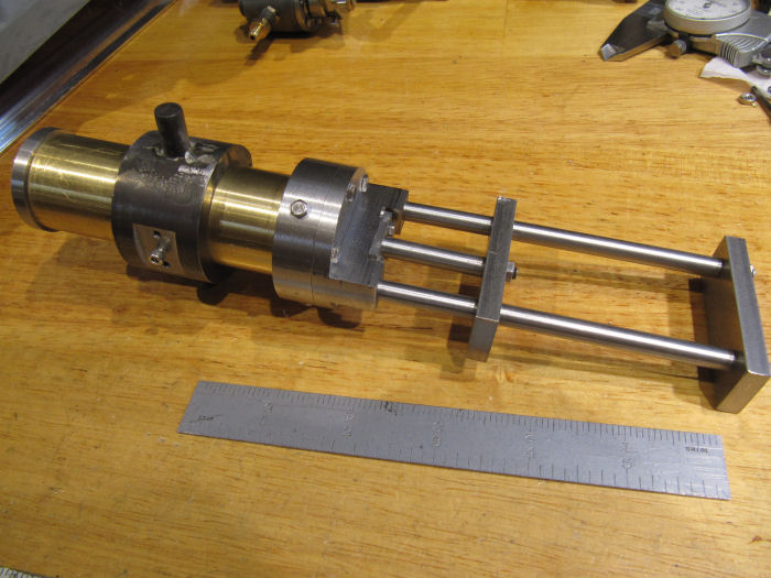

Guide rods are made, with the ends drilled/tapped for lengths from some 8-32 screws. I like doing it that way to get a full thread right up to a sqaure shoulder. Also made the piston rod the same way, have not made the piston head or the bearings for the sliding plate yet. Here are the parts so far assembled on the cylinder. The piston rod is bolted to the middle plate, which will slide back and forth on the guide rods. The middle and end plate still get more shaping for the blade holder and the valve link pivots.

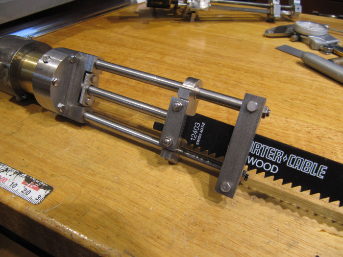

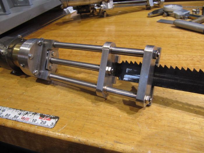

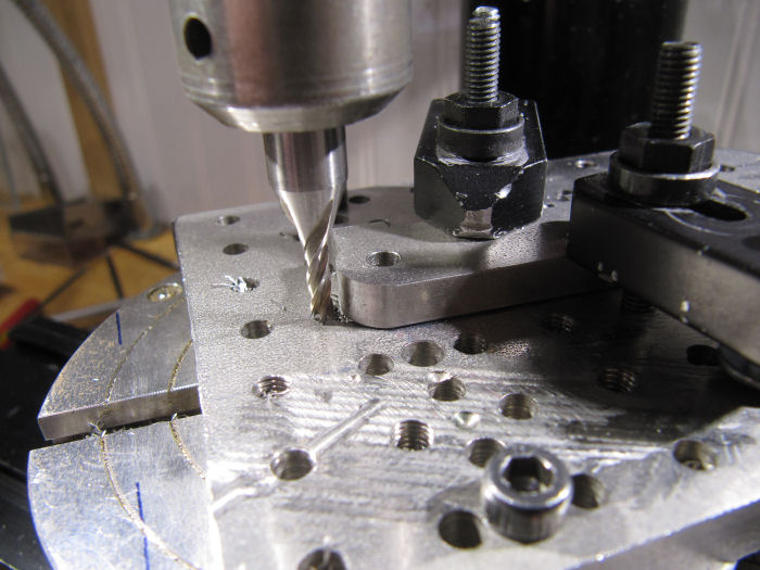

« Reply #38 on: August 26, 2024, 04:24:42 pm »
Back in the shop this morning, got the bearings for the middle slider plate turned up, and did more shaping/drilling on the two plates:
Here are things so far. More shaping needed on the blade clamp bars, and also add the pivot holes for the valve links:

 :ThumbsUp: :ThumbsUp: :ThumbsUp: :popcorn: :popcorn: :popcorn: Looking great Chris! the blade fits well.

easiest way to get a scale saw blade,  :cheers:
I never needed to plug in a Porter, but if I did I'd find a Porter cable.  :Lol:   :facepalm2: (sorry worst pun this week)  :facepalm:
Worst so far - the week is young!   :Jester:
So THATS where the scale saw went, Slim borrowed it!   :Jester:

The blade holder and all is looking great. And the saws-all blade sure looks the right size for the project!  :ThumbsUp: :popcorn:

And I  forgot to mention,  the block holding the end of the blade has a little post on the underside that fits into the hole in the  base of the blade to lock it in place. That block was salvaged from the first Ransome attempt.
