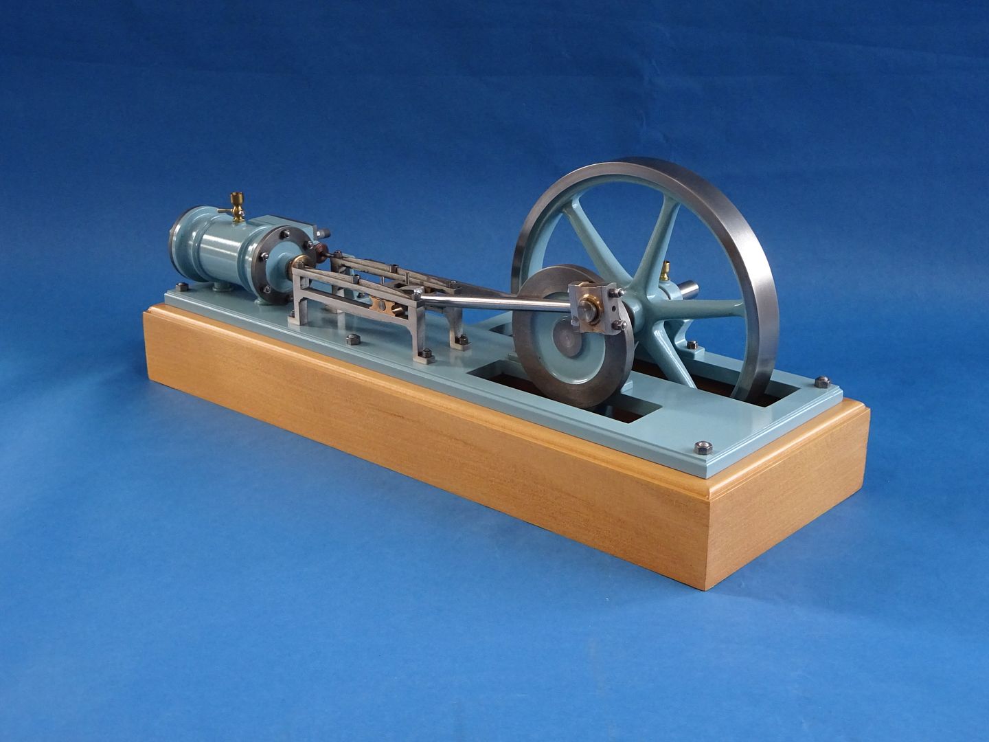

As for plans for something similar there are very few twin horizontals about. The  above mentioned Twin Victoria would need a lot of alteration to get close to this style of engine as it is based on a taller cast bed.
You will probably have to find a single that you like the look of and mirror it's major components like cylinder and trunk guides. Crankshaft bearings will only need one on each side and the shaft itself altered to take the two rods at 90deg to each other.
As an example this is one I designed based on a general arrangement that was in one of the very first editions of Model Engineer magazine. I have done a quick mirror of my 3D assembly to give an idea of what it may look like though I'd bring the two engines in a bit closer together.. A more shapely base to more closely match Sanjay's could quiet easily be cut from some 5/16 or 3/8 aluminium plate. It's all fabricated so would also be a lot cheaper than the Stuart option even if you only bought spare parts from them, similar sort of bore at 24mm to the Stuart 1"
