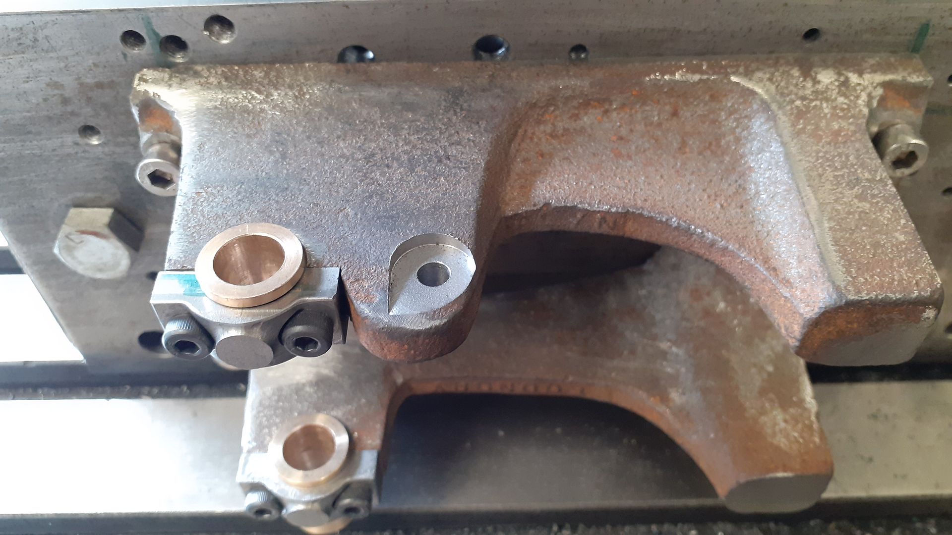

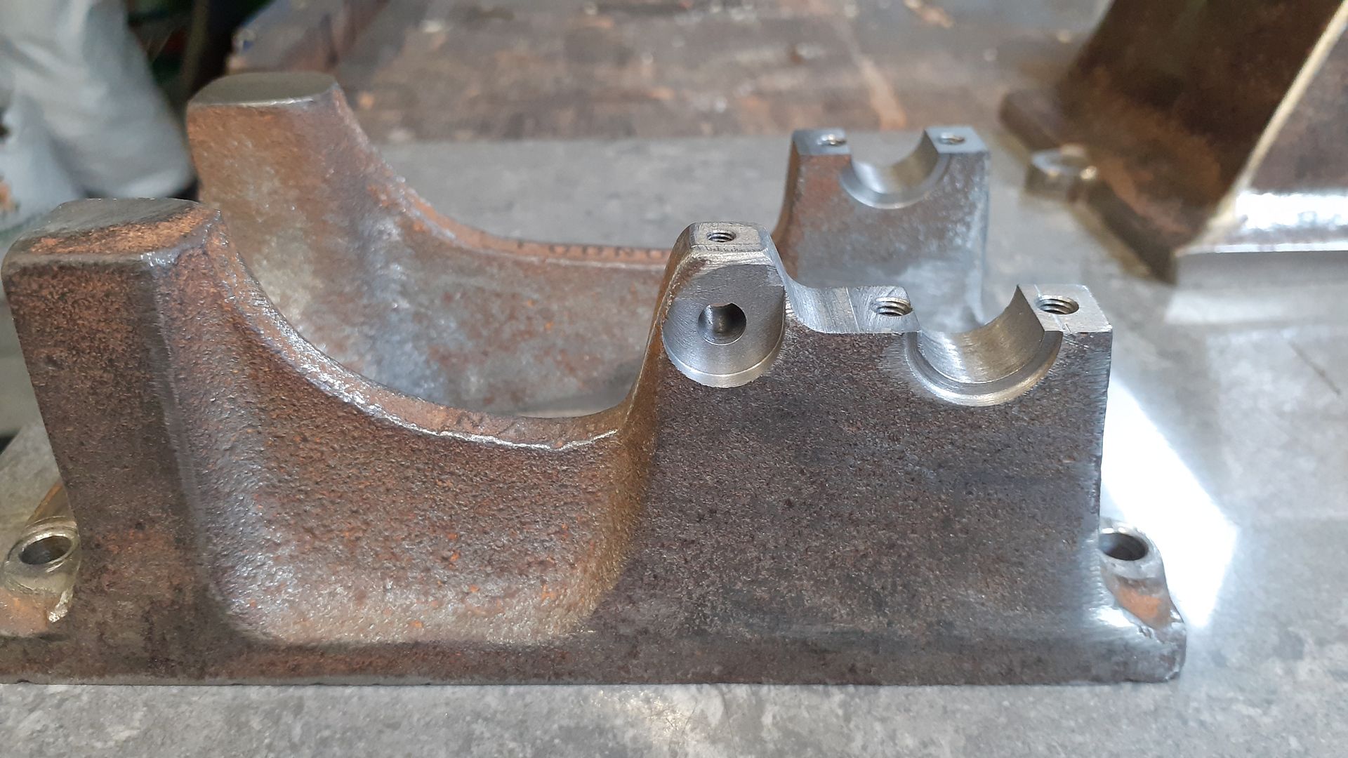

Before machining the main crankcase casting of the RLE it is worth getting the bearing caps ready. These are supplied as one so after a skim cut to flatten the bottom and then the ends with the now flat bottom against the vice fixed jaw the casting can be cut in two. Well actually you can cut it into three as there is plenty of length and it's quicker to saw away a waste piece than turn it into chips.
I can see how Graham made the pattern many moons ago simply by gluing a piece of half round timber moulding onto a flat piece and adding a bit of draft around the edges. This gives the profile shown top right in the following photo and if we assume the radius of the "hump" is where the green sharpie mark is then most of the material needs to come off the bottom which combined with a bit of flattening of the hump results in the section shown top left. I went a bit further and used the excess height of the hump to provide enough material to form a boss that can later be drilled and tapped for an oil pot - middle bottom. Clearance hole scan be drilled and spot faced so the caps are ready for when they are needed.
The crankcase was shimmed up on the mill table to get it to sit nice and level and not be distorted by clamping pressure and the facemill used to flatten it's bottom. Now that I had a solid surface it could be set up on the table with some parallel packing below and set to get the best centre line of the casting in line with the mill's X-axis. I started out buy locating the four hold down bolt holes so they sat reasonably central to the cast bosses noting their positions on the DRO before spot facing to give the nuts a good surface to tighten down onto.
Next the vertical face that the cylinder flange mates to was squared up, just taking off the bare minimum at the top and down low enough that the flange clears the step left by machining away the draft angle. I later blended that small step in to leave a smooth fillet where the vertical meets the horizontal as I'm fussy like that..
Moving to the other end of the casting the bearing split line was milled down to the required 41mm above the bottom of the base and the stud holes drilled and tapped M4. You can see in the photo that I'm using a spiral flute tap, I've almost gone over to these exclusively as they cut well, clean out the swarf as they go and it means you only need to tap once not two or three times as you do with the usual set of three taps.
For the following operations I like to use a machining plate as it gives good flat surfaces that you can run a DTI against when setting up the irregular shaped casting and also gives a good surface to clamp down.
Here I have clocked the long edge of my well used machining plate true along the mill's X-axis, located that edge and established my ctr line a known distance from it (50mm in this case) and then using the previously noted DRO positions drilled and tapped so the casting can be screwed to the plate. The bearing caps were then screwed into place ready for boring.
Knowing the exact lathe ctr height above my cross slide and the thickness of the plate it was simple to work out how much packing was needed to bring the bearing split line upto ctr height, clock the edge of the plate true across the lathe and then start machining. First I used a 16mm 4-flute cutter to produce a flat edge by machining away the draft on the base and stopping just as the cutter touched the bearing cap. I followed up with a 6mm ctr cutting 3-flute cutter to remove the pip left by the conventional non ctr cutting endmill.
This flat surface could then be spot drilled followed by a 6mm stub drill and then the far end was done with long series ctr and 6mm drills. Following that a spot facer I had made for a previous engine was used to flatten the remaining three faces.
I could then drill out 10mm followed by reaming size for 12mm. If you want to take the option of having the crankshaft run in the cast iron then just drill to 9.7mm and then ream 10mm
A machine reamer was used to finish the holes to 12mm ready to accept the bearings.
That's enough for one night, next time the crankcase can be completed and these three main castings brought together. In the meantime a quick vid of the drilling and boring on the lathe and no the reamer is not going backwards!

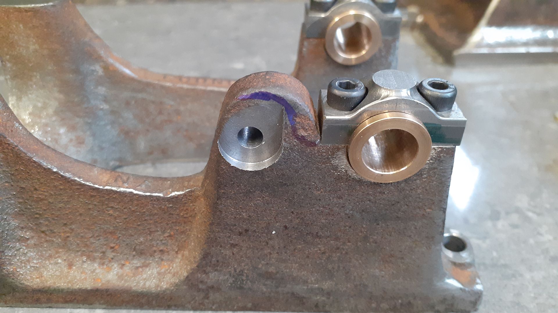

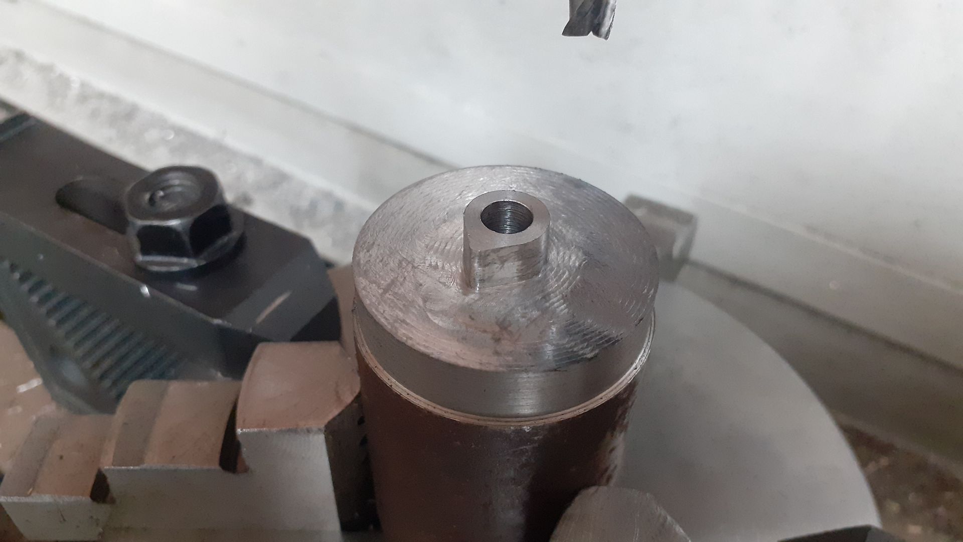

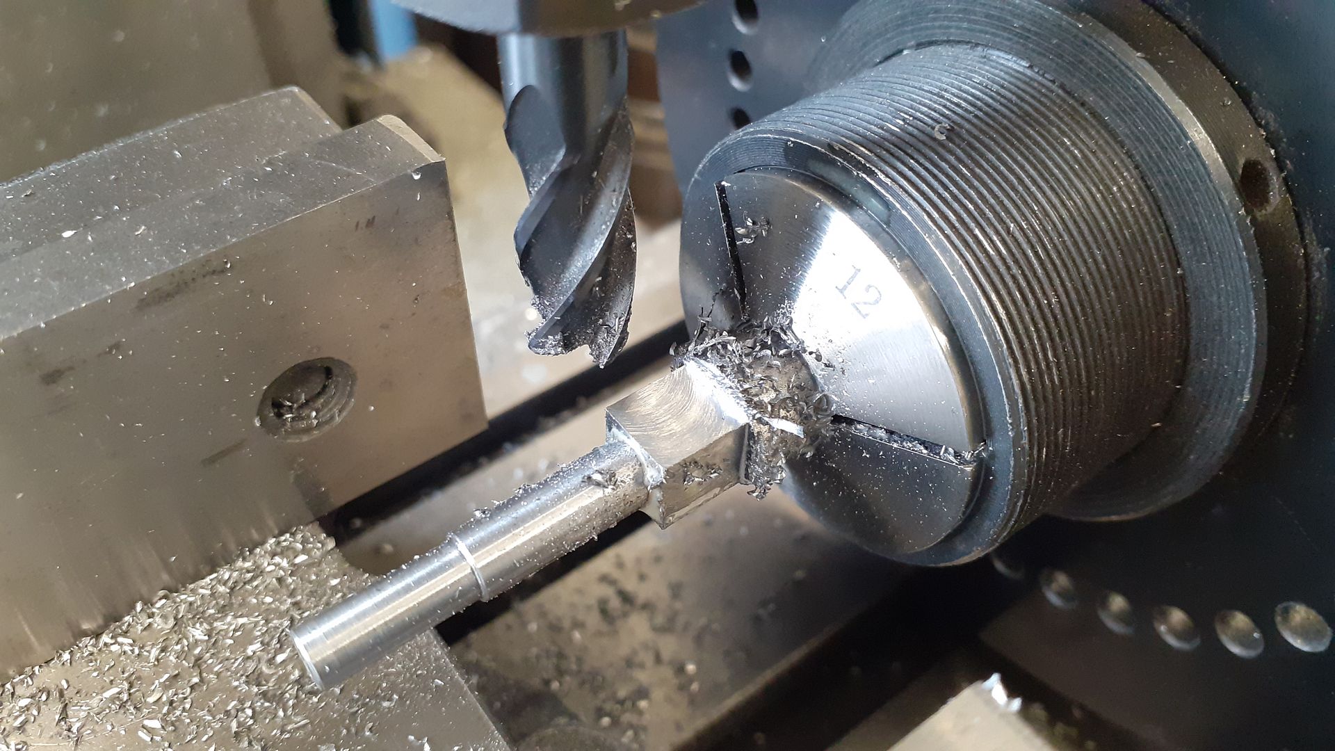

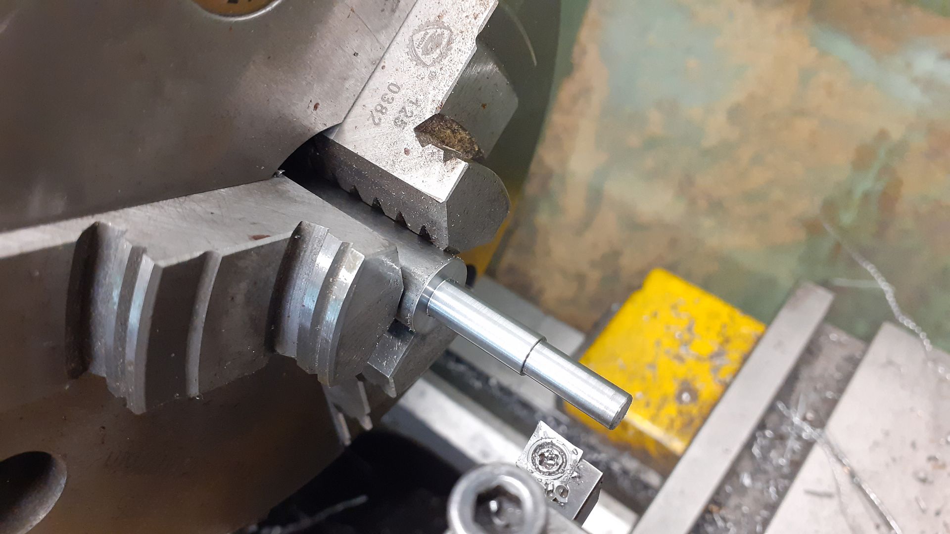

With a view to getting the gearing done I made the cam gear post first. Starting with some stock that wa slarge enough to get the rectangular head out of I turned two diameters, the larger for the gear to run on and the smaller to go into the hole in the engine frame.

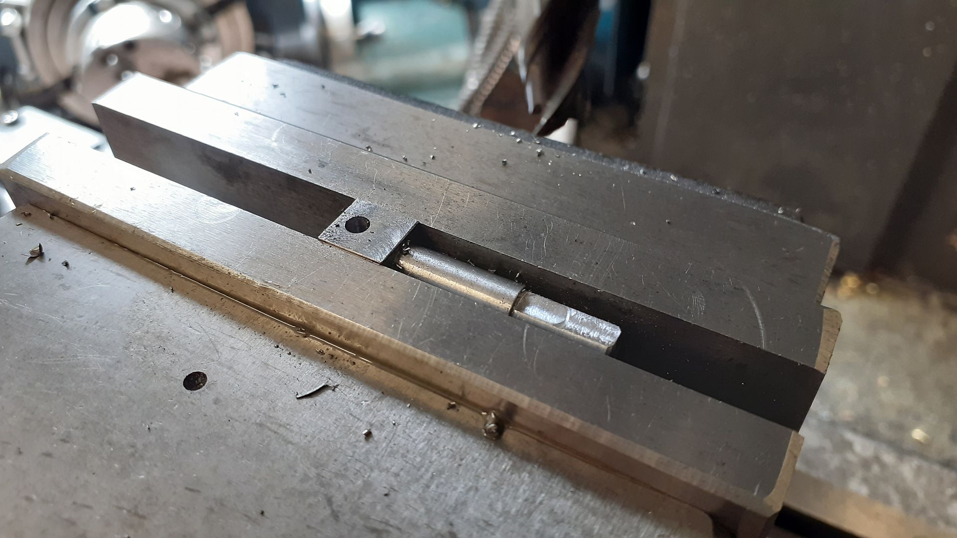

Then into the spin indexer to shape the clevis.
After reaming the pivot pin hole and milling a flat on the spigot the clevis was slotted for the latch and then rounded over

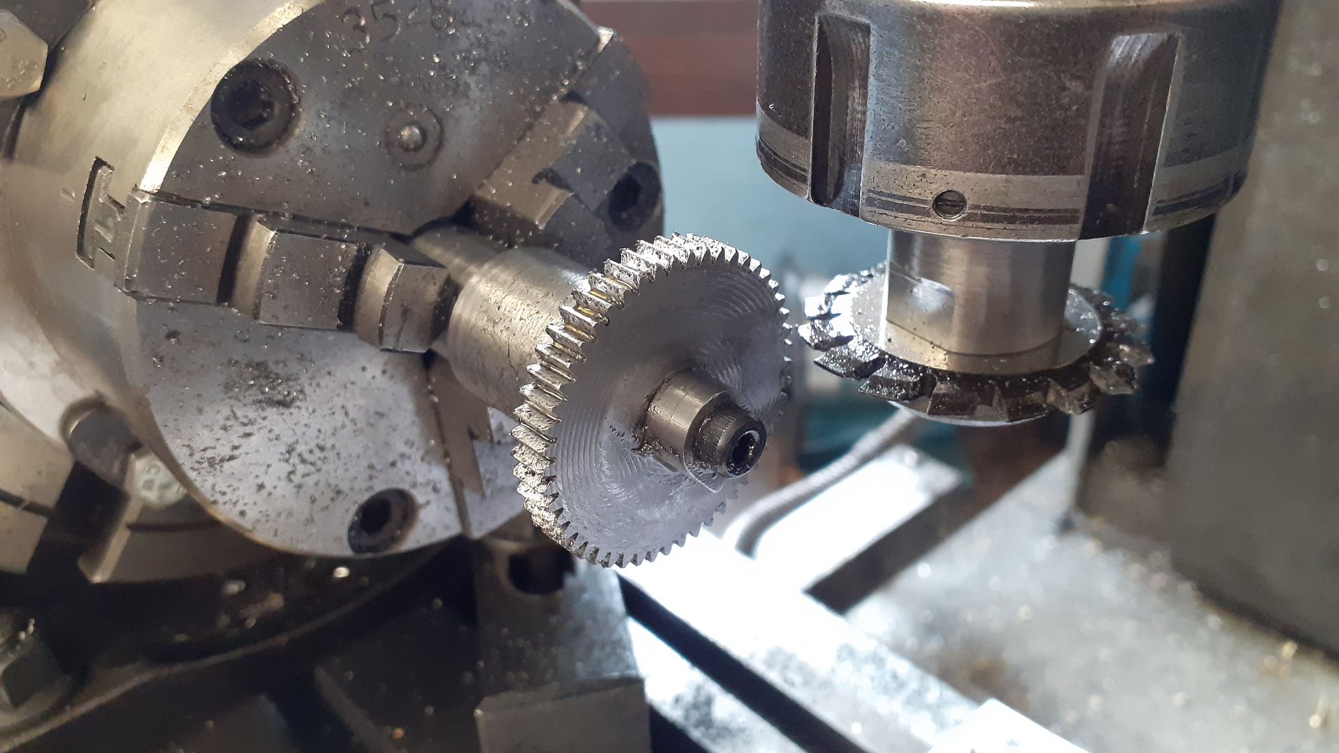

I spent some time working out different combinations of metric gear size and numbers of teeth and in the end settled on a 50/25T combination using MOD0.7 which are available online for those that want to buy or cutters can be bought quite cheaply.
I started by roughing out a blank for the cam gear and then machined the cam profile which I made with a little less lift to suit the lever lengths of the newer head layout that has the exhaust valve further from the rocker arm pivot

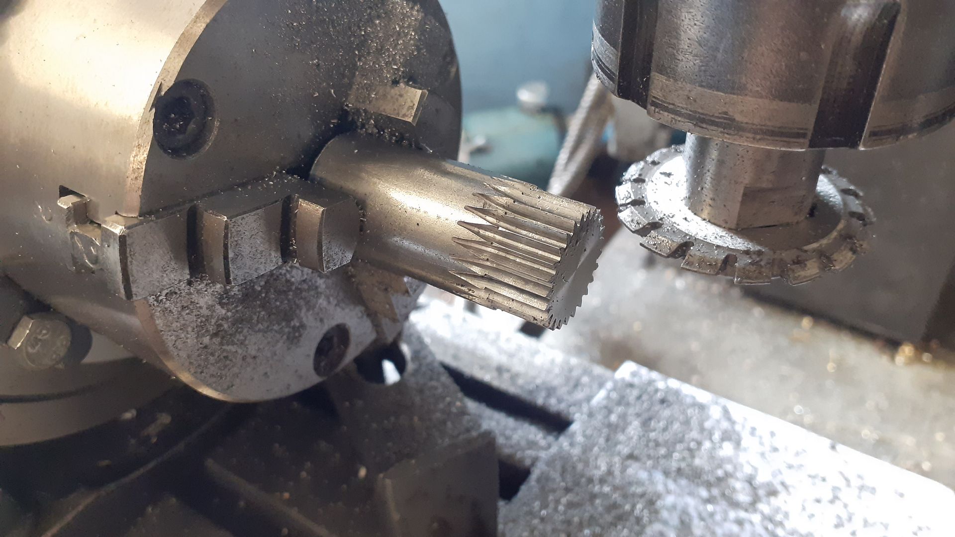

Then with the gear blank mounted on an arbor set about cutting the teeth using the rotary table with dividing plates
The 25T crankshaft gear was cut in a similar way except I did it on the end of a bar before reaming and parting off once the teeth were done.

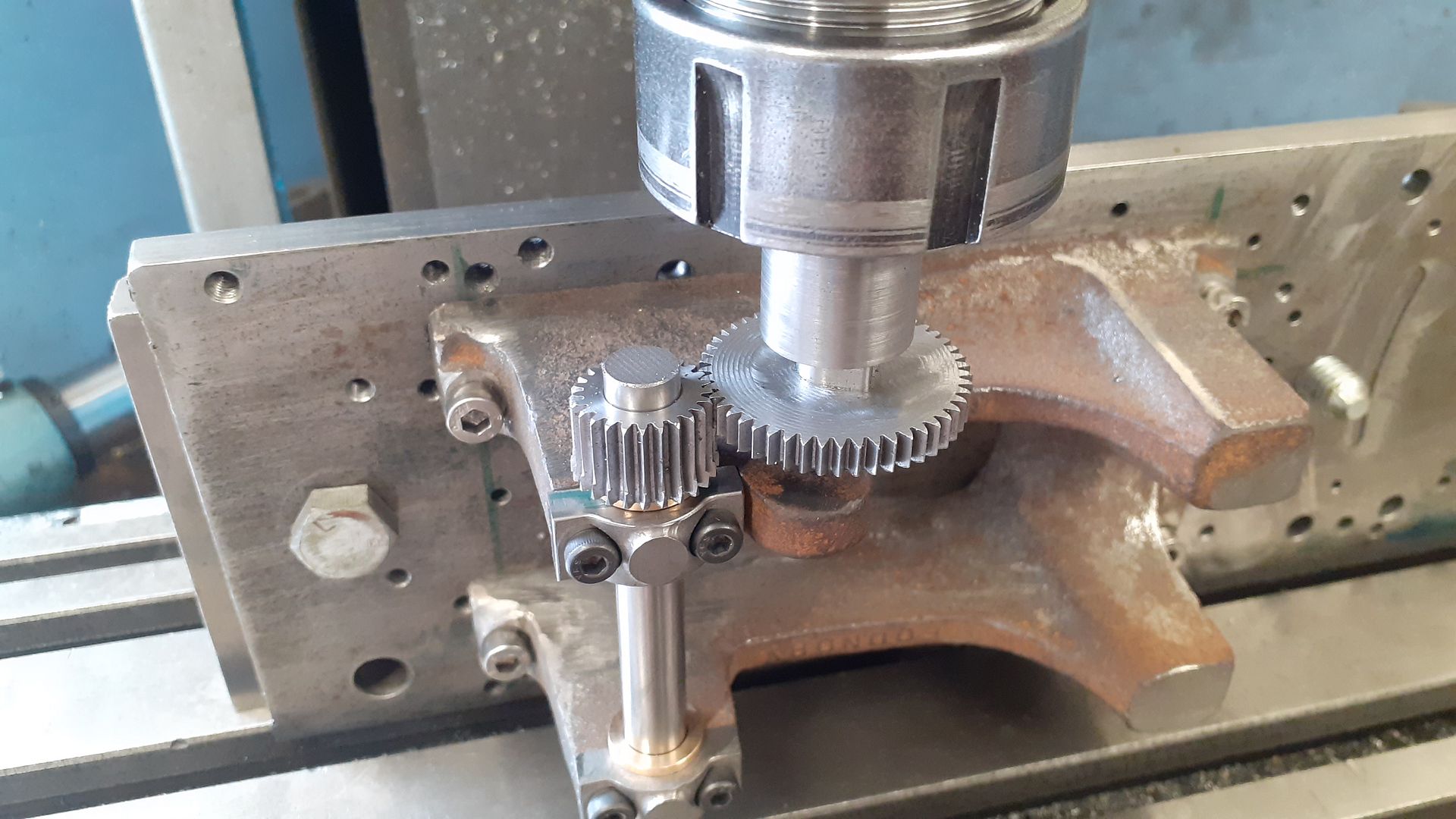

I like to set the gear positions using the actual gears so with a temporary crank shaft in place the small gear was slipped onto that and the larger gear on an arbor held in the mill's collet chuck and the running fit and backlash adjusted by moving the engine's frame in the X axis. Once happy the DRO was zeroed.
After which a flat was milled and a hole drilled and reamed
The MOD0.7 25/50 combination has a slightly larger PCD than the original design's 1" which put the hole a bit out of ctr to the cast lug.
A bit of milling and filing soon had that sorted out and a hole drilled and tapped for the screw that retains the cam gear post.
