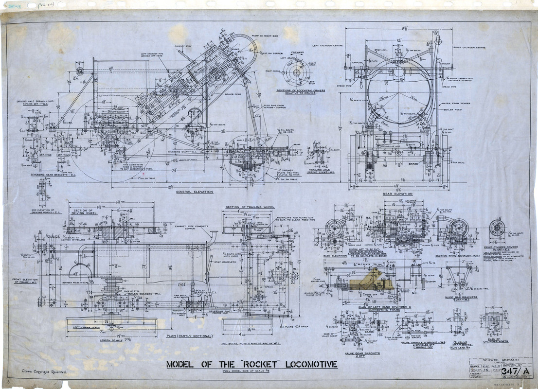

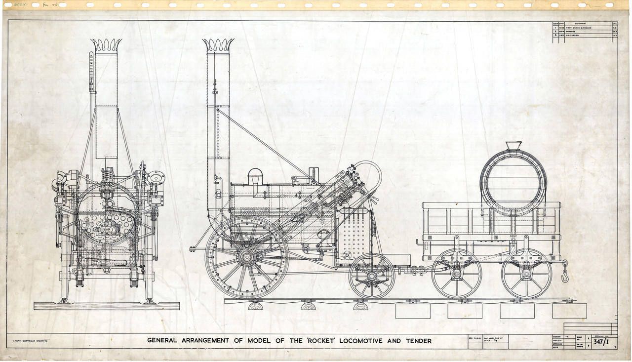

Just starting my new build. This time of Stephenson’s Rocket. The best plans I have found are from Julius delete Waal. In order to fit it in my lathe I am building it at half the scale of his drawings, which is a bit of a pain. Interestingly he says it is designed to be made in wood! That sounds a bit of a challenge. The main problem though is that he has completely ignored all the valve gear, which to me seems a really interesting part of the engine. One of the reasons for starting this thread is the fact that whenever I am stuck I can rely on some members to give me good advice and suggestions. So this will not be a detailed build log, but I will report my progress at any interesting stages. Here is the assembly drawing and my start on the chassis (not very interesting)

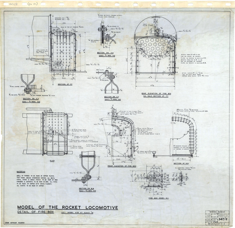

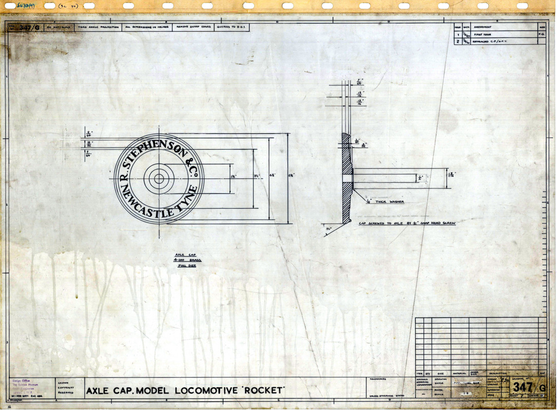

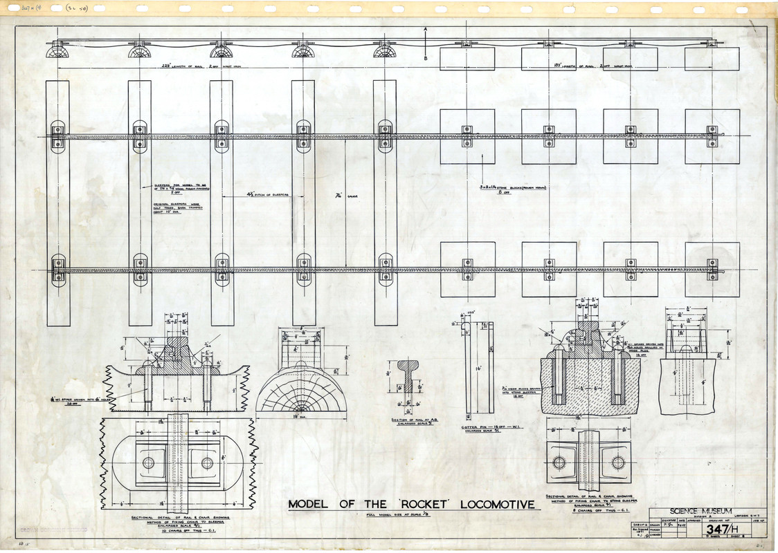

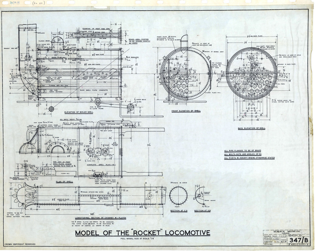

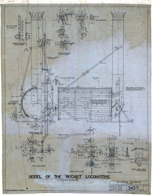

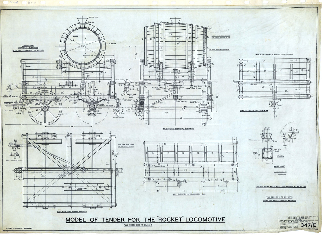

A few years ago I had downloaded them and stitched them together - here they are:

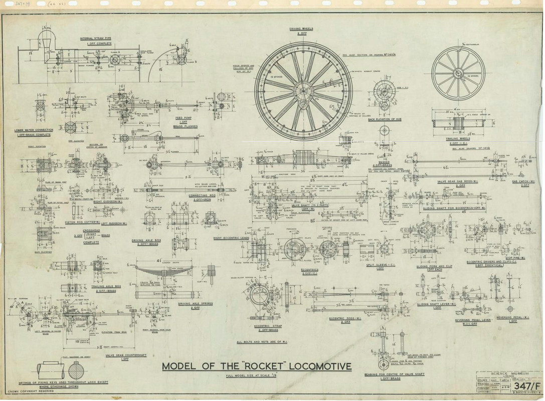

You're missing one of the drawings though.  I think there were 9 unique drawings, A through I.  You seemed to have accidentally skipped "F"?
  • Posts: 20871
Re: Stephenson’s Rocket
« Reply #13 on: March 09, 2023, 01:50:18 PM »
You are right Kim, missed one. I was not able to get this one at quite as high a resolution for some reason, maybe they didnt scan it as high.

Thanks chaps for all your interest and comments. I already have the Bailey and Clithero book as well as the Haynes Manual (although I suspect the description as an "Owners" manual is a bit tongue in cheek).
I am trawling through the Science Museum docs slowly, and as it has been pointed out there is a wealth of information there. I am also in touch with the NRM to see if it is possible to get the Bailey and Clithero drawings. They seem to give a very good clarity, whereas the old assembly drawings are very difficult to read (to me).
