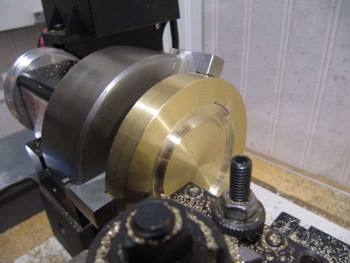

Done with the really boring bit of turning eight wheel blanks down to thickness, and on to some shaping. Started turning in the recess on the outside face. The depth of the recess requires changing back and forth between center, left, right turning tools. The inside face gets a similar but narrower recess. Aside from being round, its not looking an awful lot like a wheel yet...

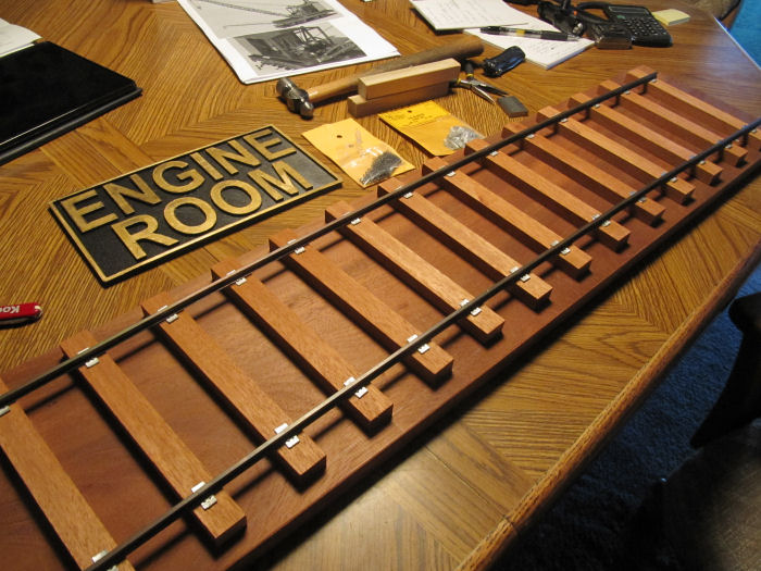

So far half the wheels have that first recess turned in to them (then lunch out with friends took priority, plus a trip to the local apple place for some fresh cider and donuts - yum!)   Then the track tie plates that I ordered arrived in the mail, so I got the other rail attached to the display base. Some wood blocks were cut to use as spacers between the rails, which have a slight curve for looks.
The 'Engine Room' sign that I printed the other day is visible in the background - the letters and adge were picked out in some gold paint. That will go over the door to the new room where this and other models will live (assuming the shop elves don't beat me to it and install their roller coaster and pub(s).   :Lol:

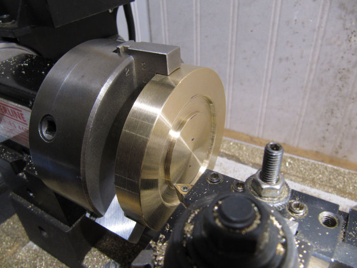

The recesses on the front have been finished up, and did the ones on the back side of each wheel next. Slightly different size and placement than the ones on the front.

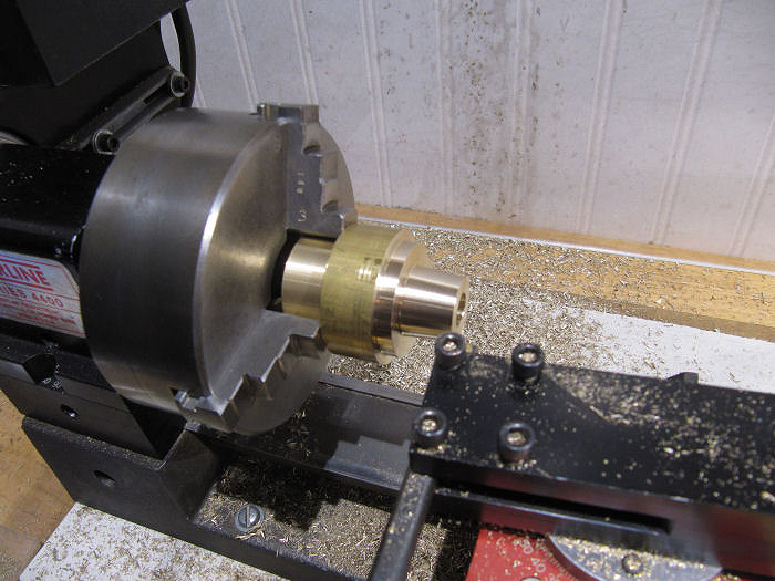

Then switched back to the taper locks. I want them all made so I can use them to check the openings when turning in the tapered openings in the wheels. So, chucked up the first of the blanks for the taper locks, set the compound slide to 5 degrees, and took the outside down till the narrow end was the diameter I wanted - a bit larger than the 5/8" axle rod they will fit on, but still a relatively thin shell so they can flex to grip down on the axle when tightened into the holes in the wheel. In this picture, a starter hole has been drilled in the block, but not yet bored out to fit the axle stock. I want to do both operations in one chucking so that the axle hole and the taper are concentric. After the taper/boring is done, I'll move the chuck over to the rotary table on the mill to drill the screw holes in the flange, then will part off the lock from the longer bar. The bar is long enough that I can get one pair of locks out of it. Eight needed total.
