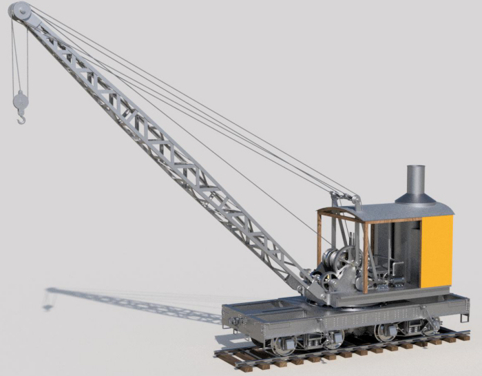

as well as a fold out blueprint in the back giving profile/plan/arrangement views. An amazing resource. Naturally, it got me planning and plotting for a model of one. Most of the drawings in the catalog are for the 20 ton version, so that is what I'm going to build.

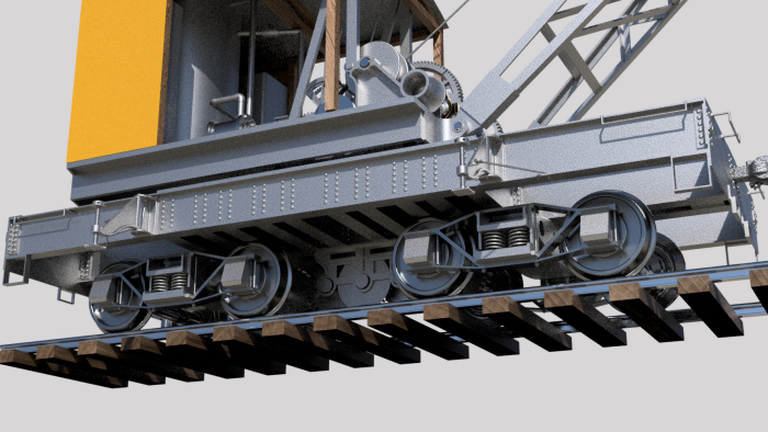

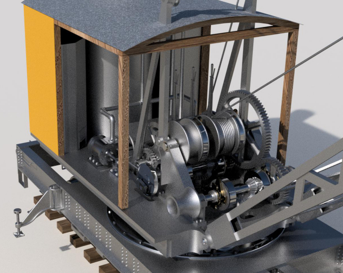

About 3 weeks ago I started the CAD drawing of the machine, at full scale, of the 20 ton crane. Here are a couple renders of the CAD model:
When the CAD model at full size was complete, I took some key measurements from it (wheel size, piston size, gears, frames, etc) and put them in a spreadsheet to play around with different scale factors to decide what size to make the model. I wanted it large enough to have the power to lift heavy things (like a weeks supply of beer for the shop elves), but small enough so the parts would be practical on my small Sherline lathe/mill plus the fasteners would not be too tiny - I like most to be in the 2-56 to 4-40 range. What I settled on was 1:11 scale, which is an oddball scale but so what? I may not make the boiler functional, since I rarely steam up any of the ones I've made on other models, normally just running them on compressed air inside the house and the occasional show.

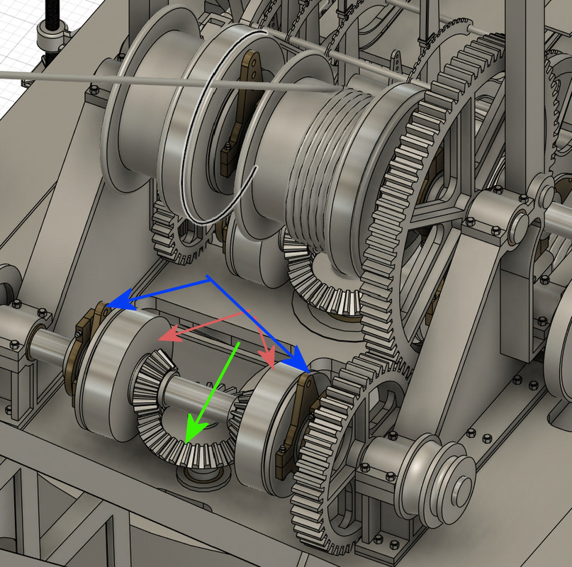

This crane has some challenging features that took some time to work out. One is the system of clutches that operate everything. On all but the 30 ton version of the crane, they used just one 10"x10" two cylinder engine to power everything, and that engine only runs in one direction, no reverse gear on it. All the other shafts are driven by a set of gears from the crankshaft, and cone clutches activate each function. The catalog describes how the cone clutches had bronze cones, which give some slippage when engaging, but they say this was intentional to eliminate hard shocks as clutches engaged under heavy loads. The lifting drums (one for the main hoist, second for use with the second line on a clamshell bucket or dragline), each have a single clutch, so the engine has to run in the direction that turns the drums in the proper direction for hoisting. Lowering was done with brake bands on the drums. The other shafts, for slewing the crane, driving the wheels, and tilting the boom, all have pairs of clutches around a set of bevel gears, as shown in the next picture:
The clutches are pointed at by the red arrows. The cups are directly attached to the smaller bevel gears, while the cones inside are keyed to the shaft and can slide back and forth. There are cam pairs fixed to arms, blue arrows, to engage/disengage the clutches. The cups and small bevel gears can freewheel on the shaft when the clutch is disengaged. With the shaft always spinning in one direction, the drive on the large bevel gear (green arrow) only happens when one clutch is engaged. Since the small bevel gears are on opposite sides of the large gear, if one clutch is engaged, the vertical shaft will be driven in one direction, and when the other clutch is engaged, it will spin in the opposite direction. When neither clutch is engaged, the vertical shaft is not driven at all. The levers and cams are connected to a single lever, so pulling the lever back engages one clutch, pushing the lever forward engages the other, and leaving it in the middle disengages both. Quite clever, and makes one lever control everything for that function.
There is one shaft and set of clutches for slewing the crane turntable, one for tilting the boom, and one for driving the wheels to move the entire machine on the rails. The hoist drum shaft has one clutch for each drum. All that means making eight clutches.
The other big challenge is the large ring gear that sits on top of the carbody frame holding the wheels. It is a little over 8" in diameter, and has internal teeth so I can't use my normal gear cutting setup for it, since the mill headstock/motor wont fit inside the gear. That means exploring a number of other alternatives:
  • Buying the internal tooth ring gear
  • Changing the design to use a slightly smaller external tooth ring gear
  • Making the ring gear in a number of sections (8 or 10 probably) that fit together and bolt down to form the ring
  • 3D printing the ring gear in something like PETG
  • Having the gear 3D printed in metal by an external service
  • Making an internal gear cutter holder, seen someone else did that on another thread here
Each option has its issues. Buying one would be quite expensive, assuming I could find one the proper size and tooth count. Using a smaller external gear would be the simplest but not true to the original, though with the turntable in place it wont be visible, but my shop elves would blab it around so everyone would know. Making the gear in sections is possible, though getting them all to fit up just right would be a tricky thing. Printing the gear myself in plastic would be possible, though I'm not confident that it would hold up to the load of such a heavy model. I could have it printed in metal, like I did with the excavator bucket a few months ago, but taking measurements of that and comparing to the CAD model show that while large dimensions are within a few thou, smaller wall thicknesses are out by 15 to 25 thou, making me wonder how well it would function. Making an internal gear cutter rig would be pretty cool, though working out how to hold it on my machine is tricky, plus the gear blank would need a wide standoff to hold it and give the cutter clearance. I did some searching on the forum, but have not found that thread yet - anyone remember where it is?
So, the slewing ring gear needs to be worked out. The clutches I think I have a good handle on. There will be lots of spur and bevel gears to cut. The main boom will be an interesting task too, getting a LOT of angle stock milled or soldered up and riveted together - the boom is over thre feet long at this size. Also, will need to make a LOT of I beam stock for all the long lengthwise and short cross beams in the carbody. Should be able to make them the same way I did on the Marion steam shovel build, with a series of small jigs to hold the webs together for soldering.  Lots of challenges, but thats the fun part!

After a suggestion from Jeff, I looked into EDM and CNC services online. Prices vary all over, but I've found places that will machine the internal ring gear set (ring gear plus the matching spur gear) for under $100, out of aluminum or steel, which is a lot less than I had expected. Not bad for a 9 inch internal gear! Way to big to do on my machines in one piece.

There is also the shaping/slotting option for the gears. Mount the blank ring off to one side of the mill's spindle on your rotary table. Then use the mills quill to raise and lower a single point bit. If you use brass or aluminium it won't be too hard and I don't imagine that the teeth are too big.
That would work too! Though for 128 teeth, my arm hurts just thinking about it (the Sherline uses a horizontal top handwheel rather than a side quill lever!)   :paranoia:
I have gone ahead and ordered the internal gear, CNC machined with the outer ramp for the turntable rollers also in place. Its a little over 9" in diameter overall, will be mild steel. The spur gear to engage it I can machine myself.

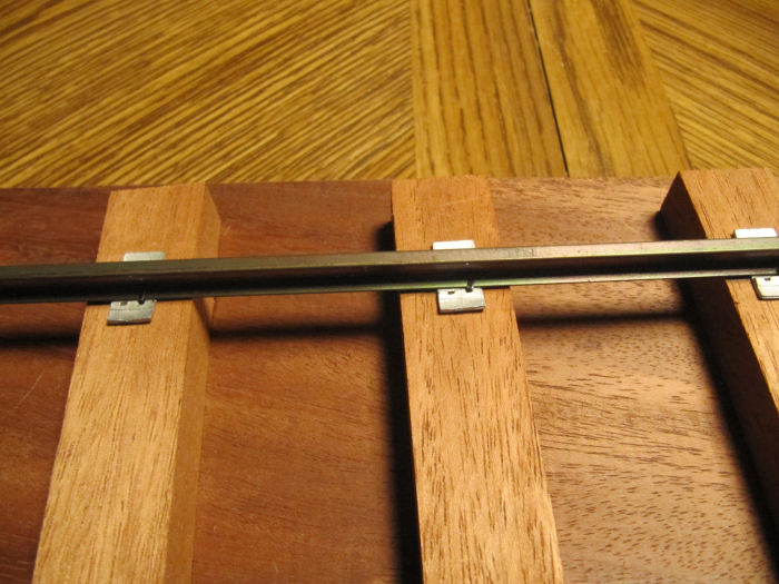

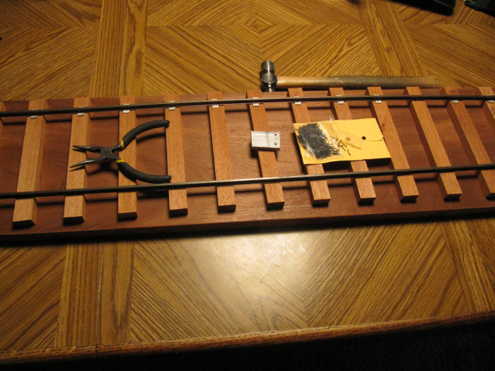

Yesterday I got the wood (synthetic aluminum for the metal oriented among you) ties and base board cut and glued together. The ties are arranged in a shallow arc to simulate a section of a curve, just to keep it looking a little more interesting. The rails will be arced to match. So far one rail has been spiked into place. The other will have to wait a bit, I ran out of the little tie plates and had to order another package of them. The spikes are shaped like the real thing, so the top end grabs the rail and holds it in place. I had the tie plates and spikes left over from making the display trestle for the Shay years ago - they are off the shelf items from the model railroad market.
Closer view of the tie plates. The spikes are being installed by pressing them most of the way in with needle nose pliers, then tapped in the rest of the way with a hammer and a steel block.
Since I need to wait for more tie plates, I'll go ahead to cutting the blanks for the wheels. That will likely be tomorrow, today we are meeting out at the pond with the RC submarines since the weather is so good today...
