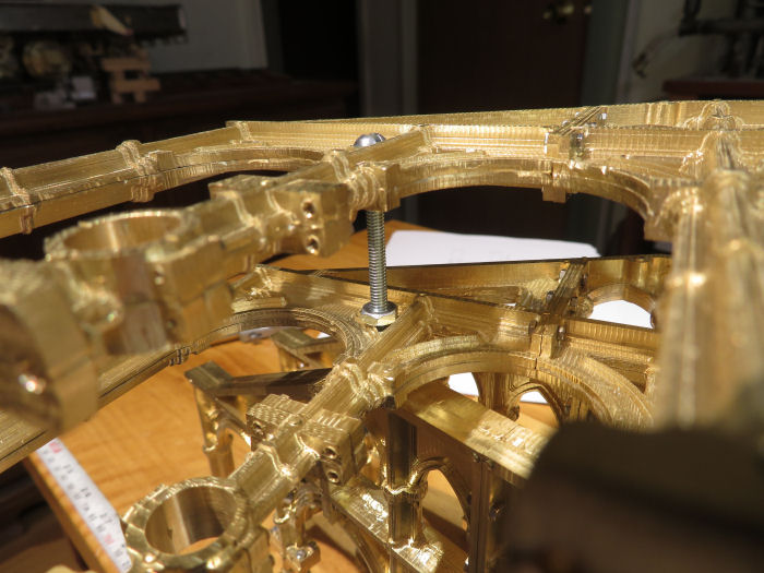

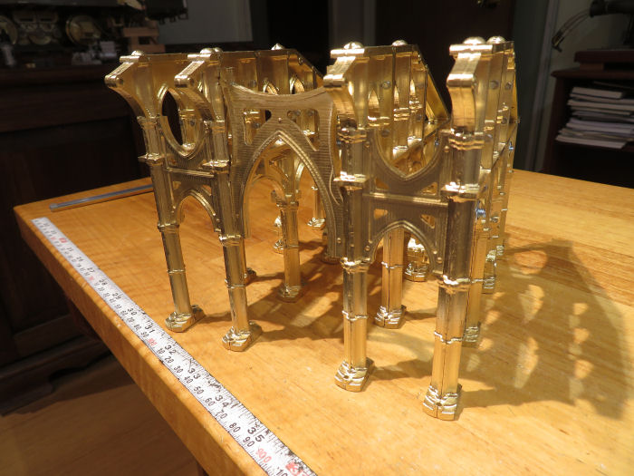

The side frame panels were all notched/drilled/tapped for screws to hold them to the rear cross panels. To hold them in place, I used a couple of long bolts with nuts inside/outside of each panel, to hold them parallel to each other while drilling:

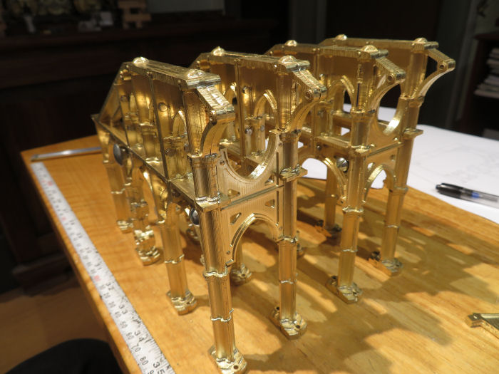

And a picture after drilling/tapping and assembling the cross panels on the two frame sets:
I still need to make the cross rods to hold the two frame sets together, which will lock in the one wider panel between the pairs at the back:
Looking pretty cool!  They will get a coat of dark green paint at some point...

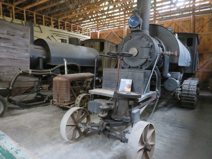

A few gas engined Lombard trucks
A pair of steam powered Lombards

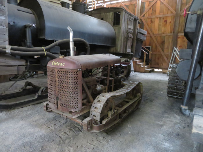

and a Cletrac tractor

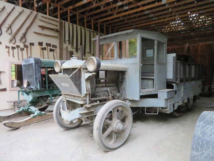

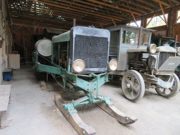

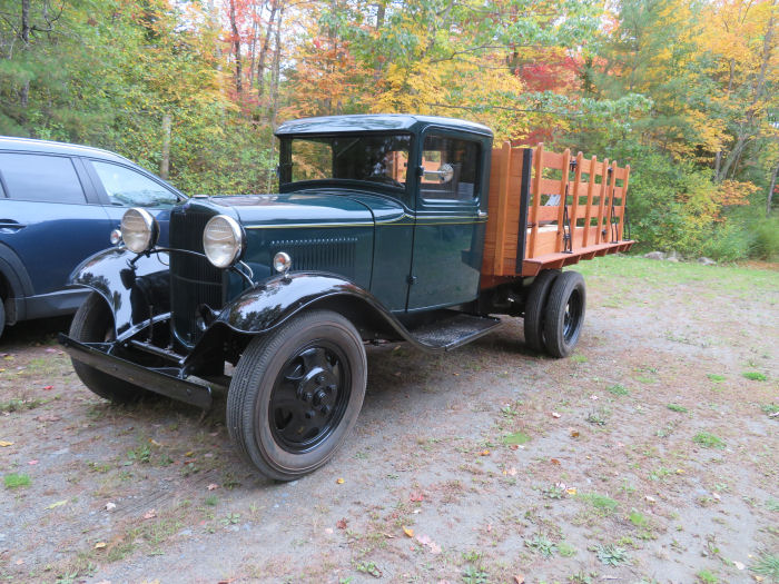

A Ford BB truck from 1930 (or was it 32?)

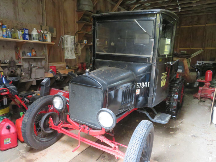

a Ford Model T on tracks (skis are off of it for the summer)

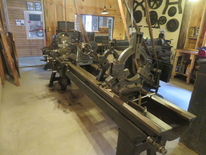

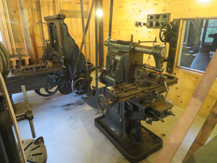

the line shaft machine shop

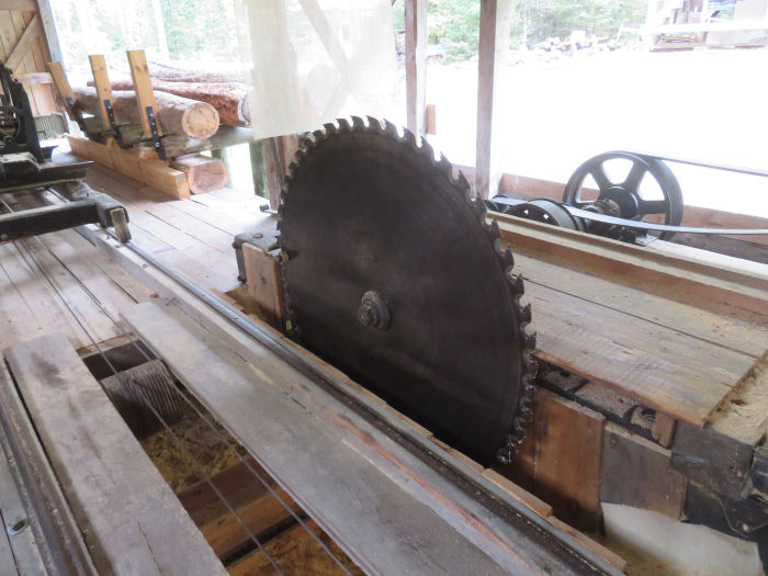

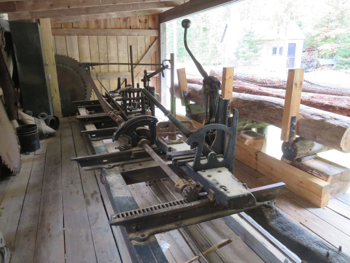

several sawmills and shingle mills

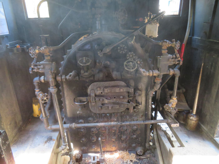

Nice morning light on the boiler backhead in the Lombard
