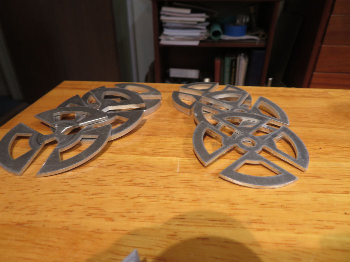

I printed some spiders a while back, in several thicknesses.  Only problem was they softened if the part got hot during turning.  Wound up having sets laser cut from different  thicknesses  of aluminum, works great.
Can you show me a picture? I'm interested.
  • Posts: 23750
Re: 3DP chuck spider backstop
« Reply #5 on: September 21, 2026, 10:24:30 pm »
Here's what I had laser cut. Each set has three thicknesses, so I can stack them to get different offsets. Got a couple of each type for the 3 jaw and the 4 jaw. The ones with the holes in the middle are handy when through drilling thin parts, at least up to that size hole. The holes/surrounds limit how small a part can be gripped. The other type has a narrow junction in the middle, good for holding smaller diameters not being throguh drilled. I also got a larger set for the big chuck, same styles just larger diameter and thicker since the jaws on that chuck are deeper. Its handy to have thicknesses that are not even multiples of each other, gives more combinations when stacking. All depends what your total jaw hieght is and whether you are using inch or metric stock. I looked around online to find a cheap place to get them cut, prices vary a lot. The slots for the jaws are a little wider than the jaws so they don't bind. Oh, and I got extra sets after playing around with cart quantities when ordering - sometimes there is a minimum amount for setup, so getting three sets might cost about the same as two, etc.
