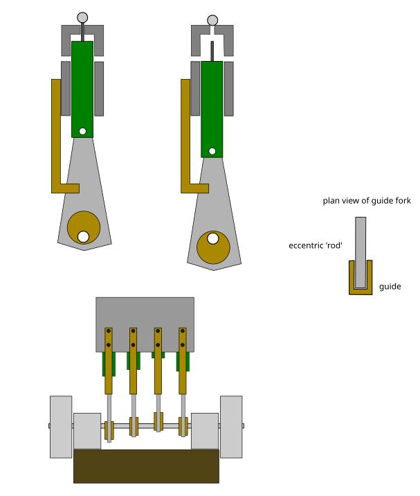

Another bonkers plan is emerging... a uniflow engine with four cylinders!
I'm thinking of using a single piece of brass for the cylinder block with some sort of inlet manifold on top. For simplicity, and to enable me to make all the parts in groups (and ensure they're identical):
... the eccentric 'rods' will just be shaped sheet metal with holes at each end.
... the eccentrics will be made from a single piece sliced into four, fixed with grub screws
... a forked guide might be needed for each eccentric 'rod' to stop them wandering left/right - maybe attached to the cylinder block (as shown here) or the standards or somewhere else  :Lol:
... the shaft and the standards will need to be chunky as there's no central support
Here's the basic concept (ignore the random proportions!), based on the previous experiments it'll probably be extremely noisy...
Hope to make a start on this some time next week.

I've never seen  eccentrics  used instead of crank pins on a piston. Offset can be the same, but it seems like the force transferred would be maybe half? Has anyone else  tried it?   :thinking:
  • Posts: 1434
Re: Four Cylinder Uniflow
« Reply #3 on: June 26, 2026, 07:46:33 am »
I hadn't even considered that but now I see that the force isn't being applied to 'one point', the pin, it must be weaker I guess although the energy has to go somewhere. I wouldn't know where to begin trying to calculate it though - the last time I did any mechanical engineering calculations was in 1975 (and I struggled then!).

Think about the friction.
  • Posts: 1434
« Reply #5 on: June 26, 2026, 08:46:44 am »
Just worked out the contact area between the eccentric and a 'rod' made from sheet and compared it to a big end on a crankpin. Plucked figures out of the air that are typical for the sort of sizes I use. Bizarrely the results are the same but in practice I think the eccentric would be larger and therefore create more friction.
Eccentric 12mm dia:perimeter 2*pi*r = 37.68
Contact area of 1.5mm thick sheet metal 'rod/strap': = 1.5 x 37.68 = 56.52 mm2
3mm pin perimeter: 6.28 x 1.5 = 9.42
Contact area of boss: 9.42 x 6 = 56.52 mm2

The guides would also add friction but, as far as I can see, there's no need for the rod/strap to surround the eccentric - it could be an open 'fork', reducing contact area by 50%. I suppose it's the same as a cam set up?
  • Posts: 23384
« Reply #7 on: June 26, 2026, 01:46:42 pm »
I would worry less about the friction and more about the lever arm. At mid stroke, the force would be centered halfway out the cam, rather than out where the crank pin would have been. Much less torque  transfer.
  • Posts: 1434
Thanks Chris but I can't quite get my head round that :headscratch:, can you clarify a bit please?
  • Posts: 1434
« Reply #10 on: June 26, 2026, 02:04:57 pm »
Ignore that, I've just worked out what you mean.... thinking more.
  • Posts: 1434
« Reply #11 on: June 26, 2026, 02:09:05 pm »
I think you mean as per the red arrow rather than the green?
  • Posts: 23384
« Reply #12 on: June 26, 2026, 02:49:33 pm »
Exactly.

Hmm, wonder if it would still run but just be a bit weedy....?
  • Posts: 23384
« Reply #14 on: June 26, 2026, 04:33:25 pm »
One sure way to find out...  It could be an interesting experiment to try it with the eccentrics and then swap parts to a normal style crankshaft. Or, mock it up with one eccentric and one crank, and just move it by hand to feel the difference?

Might be better to scratch the guide fork idea which might be tricky to line up properly and make the eccentric a bit more traditional with a sheave or even just a little tab to  keep the rod on track. Just making the smaller diameter (spigot part) longer might work just as well though.
I think a two cylinder version is definitely the best place to start. Updating the thread title!
Oh, good grief. For the same stroke S, the lever arm is exactly the same S/2, whatever the diameter of the crankpin.
But compare the moment arm about the crankshaft at which the frictional resistance acts between pin an big end with the moment arm in the case of the eccentric and bigger end.
« Last Edit: June 26, 2026, 08:49:37 pm by Charles Lamont »
  • Posts: 23384
« Reply #23 on: June 26, 2026, 08:59:12 pm »
Wrong, Charlie Brown (good grief pun). The lever arm is at the middle of the crankpin. With the pin size in the normal crankshaft design range, its a very small difference. But, for the way this one is drawn, its a huge difference. Look at the picture in reply 12 again!
You missed the part about the same stroke. (Of course the proposal that started this tangent did not have the same stroke for the two styles.)
Gene
  • Posts: 23384
« Reply #25 on: June 26, 2026, 10:14:59 pm »
Gene
I did not miss that at all. Don't confuse stroke distance with lever length at midstroke. Build a simple mockup of both crankshaft and eccentric with equal throws, push on the conrod, and see how much torque you feel on the crankshaft. It will NOT be the same.
Online Charles Lamont
  • Posts: 649
Re: Two Cylinder Uniflow
« Reply #26 on: June 26, 2026, 10:38:45 pm »
Gene, I have read the whole thread again, and I have still missed anything about two styles, let alone with different strokes.
Chris, here is a diagram. The lever length for the same stroke is the same in both cases. It is the throw of the crank or eccentric. You are right that it will not work the same, but that is because of the radius at which the friction acts. Hint: imagine with a plain bearing and then with a needle roller.
« Last Edit: June 26, 2026, 10:49:34 pm by Charles Lamont »
  • Posts: 23384
« Reply #27 on: June 26, 2026, 10:47:10 pm »
Chris, here is a diagram. The lever length for the same stroke is the same in both cases. You are right that it will not work the same, but that is because of the radius at which the friction acts. Hint: imagine with a plain bearing and then with a needle roller.
Okay, I  like that diagram better and agree. The one in reply 12 had me thinking the crank center was in a different place.   And by two styles, I  read that as pin vs cam style?
