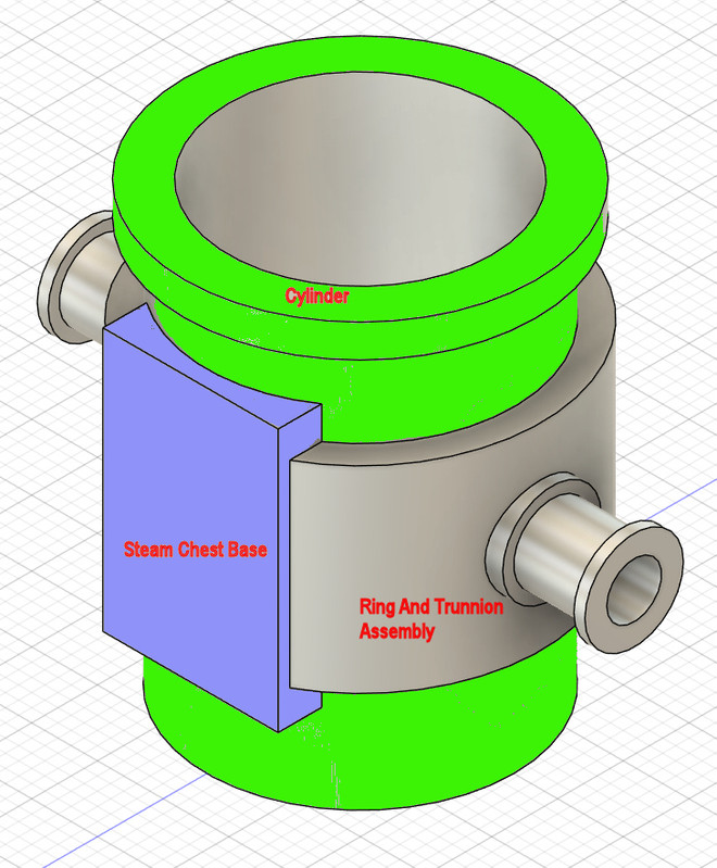

Ah!  I'm seeing it now!  The cylinders will fit inside the rings with the trunions.  I was thinking that the rings WERE the cylinders and it seemed like really big pistions with a very short travel! Now it's becomming more clear to me.  Nothing slow about me, eh?   :Lol:
Looking good, Chris!  :ThumbsUp: :popcorn: :popcorn:
  • Posts: 23534
« Reply #47 on: May 23, 2026, 07:28:44 pm »
Yes!  You've got it correct!  You need to stop going out drinking with your shop elves...  You'll start seeing dancing pink elephants next...  :pinkelephant:

I should have posted the diagram of how they come together - sorry!  Here is a picture showing the parts I am making - the ring in gray, cylinder in green, and steam chest base in blue:

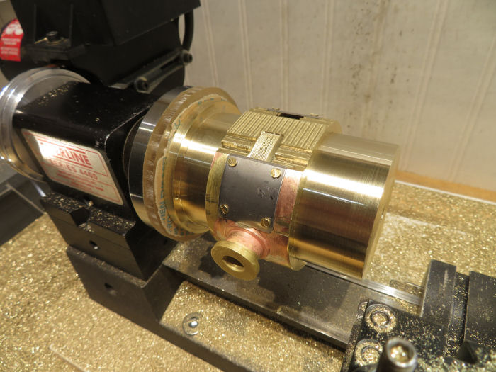

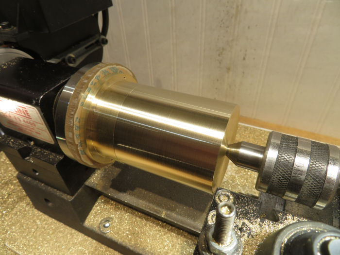

This morning I started turning down the outside of the cylinders. An inch or so in from the left end in the picture you can see a small step - that is the stop for the trunnion ring assembly. To the right of that it is turned down to be a close sliding fit inside the trunnion ring.

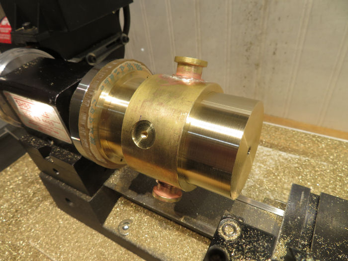

Test fit of the ring:
and rotated around to show the recess/hole for the counterbalance that will hang off the back of the cylinder, to balance the steam chest weight:
I have the one cylinder turned down, and the second one partway along. The motor on the lathe was getting a bit warm so I took a break - turning these large diameters at a slower speed puts a bigger load on it than normal, and its easier to take a break than to swap the belt to the other pulley so the motor can turn at a higher speed. I'll finish up the second one after lunch.
Next time I'll be able to start boring out the center of the cylinders. In the meantime, as the shop elves are off at the Indy 500 races this weekeng, the apprenticelf is doing the cleanup of the swarf. I'm SURE that he'll share them all with the other elves... yeah, right...   :Lol:

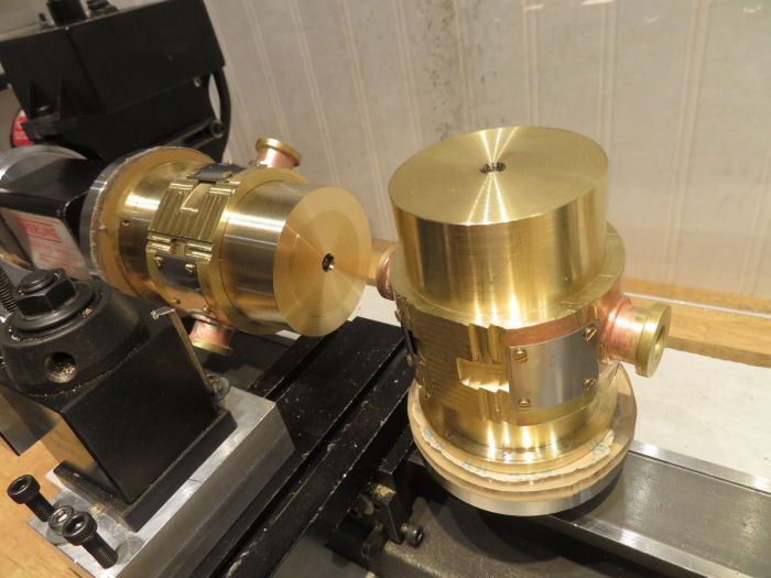

After lunch I  got the second cylinder  turned down and its ring fitted like the first one. I will need to be careful when fixing the rings in place to ensure they are facing the correct direction, since the steam passages need to face to the outer ends of the engine, exhaust passages towards  the center. I've  put the steady rest back on the lathe and adjusted the arms to the ends of the cylinder, will start boring tomorrow.  The temperature is  comfortable  outside, heading out to enjoy it.

Later this afternoon the clouds moved in and it got cool out, so I came back inside and wandered back to the shop again and finished up the second cylinder, to fit its trunnion ring:

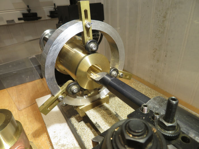

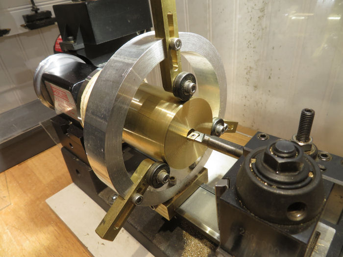

The rings are not attached yet, so I took one off and set it up with the steady rest, and drilled a starter hole through the length of it and started with the largest boring bar that would fit that hole:

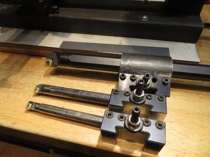

With that much overhang (the cylinders are 3.4" long) the bar chatters and rings a bit, so once the hole was large enough I moved up to the next size bar, and then the third one:

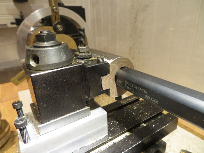

The third one needs a starter hole of about 0.9" ID, the largest one I have requires a 1.2" or 1.25" hole to start it - probably will switch to that one to finish the bores. This second-largest one is way too large to fit in the quick-change holders, so I had made an adapter for it back when I got those two bars (I think it was during the Ohio engine build? Or was it the Holley? Have to look that up).
That one has been started, need to take out a lot more to get to use the largest one (which is larger than most parts I turn on this lathe!)
For the largest one, I think I had to clamp a vise to the cross slide to hold it, need to look back through the build logs to see what I did.  :headscratch: Going to be a couple days to get the cylinders bored out all the way. This will be good practice for when/if I start on the engines for the Great Eastern - the paddlewheel engine for that will be another large diameter/long cylinder setup, and it has four cylinders. The propellor engine on that ship is also large bore, but much shorter length to the four cylinders. Those early ships used lower pressure boilers, so the bores were much larger than later engines.
At least the steady rest was well worth making - thats working out quite well.
