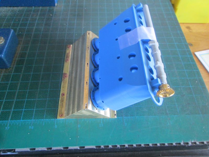

I often find that printing a part reveals a design fault or just an appearance flaw that I didn't catch in the drawing

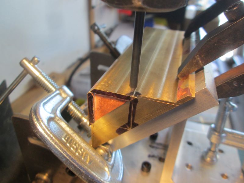

« Reply #51 on: October 16, 2024, 01:02:13 am »
With the crankcase set-up on the tilting table with plenty of clamps, today I got one face drillled/bored to accept a set of cylinders. I started with drill bits, going up to 5/16”, then switched to the boring head to get to a final diameter of 0.816”, checked with a go/no-go gauge I turned up for the purpose.
Since the base of the crankcase was previously machined precisely to width, I thought I should be able to flip it around, and with it clamped against the same stop, be able to drill the other side along the same locked in Y location as the first face.
Once set-up, I was pleased to see that my sanity check scribe marks from the crankshaft centerline do in fact line up with the desired Y location. Yay! I used the pointer shown with the mill running to scribe a light reference centerline along the length of the face. You can just see it in the photo. All set for tomorrow.

Hello Ron,
So now the crankcase machining starts. Do you get apprehensive, like me, before you make that first cut?. Mark out, measure once, measure twice and measure again just in case, before you even start the spindle.
Again I can see the advantage of the 3D printed model. You immediately have something to test against the work, to check the fit and see how it is eventually going to look.
Nice work    :ThumbsUp: :ThumbsUp:
Oh yes, definitely! It doesn't help that the internal bearing supports are invisible from this set-up, but crowd right up to the edges of the bores. But where I have learned I REALLY have to be careful is doing the second side. In repeating a successful operation, I sometimes feel like "OK, I've got this now" and then -  :hammerbash:
Hello Ron,
As I said elsewhere " you have to learn to trust yourself and trust your drawing" especially when dealing with hidden or invisible features. Your 3D CAD modeling skills will be a great asset to producing trustworthy drawings.
