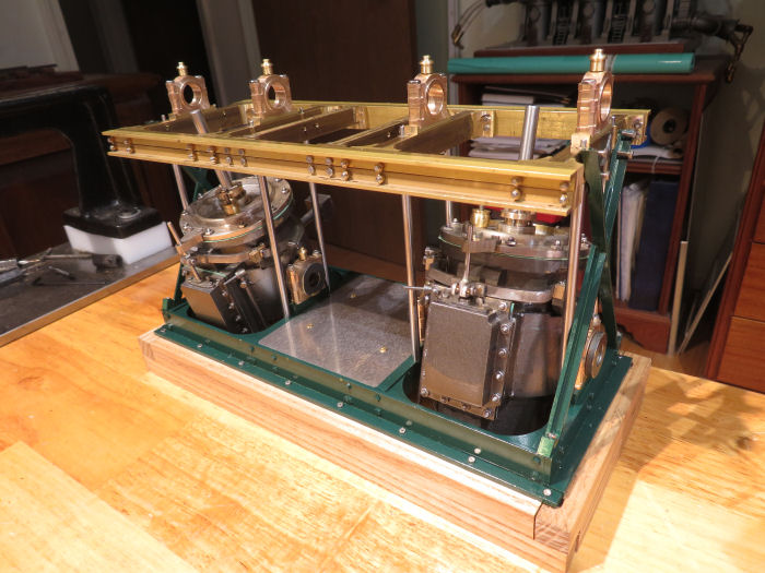

Yesterday I got some paint on the lower frame and the end X frames. This morning they were assembled onto the base with the vertical columns screwed in place and the top frame set over them. Quite a difference with the color on the frame! It changes the appearance of the cylinders too.

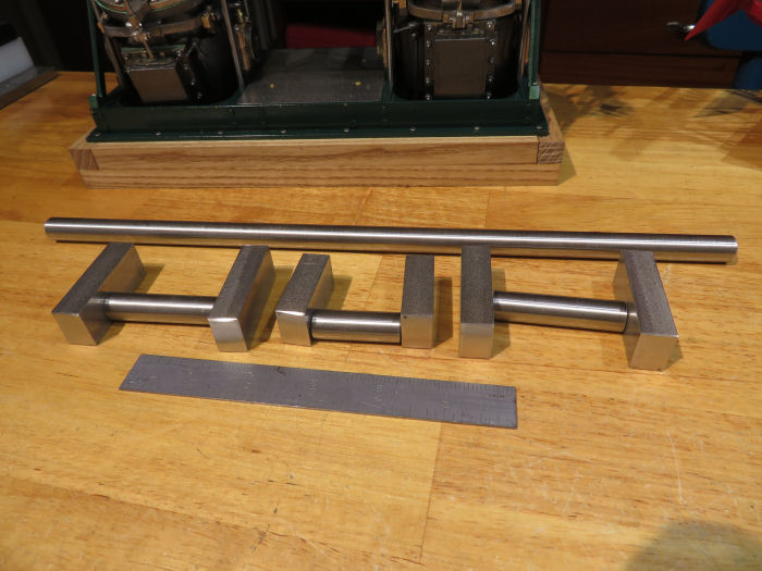

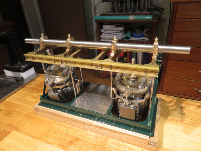

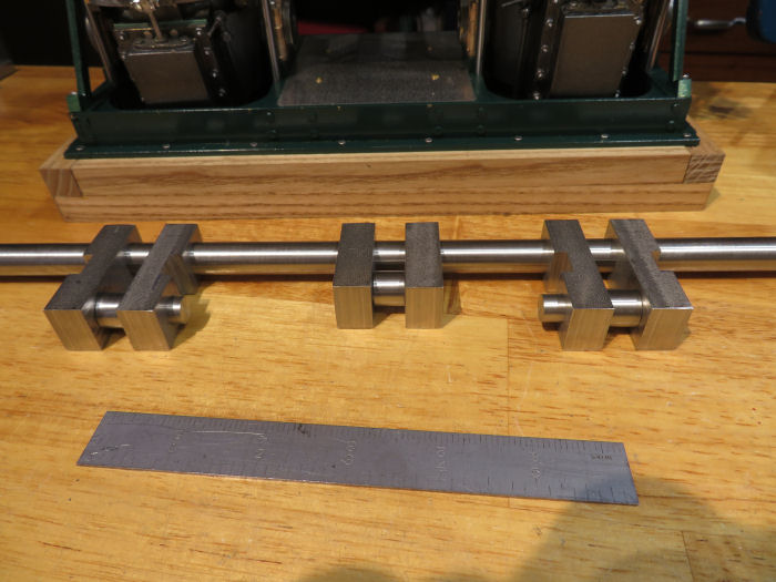

After some sitting and staring at it, and some thinking about next parts, I decided to go for the crankshaft. Got out a nice piece of 1/2" round stainless steel, and cut the blank for the main shaft, and test fit it in the bearings. As expected, slightly tight fit so it will need lapping in, but the bearings were left a hair under size in the bore to allow for lapping, which will adjust for any tiny misalignments in the parts.
Got the pieces for the webs and crank pins rough cut out as well. Here is the 'kit' of parts for the crankshaft:
I'm going for a built up crankshaft, with a 2-1/4" throw, it would have been a massive piece to carve out of one (really) big bar. The webs will be loctited and taper-pinned together, with the crank pins having shoulders turned on the ends to set the web spacing. The center set is for the pump. The crank pins on the cylinder webs on the original engine have a huge nut and shoulder to hold the outer paddle shaft in place - I will make that but will pin those webs in place too for the model - no need to keep it able to disassemble.

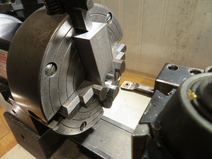

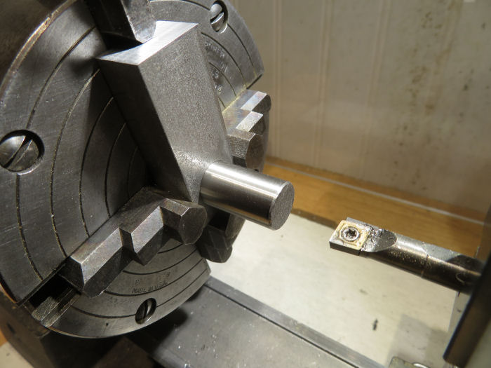

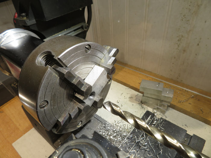

Then over to the lathe to drill/bore the holes to take the main shaft. Could have drilled/reamed on the mill, but this is easier for me, and may be more accurate a fit on the shaft, which may not be the same exact size as the reamers I have. I production-lined this process, spot drilling all 6  webs, then drilling all 6 starter holes, and then boring them out to size one at a time. The exact placement in the chuck is not that critical for making these holes since there is extra on the bar and they will be shaped down around the holes later. The placement of the second hole in each is more critical.
I'm done boring out the first two webs to final hole size, here I'm working on the first one:

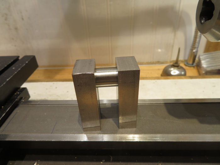

test fitting with one of the crank pins (that has had the ends deburred! )
With the first one done, the handwheel on the cross slide was zeroed so I can get the others done quicker - will stop just short of zero on each and test anyway. The final cuts are done with several spring passes, not moving the cross slide but still going back and forth in the cut a couple times slowly, which smooths the cut and takes off that last bit of metal.
One set bored out. These holes will be on the main shaft, not the crank pin, but its the same stock.
Four more holes to bore out, then on to the next stage. The webs are thinner at the outer ends, and I want to thin them down for that before drilling the crank pin holes, just in case the metal moves a touch from taking off on one side only. Unlike the brass/bronze, I can't stress relieve the 303 stainless, and it can move just a little, even on short sections, when milling off one side. Better to do that before boring the second holes, so I can keep the holes parallel. I'll need an alignment jig of some sort, or at least use a pin in the first holes and drill them together.

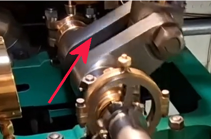

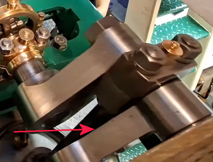

Thanks for the clarification Michael!  I was thinking it was the end section, but it makes sense that its the center, since the guarantee lettering is there. Do you know why the two end crank webs are different? On one, the webs have straight sections between the hub and crank pin ends:
And on the other, the outer web has a slightly different shape with the straight section recessed in:
Do you know why they are different?
Thanks!Chris

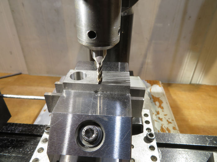

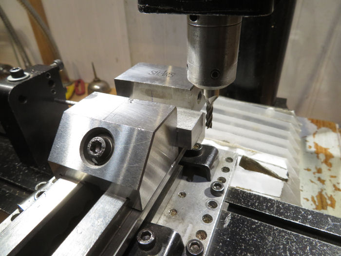

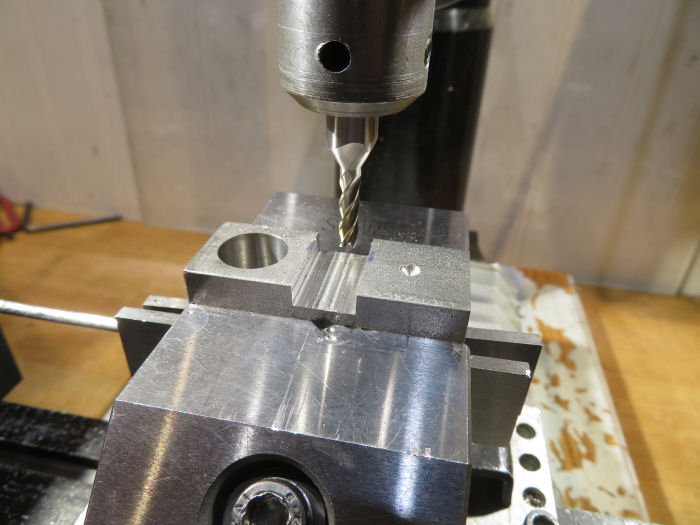

More done on the crank webs. The webs outsides were notched back in the center to begin the shaping.
As suspected, this did let the bars relax just a bit, causing the ends to arc over. Not much, but I want the holes to stay parallel to the web sides so the finished crank does not have any bend to it. So, I did a little trimming to flatten the outer edges square to the holes again - just a light facing cut was all it took.

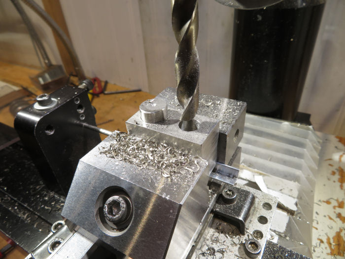

Then set up with the face around the first holes on the base of the vise and the pair of blocks aligned with one of the crank pin blanks, and drilled/reamed for the crank pin holes. The pump webs do not get narrowed, so they did not need the trimming step.

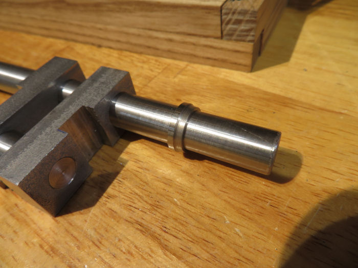

Over to the lathe, turned up the crank pins. One end of the pins is longer, where the big nut will go:

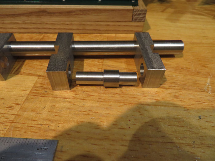

Test fit of the webs/pins on the crankshaft main rod:
 and made up the stop rings that will go on the outer ends to keep the crankshaft in position. I'll attach these last.

The thing about that one crank looking different is a bit of a curiosity. No one knows exactly why that is. It likely dates back to some repair job from the past. Or maybe the workshop elf tasked with filing a new crank said to himself: "I’m not crazy enough to spend all day filing this thing just to make it look nice and round; the way it is now is good enough, and the pub is closing soon anyway."
Or something like that.
