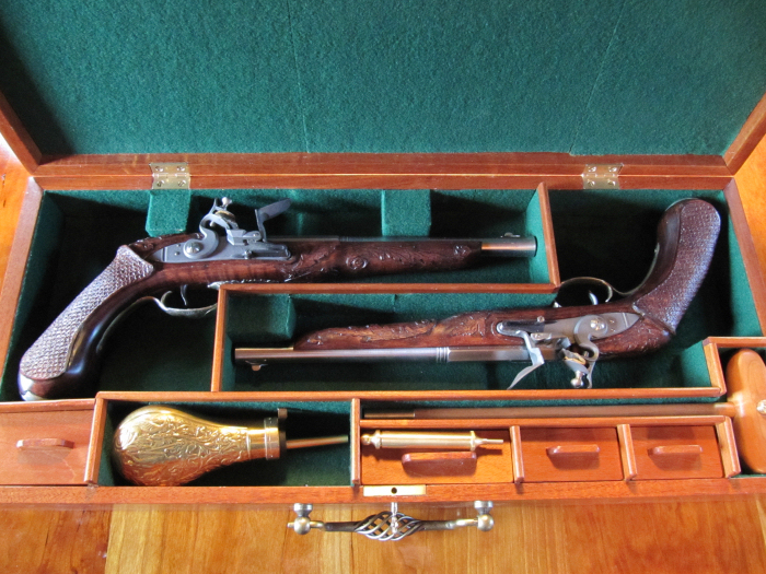

Fun side projects. Couple Pennsylvania  long rifles, a Jaeger rifle, a Baker, and a cased pair of dueling pistols. All flintlocks, purchased the barrels and locks, plus castings for other parts, did the stocks from scratch. Fun to inlet a 42 inch octagonal swamped (wide at breach, narrows then swells back out at muzzle) barrel into curly maple with hand tools!
The duelers - octagon to round barrels and locks were purchased, rest and case were made from scratch:
