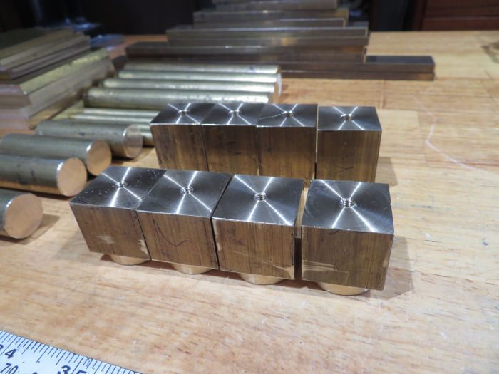

Gotten a start cutting metal. The corner pillars will be pieced up from some 1" square bar and some 3/4" round bar to make it easier to do on my small lathe. Got the lower and upper sections all trimmed to length, and drilled/tapped holes for assembling things. The lower blocks are tapped top and bottom, to attach it to the base and to screw in the round section in the middle. The upper blocks are just drilled for 1/4" dowel pins, which will be loctited in place. That removes any issues about alignment of the top/bottom blocks with threads. Lots of ways it could be done, this seemed simple. Note that the bottom blocks, in the front row, have a round section turned on the bottom. This forms the decorative foot. I will go back and sand the sides of the blocks to clean them up, the raw square bar is a bit ugly. First, they need to be cross drilled for the bars that will connect the front and back sections, and drilled/tapped to attach to the flat bar that runs across the front and back sections.

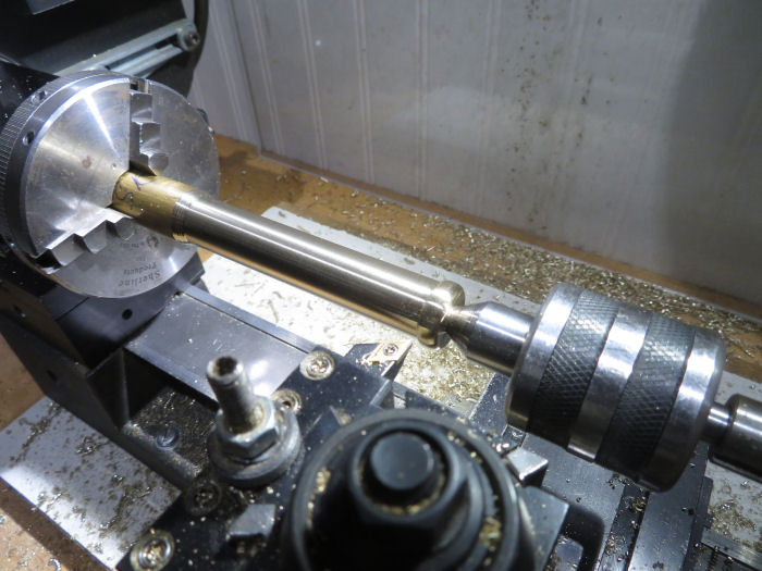

Also got the middle sections trimmed all to the same length, and have started turning in the shape on one end of the first one. One end of each is threaded to attach to the lower block, and the other end of each is drilled for the dowel pins.
