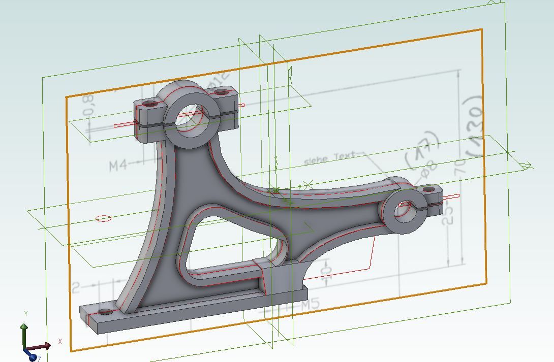

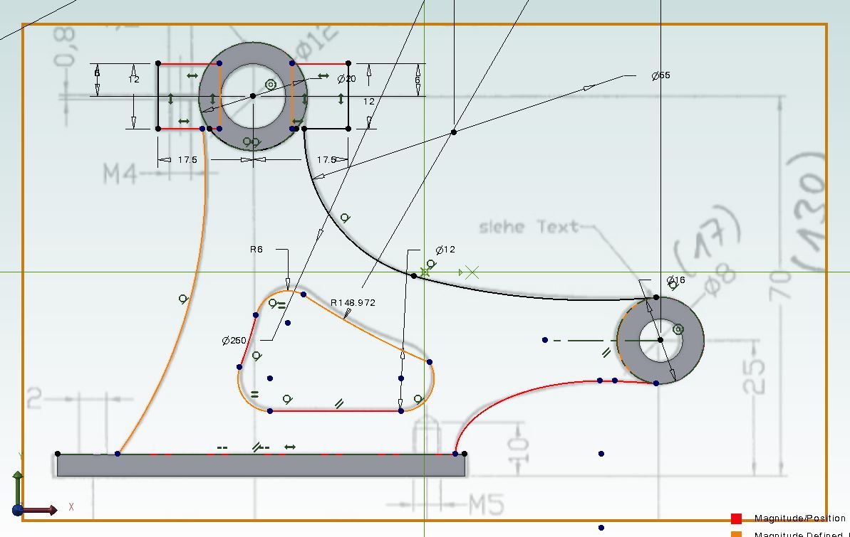

The profile for the plates is provided on paper to be glued onto the plates, similar to Kim's clock.  I need to translate that into a DXF file somehow.  One idea I have is to measure the drawing and come up with a list of points.  Then the Spline tool in Fusion or SolidWorks should do the job.  The reality is that the curves are decorative so there's no need to be too concerned with any small variations.
  • Posts: 2870
Re: Strutt Epicyclic Train Clock (maybe?)
« Reply #14 on: June 28, 2025, 01:08:53 am »
To layout the plates I madea copy of the right half of the drawing and marked dots along the curves.  Then I copied the page with dots.  One copy I fastened to some aluminum sheet and put in the Bridgeport vise.  I put a center drill in the chuck and used it to locate each dot, with the DRO giving me the coordinates.  I wrote the coordinates on the copy tediously, and then even more tediously created points in a Fusion sketch.  The only way I could figure to assign coordinates to the points was to move/copy a point at 0,0.  Once they were all entered, I used a combination of 3-point circles and spline curves to draw the outline.  I then mirrored the outline.  The profile looks fine, and the sketch can be extruded, so there aren't any gaps.
I then exported to a STEP file and then used an online STEP to DXF converter.  Unfortunately, none of my software that deals with DXF could read the result.   :(
Up until now the only Fusion parts I've dealt with were for printing, and the STL files generated were fine.  So I don't know where the problem lies.
I did get the laser to cut some practice holes in some acrylic, and also tried engraving it.  That looks good.  The laser is pretty accurate;  I cut a 1/2" diameter hole in 1/4" thick material, and with an inside micrometer it measured .504".
