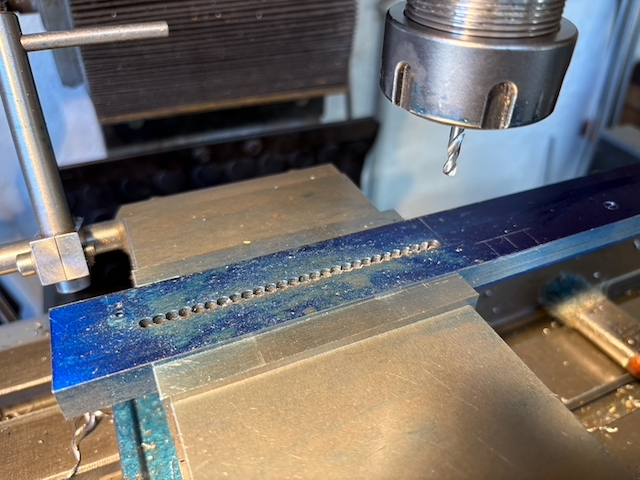

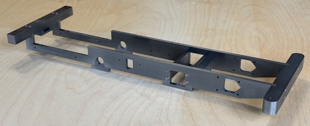

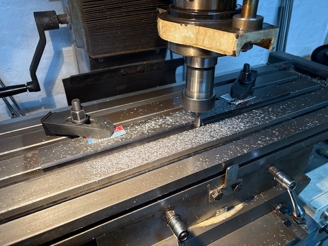

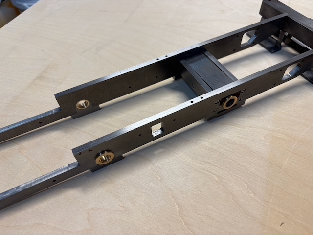

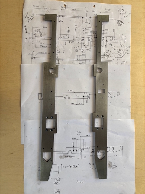

First order of business on the engine is the main frame. Cold rolled bright mild steel flat bar was milled to size for the side frames. The X-axis travel on my RF-45 clone milling machine was just enough to mill the length of the side frames in one go.
The blanks for the two side frames were then bolted together for all subsequent operations.  To avoid tedious hacksawing, the cutouts for the fire grid were drilled out.
Eventually the two side frames, pedestal braces and rear axle boxes were complete!

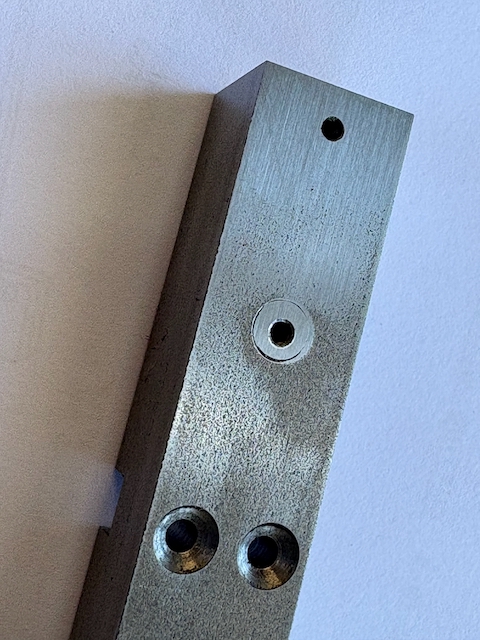

Due to carelessness, an M2.5 tap broke off on the foot plate. Impossible to remove, the broken tap was drilled out from the opposite side with a 5mm drill. An M6 plug was then made from silver steel (drill rod), screwed into the foot plate with Locktite. I am now wondering if the Locktite will be able to handle the heat of the fire?
A 2mm drill bit was initially used for the M2.5 tapped holes. This was then increased to a 2.1mm drill bit, to reduce the risk of breaking another tap in mild steel. This resulted in much easier tapping!
 I also noted that tapping the drill rod was much easier than tapping the cold rolled bright mild steel. This made me realise that I should pay closer attention to the type of steel alloy I am using in general. Softer steels will extend cutting tool life, and cutting tools are getting more expensive by the day. Kozo suggests using brass all over, but it is prohibitively expensive.
Any suggestions re preferred steel alloys to use, will be appreciated.

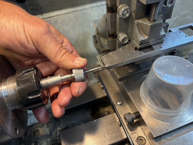

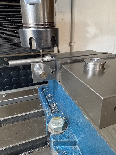

The M3 holes in the end of the side frames were drilled and tapped on the lathe by clamping the side bars onto the vertical slide mounted on the cross slide.
As always, it took much longer than anticipated, but I can finally reproduce Kozo's photo of the completed main frame!

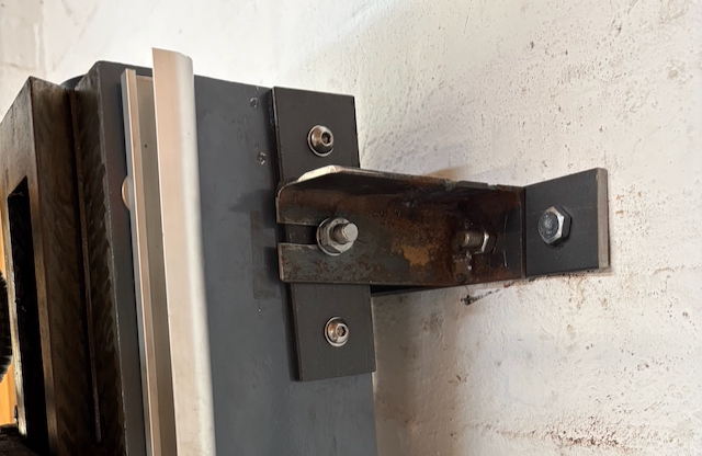

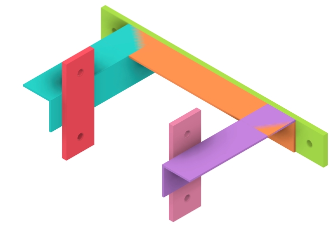

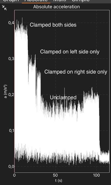

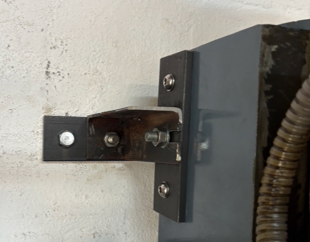

So I will have to make do with the tougher/harder mild steels available here. With solid carbide milling cutters getting more and more expensive, I decided that indexable carbide insert cutters may be a better option. To be able to use these cutters on my RF-45 clone mill/drill, I thought it would be a good idea to stiffen it up a bit, by fixing the column to the brick wall behind the mill. The idea  being not to put any side forces on the column, but to simply add a support that clamps to the column and use the mass of the wall for extra rigidity.

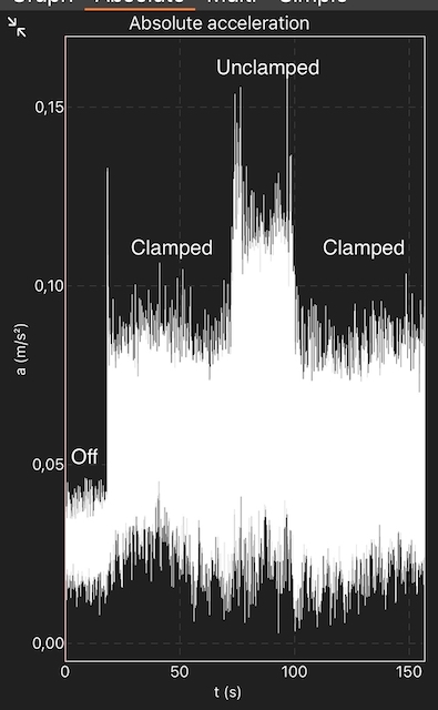

Surprisingly, the extra support resulted in a noticeable increase in vibration! I could use my IPhone as a vibration sensor to do some comparative measurements:

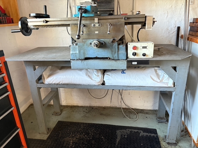

ChatGPT suggested adding extra mass to the base of the machine. Easiest was to add two 40kg bags of swimming pool filter sand:
The sand had the desired effect, and suddenly using the clamp reduces vibrations even further:
The combination of 80kg sand and the clamp resulted in noticeably less vibration.
The new Iscar cutter with indexable inserts works quite well on mild steel. Time will tell if the inserts work out cheaper than solid carbide cutters.

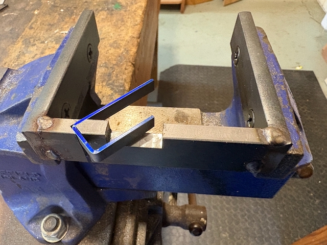

Carrying on with the foot board for the A3 Switcher, the bending jig used for the stairs on the tender, was modified to allow for the two 90 deg bends in the vertical parts:

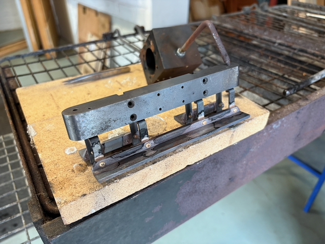

The foot board after silver soldering. The front bumper was used as a fixture during silver soldering, with extra washers between the foot board and bumper to prevent the bumper from sucking away too much heat.

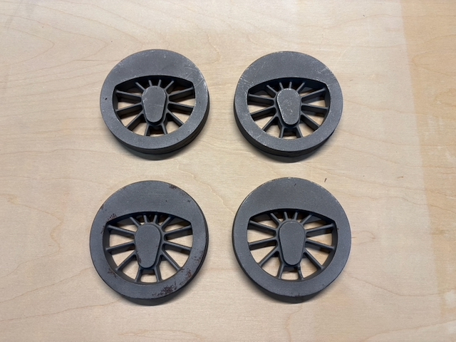

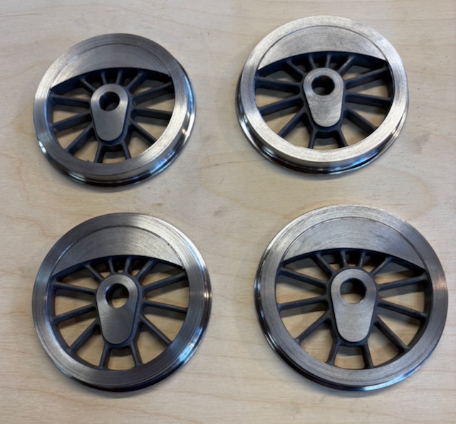

And now it is finally time to start machining the driving wheels for the engine! Four years ago, I made some wax patterns of the drivers and had them investment casted, as described here: https://www.modelenginemaker.com/index.php?topic=10915.msg252914#msg252914

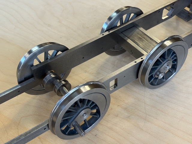

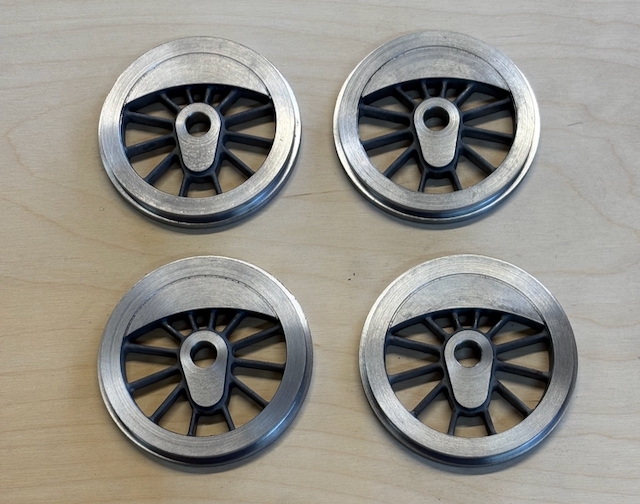

I closely followed Kozo's instructions to machine the drivers.
After the second chucking:
And after completing all the lathe work:

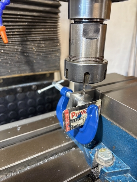

The drilling jig that was used to accurately drill the crank pin holes came in handy later to hold the pump and lubricator eccentrics to locate and drill the holes for the set screws.
And finally the drivers, axles, eccentrics, crank pins and side rod pins are complete. Could not resist putting them all together for a family shot:

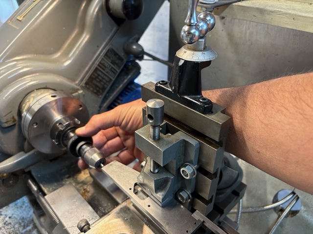

The 11mm axles were turned from 12 mm silver steel. It took a few attempts to hit the correct diameter for a snug fit in the drivers and axle boxes. Using wet and dry sanding paper to remove the last 30 micron turned out to be the answer. This was also the technique used for the crank pins, which were turned from the scrapped axles.
Next up are painting and quartering the drivers. But I first need to test the 2 component automative paint that was used on the tender, to see if it can handle to heat of the engine.
