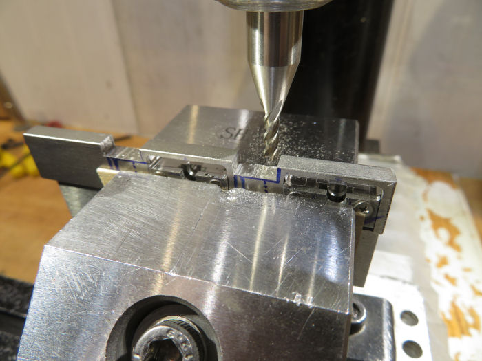

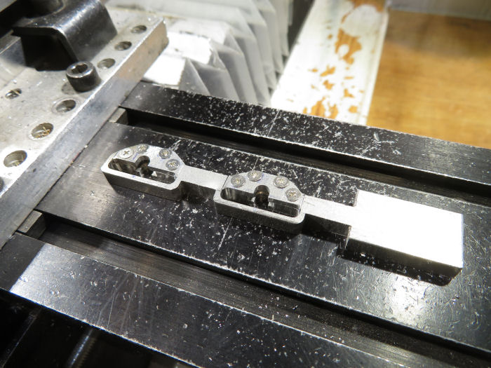

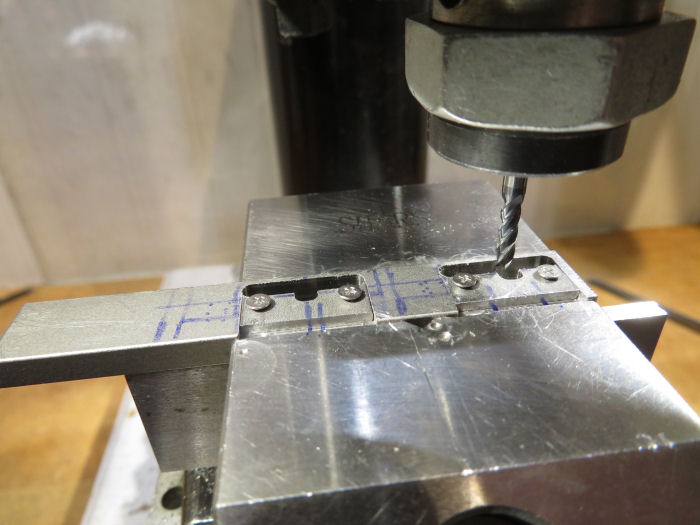

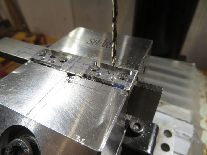

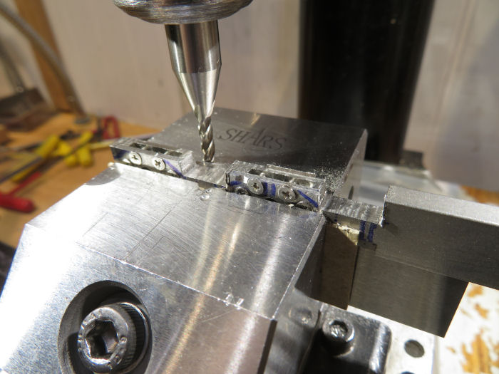

Lots more done on the release mechanisms. With the side cover plates screwed on, a small end mill was used to cut the slots from the center holes out to the inner edge of the straps and up/down to the ends. This was done in a few passes, the tiny end mills prefer a shallower cut or they can flex too much.
Then drilled two more holes in each piece. The one on the right, near the bottom end of each part, is for a screw to hold the end of the bar that goes back to a leaf spring at the rear of the engine. This spring pushes the eccentric arm forward, to keep the post on the link plate in the notch in the center of the release. The lever arm that will go in the center slot of this release can be pushed by the engineer to push the release block back, so that the vertical slot lines up with the post, releasing the post from the eccentric arm and allowing the engineer to move the valve manually. The control rod that moves this lever arm has a step on it that holds it in the released position, where the end of the lever comes out flush with the long slot so the post can slide up/down freely. I'll show that in action later on when all the parts are done. The hole on the left, towards the top of each block, will hold the pivot for the lever arm.

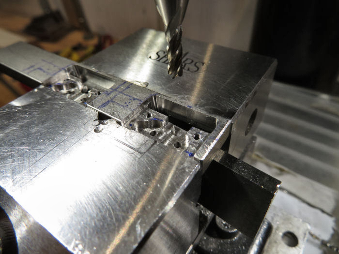

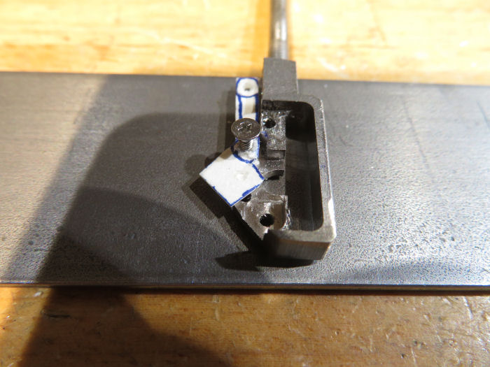

Then cut the recess into the block that will hold the lever arm and the end of the spring rod.
With the cover plate back on, you can see the opening where the end of the lever comes through to push on the post:

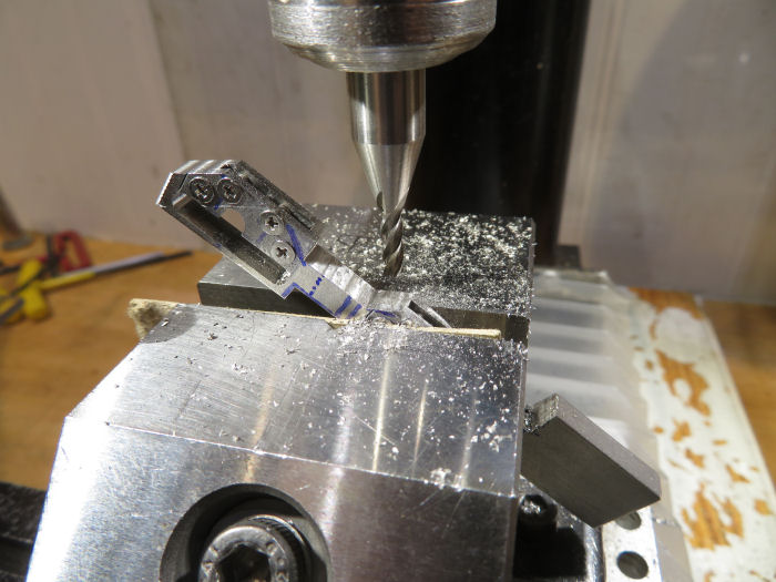

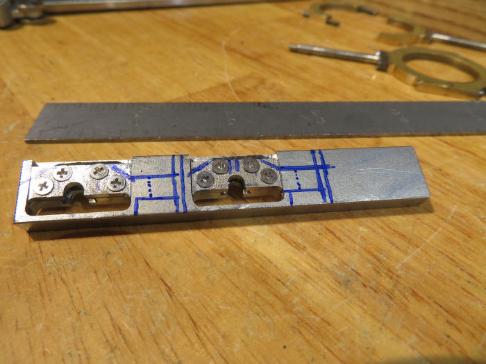

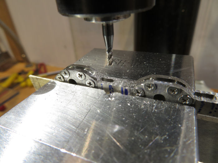

Then it was time to shape the outer profile on the blocks:
The front side was notched to form the top posts
Then the back side was notched to form the other side of the posts
and the angled sections milled away one at a time
Here it is after some corner rounding on the belt sander
Then drilled/milled in the slot for the control rod, one end will connect to the lever arm, the other end has a handle for the engineer.
And here are the two parts after being cut apart. Last step on them will be to drill/tap the hole in the top end to attach them to the eccentric arms. Then I can start making the lever arm and control rod...

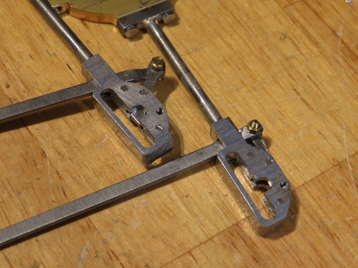

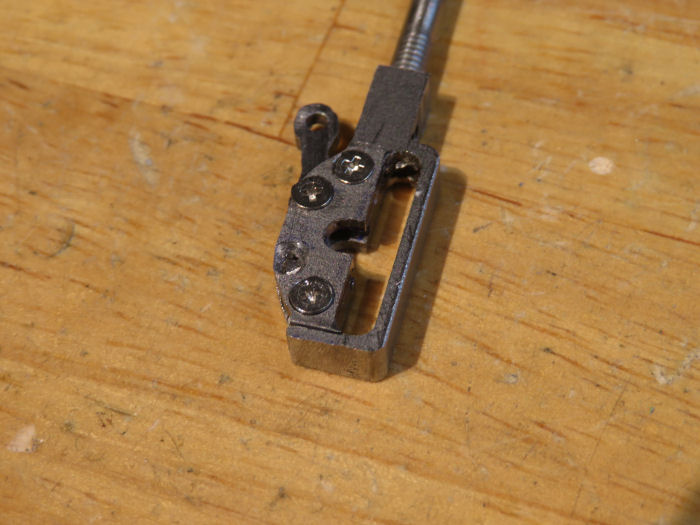

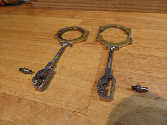

After lunch I got the blocks drilled/tapped and installed on the arms:
and the link plate posts and eccentrics installed on the engine

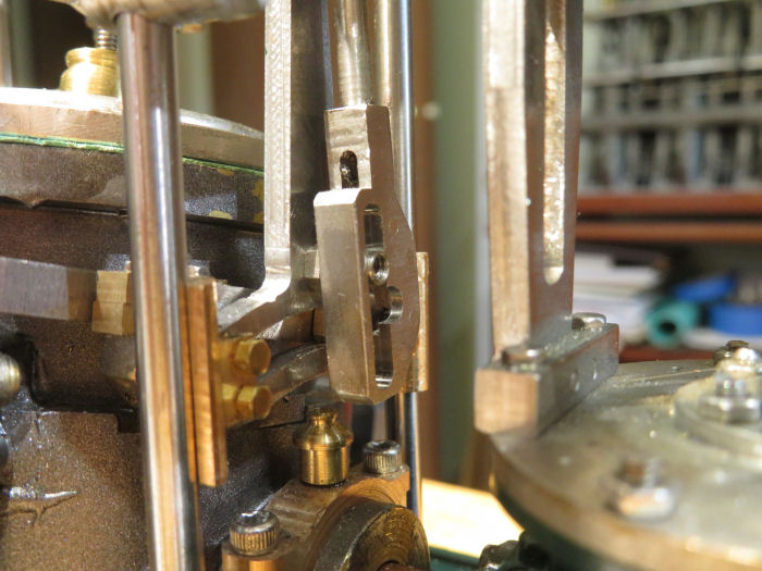

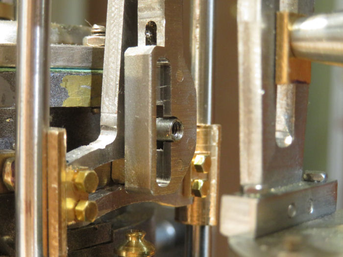

Here is a closer view of how the post on the link plate sets into the horizontal slot in the release block:
The hole in the end of the post allows another linkage to be attached, going up to the manual reversing lever that will pivot on the front vertical frame post, and extend out the front of the engine. These levers are the ones you can see going up and down in the videos from Michael.
And here is what it looks like when the block is pushed back, letting the post ride in the long slot so the engineer can manually move the valve with the lever. I still need to make the release lever, handle, and the manual lever/link.
I engaged the blocks on the posts one at a time and manually turned the crankshaft over to check the trave. The one on the right is fine, but the one on the left goes downwards just a little too far, maxing out the valve travel. So, I need to pull that one back off and shorten the arm a little bit. Both eccentric arms need to come off anyway to continue work on the levers. All that can wait till tomorrow!

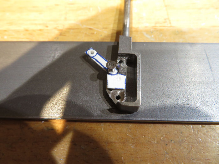

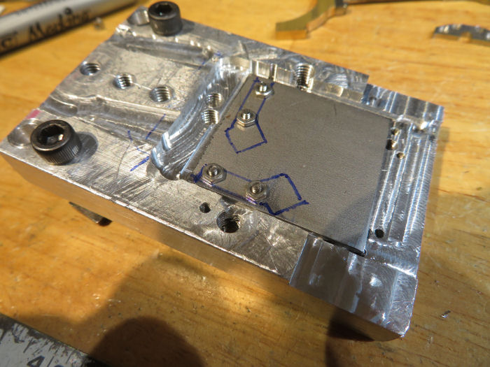

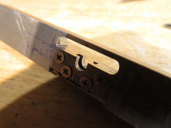

And, I should have studied the pictures and the CAD model a little more. No big problem, but it turns out the lower-middle screw I added for the spring rod is in a bad place, and I'll have to plug that hole. When I made a template for the release lever, I realized that it will interfere with that screw as the lever moves. Here is the template (cardboard) in place in the opening, after I milled back the back side of the opening a bit more for clearance. At the lower/left of the template, you can just see the screw hole it covers. In this picture, the lever is in the position where the post is pushed out of the operating position and into the manual valve movement position.
Why not just trim back that corner of the lever? Well, when the lever is swung over to the running position, the lower right corner would still cover it. And, the right hand edge of the lever has to fill the running position slot so the post can slide up and down without catching.
Its not a big issue, I will just plug the one one hole, and use the lowest hole for the spring rod.

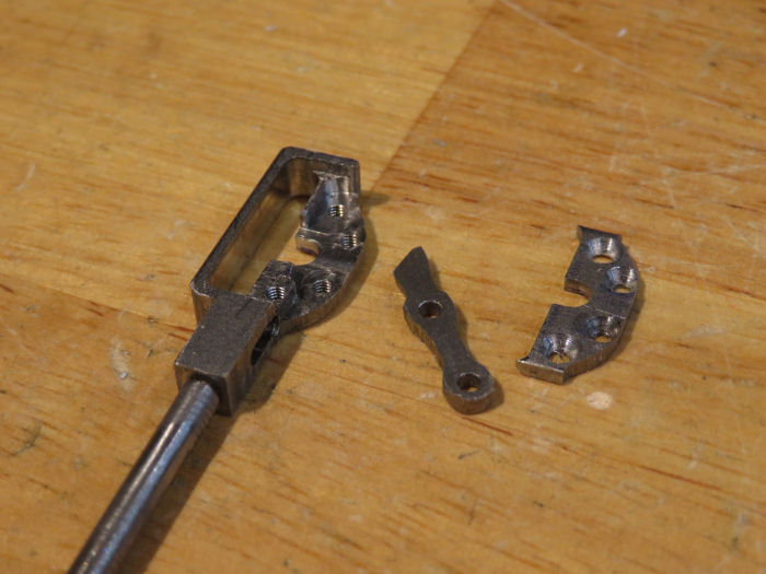

A lot of fiddly work this morning on the release linkages. I took a fresh look at the lever shape, and relaized I was making it too complicated, and that I could just file/sand them from some strips of tool steel! Here is what the shape ended up as:

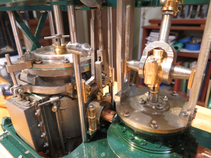

When assembled into the block, and with the lever in the 'disengaged' position, pushing the post out into the vertical slot so the valve can be manually moved:
and in the 'engaged' position, where the post would be in the horizontal slot and moved by the eccentric:

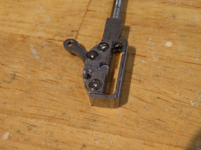

To move the release levers, there are control levers that pivot on the ends of the release levers, and go through slots in the blocks to where the engineer can reach them. I bent the ends of some stainless strips to reach over and next to the release lever ends and drilled/tapped holes in the ends.  Some 1-72 nuts and bolts complete the connection.

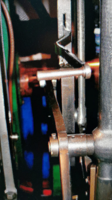

To hold the release lever in the disengaged position the control lever has a notch that lets the control lever drop down and hook on the block, holding it in place. Here I have rough sketched where the notch will be, later I will come back and file in the notches. Also, the outer ends of the control levers need to get drilled for handles, and cut to final length. Then I will make the rods that go from the lower back of the blocks to the leaf springs on the rear of the engine frame. Then I'll be able to do final (hopefully) assembly of these pieces, and start in on the manual valve levers, which link the the ends of the same posts that these blocks engage. A lot to this mechanism!
These two pictures show the real engine, with all the linkages in place:
