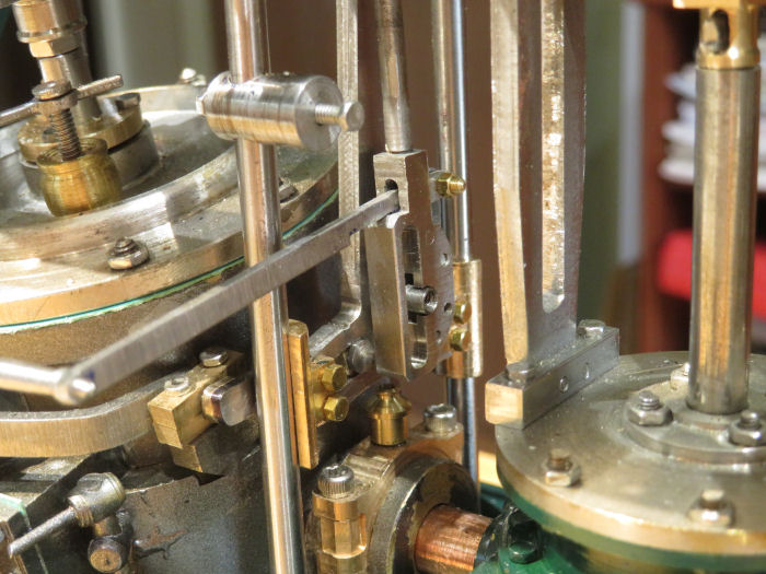

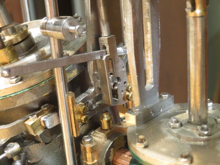

This morning I turned up the handles for the release levers. They have a 1-72 screw threaded into the base, head trimmed off, and the end of the lever was tapped to match.
Here is one assembled on the engine. In this picture, the post is engaged in the center horizontal slot in the block. The control lever is pulled forward, and you can see part of the notch in the bottom of the lever as it hangs down over the top of the block.
In this picture the handle was pushed back, pushing the post out of the slot, and the notch is down over the block, holding the lever in position so that as the eccentric turns and/or the valve is manually moved (by another lever not yet made), the post cannot slip back into the slot.
Next I'll make up the spring and its lever. The spring attaches to the rear of the base frame and sticks up behind this mechanism, with a rod coming forward to the base of the block, giving continuous pressure against the block so that when the post is engaged in the horizontal slot it cannot slip out on its own. Right now, without that spring, if I rotate the crankshaft, partway around it does slip out. The spring arrangement is on the original engine.

Very interesting indeed! I've never seen anything like this on any other engine.   :popcorn: :popcorn:
I'm sure you've covered this, but what was the purpose of releasing it from the eccentric?  Stopping the engine?  Reversing?  And you'd have to pull the handles on both cylinders to get it fully disengaged.
  • Posts: 23738
« Reply #593 on: August 14, 2026, 06:39:22 pm »
Hi Kim,
Its part of the reversing process. The single eccentric slips on the crankshaft, with two stops to limit its rotation. Each cylinder has its own throttle valve too. To reverse direction, both throttles are closed. One release is pulled and the manual lever, which I  have not made yet, on that valve is used to move the valve to the other end. That cylinders throttle is opened, causing that piston to drive the piston back the other way. The eccentrics will slip till they hit their stops for the other direction. The release lever is disengaged so the post can go back in its center slot as it comes by. Both throttles can then be opened, and the engine takes off again. The engineer has to pick which valve to manually move based on where the crankshaft stopped. Lots of steps to this dance! In later years, the Stephenson  style linkage replaced the Penn slip style with an easier to run engine.
And the other question  you asked, only one side would need to be released  since there are separate  throttles, assuming the proper one is picked for the crank position.

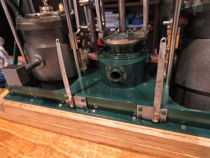

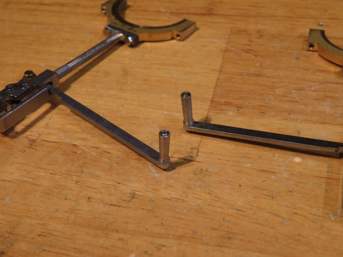

« Reply #599 on: August 15, 2026, 03:51:24 pm »
Its well past Spring here, but today is Spring Day for the model. I made up the leaf springs and mounting plates for the release mechanisms on the eccentric arms. These springs will push against the lower ends of the arms, keeping the post on the link plate in the horizontal slot in the release blocks when the hand lever is disengaged. When engaged, the block is pushed back against the spring so the post comes out into the vertical slot, and the hand lever is held there by the notch in it that I showed yesterday.
Next I'll make the rods/yokes to connect the spring to the blocks. Also need to get a coat of paint on the springs and plates.
