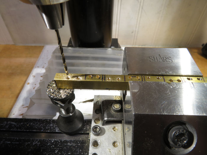

While waiting for the new batch of screws (due this afternoon) to get the steam chest pieces installed, I got the gaskets for the cylinder caps and the steam chest covers made, and also made up the brackets for the valve arms. These sit on either side of the cylinder on top of the rings, and will hold small bearing blocks that the valve arms will pivot in. They screw into the tops of the rings, in holes/recesses that were made back before the rings were installed. To make the two pairs of brackets, a longer piece of rectangular stock was laid out and drilled for all the holes. There is one left pair and one right pair, with the holes and notches mirrored either side.

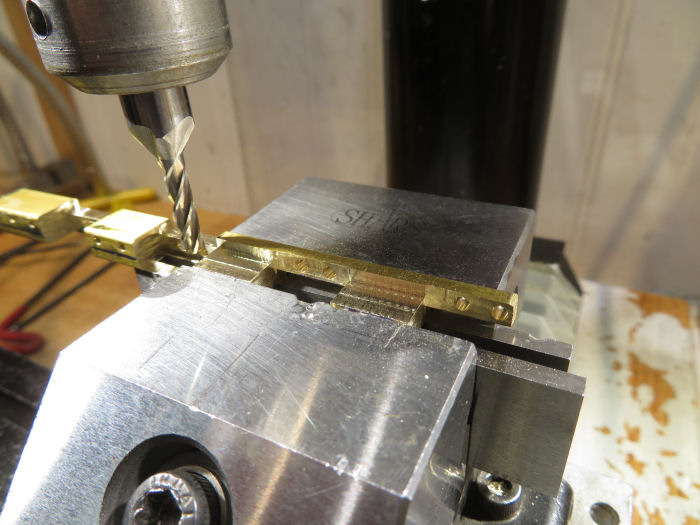

Then notched in the sides/tops of each bracket, before cutting them off. Final step before installing them was to blend in the side angled section with a rotary tool.

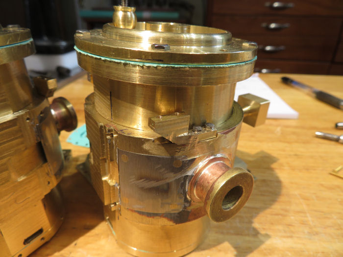

And then bolted them in place. The bearings will screw into the holes in the top/forward section. The valve arms wrap around the cylinder to the insides of the bearings, and will have rods coming through the bearings, to an arm on one end that will go back to the eccentric motion pieces.
This afternoon I should be able to get the steam chest bases/passages bedded in and installed with screws and epoxy as a sealant. Still to be made: bottom drain valve arms/posts, valve sliders, valve rods/glands, guides for the valve rods up on the top covers, the valve arms, and sets of studs for all the covers.

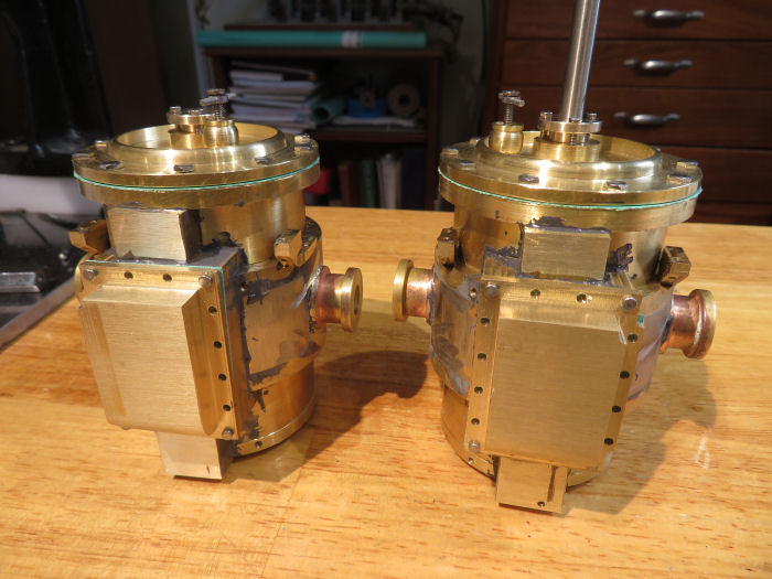

Yesterday afternoon the countersunk flat head screws I ordered showed up, so I got the steam chest base parts all installed with a thin layer of epoxy as a sealant. This morning the epoxy had cured up, so the screw heads were sanded off flush, and the rest of the parts mad so far assembled on the cylinders. There are stray streaks of epoxy that still need to be sanded off. Once painted, it should look like a big single casting.

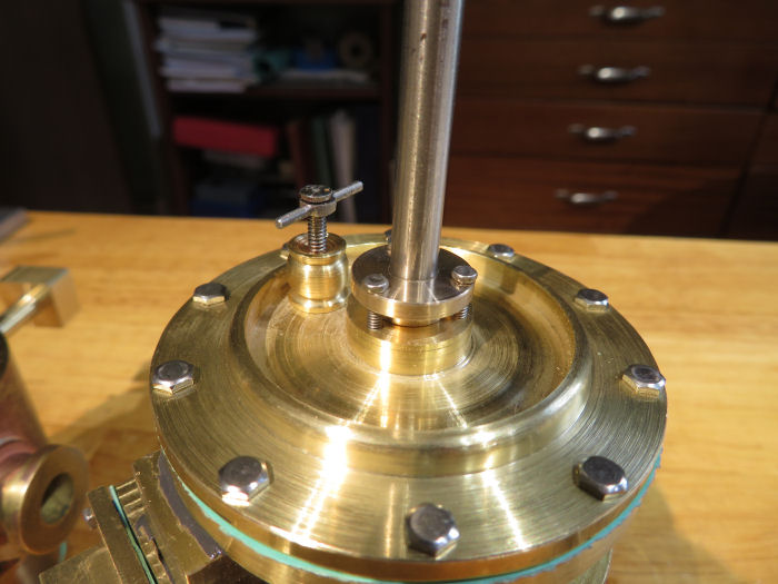

Also this morning the piston rod glands were made. They extend 1/4" down into the top of the caps to keep them aligned - an o ring is at the bottom of each hole. These glands were made from bronze, since they will bear on the piston rods as the cylinders rock back and forth - they act like crosshead guides on a non-oscillating engine.
And this morning seemed quiet. Too quiet. At the other end of the room I spotted a note from the elves, "Off to the beach, back later-ish. We printed you a replacement helper for the day! (snicker)"  Yes, they actually wrote 'snicker'...   :facepalm2:  This guy was standing there next to the note:
 :shrug:   Next I'll start in on the drain valve handle pieces for the bottom of the cylinders, and then the valve pieces. On these engines the valve rod comes out the top of the valve cover, which must have made assembling things interesting on the original engine.
