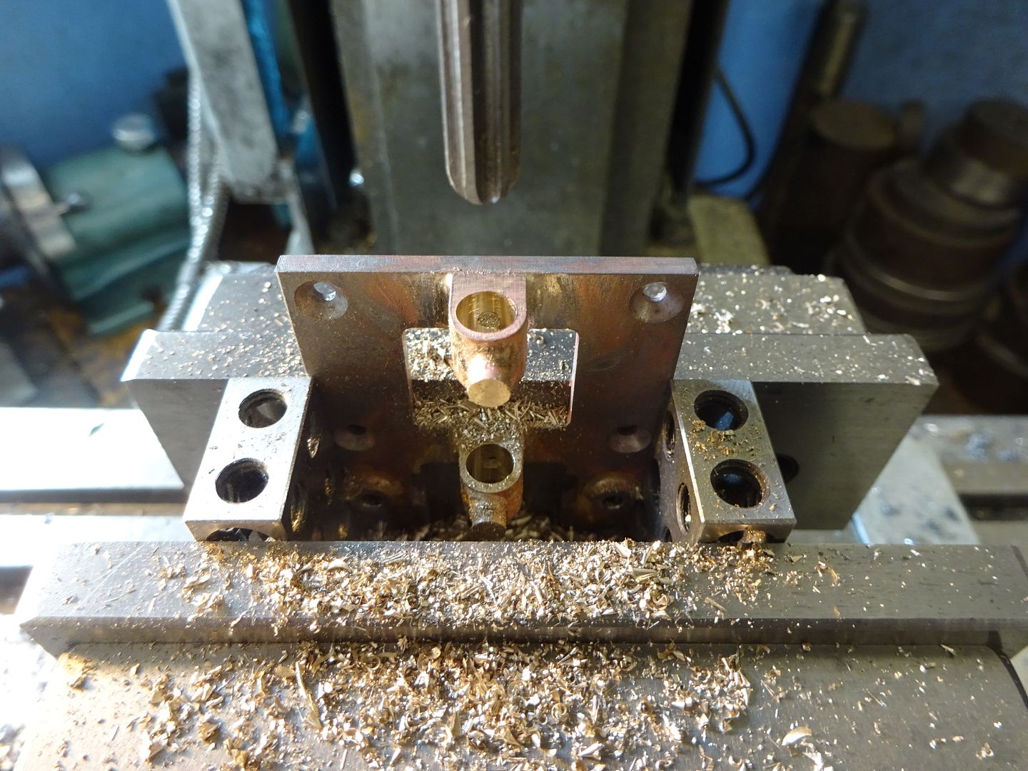

I was halfway through making the outer trunnion when I noticed it didn't line up with the inner ........... hmmm. So this where thinking I'm cleverer than the designer didn't pay off.
The drawing shows the bottom of the standard with a slot rather than 2 holes for mounting the inner trunnion, I ignored this completely to my cost. The slot allows for the inner trunnion to be moved laterally to so it can be aligned with the outer
This has now been corrected and I can continue with the machining of the outer trunnion and eventually align my trunnions!.........live and learn  ::) ;D

Next operation was to chop off the bearing pedestal cap in preparation for milling to receive the yet to be made bearing brasses; I'm still not quite sure how I get the centres to of the brasses to the same heights - hoping its as just a case of fitting them and then marking off with a height gauge.....

If you have the head room it might be possible to set the assembly up vertically and drill/ream the first bearing. Remove that for access and then do the smaller one.
A similar sort of setup doing the bearing holes after fabrication
I'd most likely just do it by measurement. For the main one it is base height plus bearing height. For the smaller base + A frame = bearing
Offline Sanjay F
  • Posts: 2499
Re: B.Hick & Son oscillating engine
« Reply #48 on: May 29, 2026, 08:56:27 am »
I did wonder about the vertical drilling/reaming but as you stated not sure if I can set it up. I think I'll need to get both brasses made and positioned before final decision, but I'm leaning towards measurement at the moment  :ThumbsUp:

The larger trunnion bearing is now complete and I think I may make the crankshaft bearings next. All the bearings will then be done and I can make all the brasses at the same time ............ :thinking:
