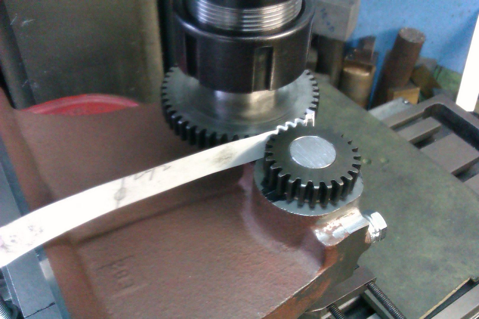

I was confused about the exact center-to-center distance on the gears, and so I pulled in drawings for the exact gears that I will be using from McMaster Carr, and inserted those into the model.
I am assuming that the pitch circles touch, and that determines the center-to-center distance ?

For drawing purposes add the PCD of the two gears together and divide by 2 to get the gear ctrs. When it comes to actually making the engine you want to set it up with a little backlash, I use a depthing method with teh small gear on a dummy crank and the big gear mounted in the mill bring the two gears together with a strip of copy paper between then and zero the DRO when they turn freely by hand.
Got it, thanks.
