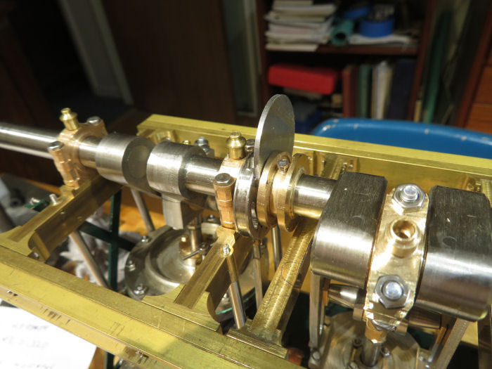

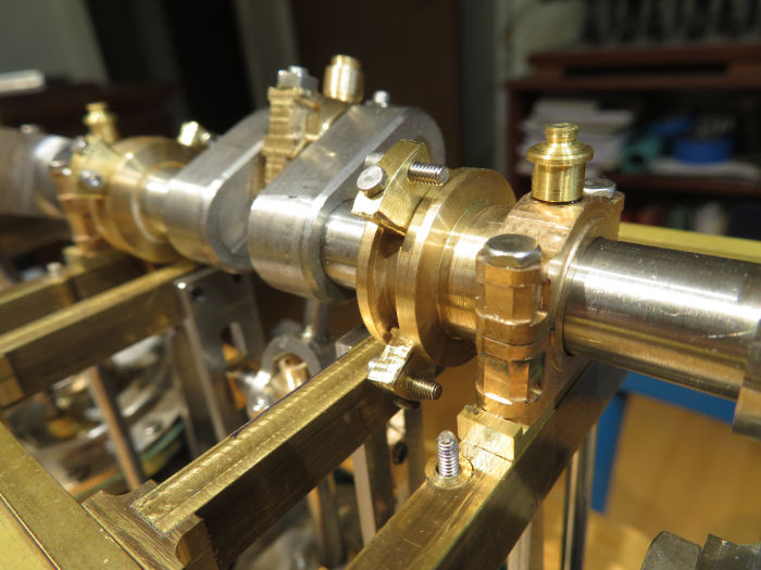

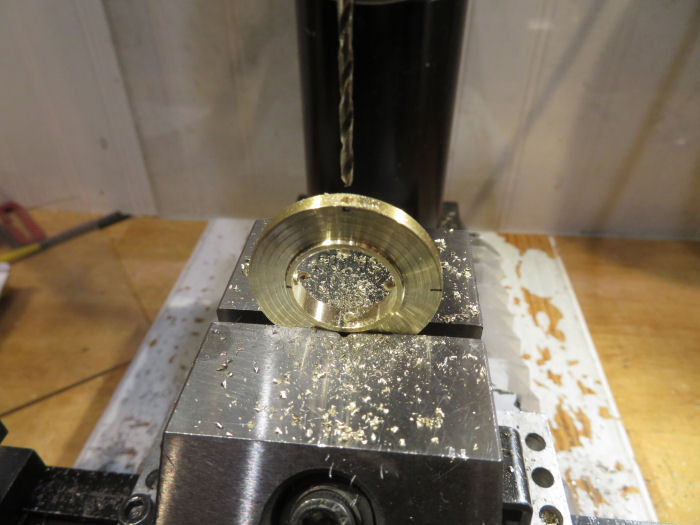

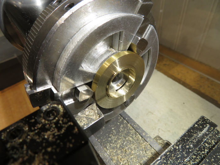

Got the second counterbalance milled to shape, and got them installed on the eccentrics. Here is one test fit on the crankshaft. There is a slight interference with the guide tube for the valve link plate, will take that back next time I have the upper frame off.

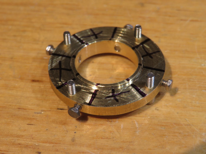

With the eccentrics/counterweights done, time to make the stop blocks that limit how far the eccentrics can slip. There will be two blocks per eccentric, that fit into the T shaped grooves in the bearings on the crankshaft. All four were turned up from a bit of round bar, with the sides recessed to form the T shape.
Then drilled/tapped the rim and sides for the set screws and stops.
Ready to cut them apart from the disc...

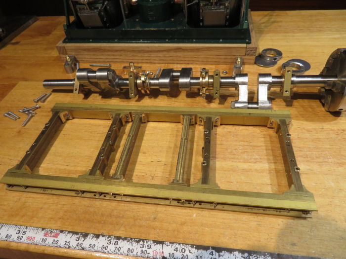

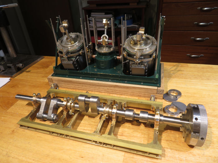

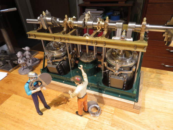

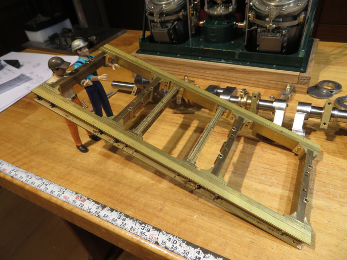

This morning I cut apart and trimmed the stop blocks, got them test fit on the crankshaft. The ring they attach to can be spun around for gross level timing, and each stop block can be positioned in the slot for fine timing. The post out the side will keep the counterbalance disc from going past that point.
The shop elves were all excited about getting the eccentrics installed, but I pointed out that I need to get the center guide tubes trimmed at the top to clear the eccentrics better, want the upper frame painted first, and want the eccentrics off to make test fitting the follower straps too.
So, off came the upper frame (it had just been set in place, so only needed to unbolt the piston bearing caps)
then unbolted the bearing blocks to remove the crankshaft
so the elves could take the upper frame off to the paint booth in the basement. I first sprayed/wiped down with some degreaser to remove any oils from the crank bearings.
Tomorrow should have the painted upper frame ready to reinstall. I'm also going to do a little touch up on the lower frame, a few places where the paint has gotten chipped and the screw heads for the pump floor need to be painted.

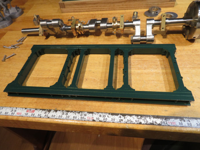

  • Posts: 23508
« Reply #551 on: August 07, 2026, 05:48:07 pm »
After some coats of paint on the upper frame. Dry enough to handle, will let it cure up overnight before installing back on the engine...
Offline Sanjay F
  • Posts: 2595
« Reply #552 on: August 07, 2026, 07:12:12 pm »
I love the newly painted and beautifully machined engine alongside the ancient and 'well-loved' tape measure!  ;D

Offline Chipswitheverything
  • Posts: 791
« Reply #554 on: August 08, 2026, 08:36:39 am »
As ever, I'm simply amazed at the terrific progress that you are making with another very complex and unusual engine, it's looking marvellous.  The paint job on the upper frame looks great, ties the multi part assembly into a unit very nicely.  The crankshaft seen just above it is a glorious work of art in its own right!
