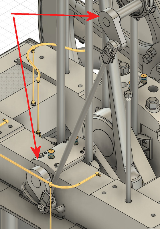

  • Posts: 23517
Re: Eccentric operated rotary valve
« Reply #3 on: March 27, 2026, 12:29:02 pm »
For a fully rotating  shaft, they would normally  put a crank at either end like a bicycle  foot pedal crank, so as one gets near top or bottom the other is in the middle. Large engines with offset valve shafts did id that way. Or they used an intermediate  shaft with bevel gears, or a chain drive.

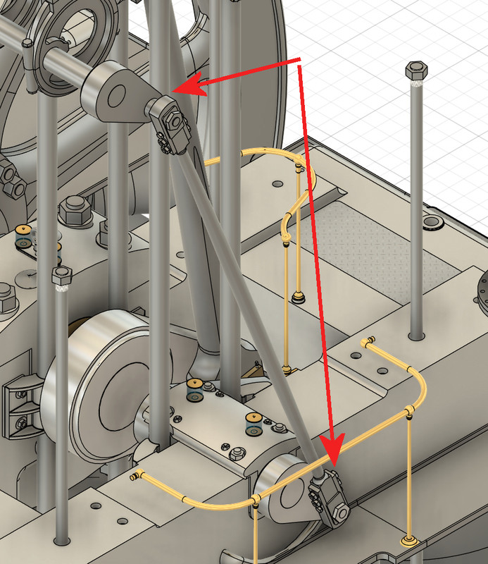

  • Posts: 23517
« Reply #9 on: March 27, 2026, 05:10:49 pm »
Here is a picture of what I was describing in my earlier post. These are screenshots of the CAD model for the big Allis water pumping engine, which has a side shaft to drive the valves from the crankshaft. The side shaft needs to stay in sync with the crankshaft on that engine, so they put a crank at either end of each shaft. The cranks on one end are 90 degrees off the cranks at the other end, just like a bicycle foot pedal crank. That way it can't lock up when one goes near top or bottom center. This is two pictures, one for each end of the shafts, so you can see the 90 degree offset.

  • Posts: 1451
« Reply #11 on: March 27, 2026, 05:31:11 pm »
Thanks Chris, I like this idea using two cranks (or eccentrics I suppose). You threw me talking about bike cranks as they're at 180 (although it would be fun trying to ride a bike with the cranks set at 90/270  :lolb:).

  • Posts: 23517
« Reply #13 on: March 27, 2026, 06:21:36 pm »
Thanks Chris, I like this idea using two cranks (or eccentrics I suppose). You threw me talking about bike cranks as they're at 180 (although it would be fun trying to ride a bike with the cranks set at 90/270  :lolb: ).
Doh!  You are right! Been doing steam engines too long, forgot how my bike worked!    :hammerbash:    :lolb:
