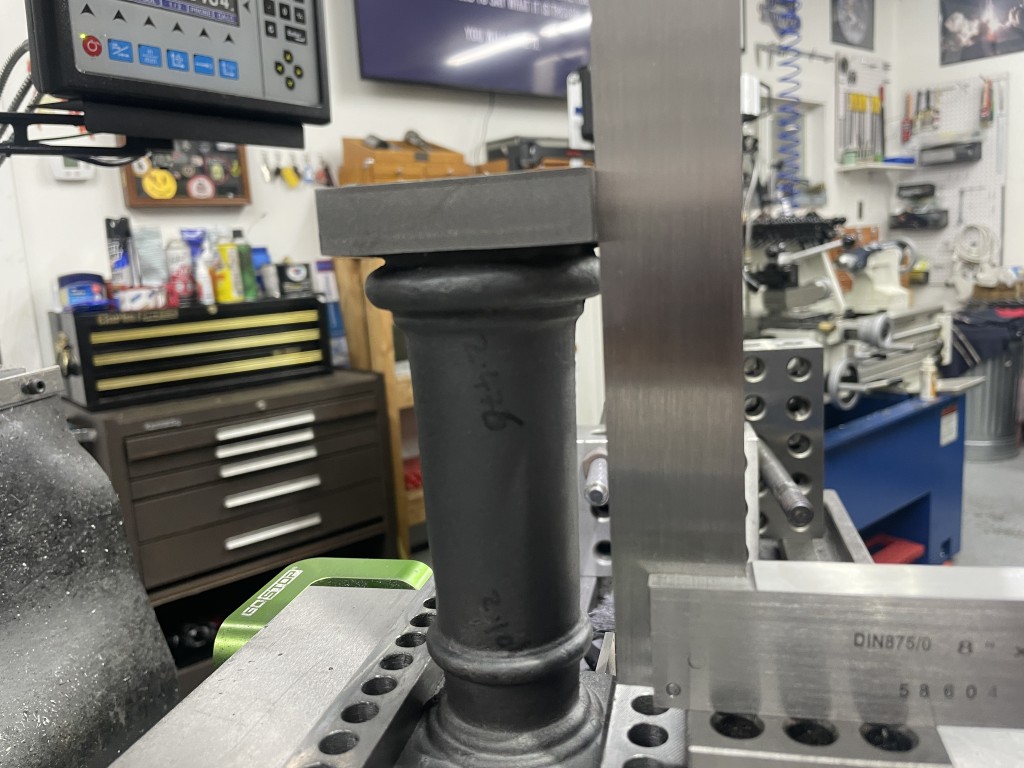

Finally back to making an actual engine.
This is one of "the usual offerings" so likely not very interesting to the elite but I'm doing it anyway. I think the ME Beam is a very pretty engine when finished, with quite a lot going on. As a basis I am using the Reeves offering of castings, which I purchased about 2 years ago I think. My initial look over the castings says they are OK - not warped or twisted or anything so I'm looking forward to an enjoyable, completely trouble free and relaxing experience.  :disappointed:
Don't worry, I can usually steer myself down paths that bring their own trouble and woes.
So all I've done so far is spend some time with the base plate. As seems normal on casting kits, the way the parts are dimensioned is largely inappropriate, and if not interpreted correctly could steer the unwary quite wrong I think.
For now all I've done is best condition the casting and skim the underside flat. Hey - it's a start. this done in such a way as to maintain enough machining stock on the top side features to get everything where it needs to be.
Best conditioning is the term we used at my last job to essentially balance the set up of a weldment or casting for the best combination of maximum machining stock on all features that get machined, while at the same time not distorting the part with clamping, and then also maintaining visual appeal as needed. What it means in this case is that I measured the casting all over as well as probing it with a height gauge on my surface plate to figure out how twisted / distorted it was. In reality actually pretty decent - about 25 thou variation across the main surface that is to be unfinished, same on the underside, with about 1/16" of stock on most surfaces, so pretty easy to level up and get going on.
The numbers on the casting represent height differences in thousandths of an inch from one corner.
Then up on the mill and skimmed the underside a few thou at a time until it cleaned up. I'd established that the center square feature where the column goes is actually the least out of flat, and indeed that resulted in only skimming about .020" off the highest point to get full clean up. I supported the part on a couple of machinist jacks as well to stop it flexing during cutting. It was a bit of a lightly clamped set up so I just took it really easy. After checking the finished cut on the surface plate there is no rock, so now I can get it clamped really well, best condition it on the table and start on real features.
Not much of a start - on the other hand quite the setting of the foundation.

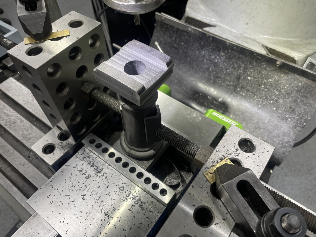

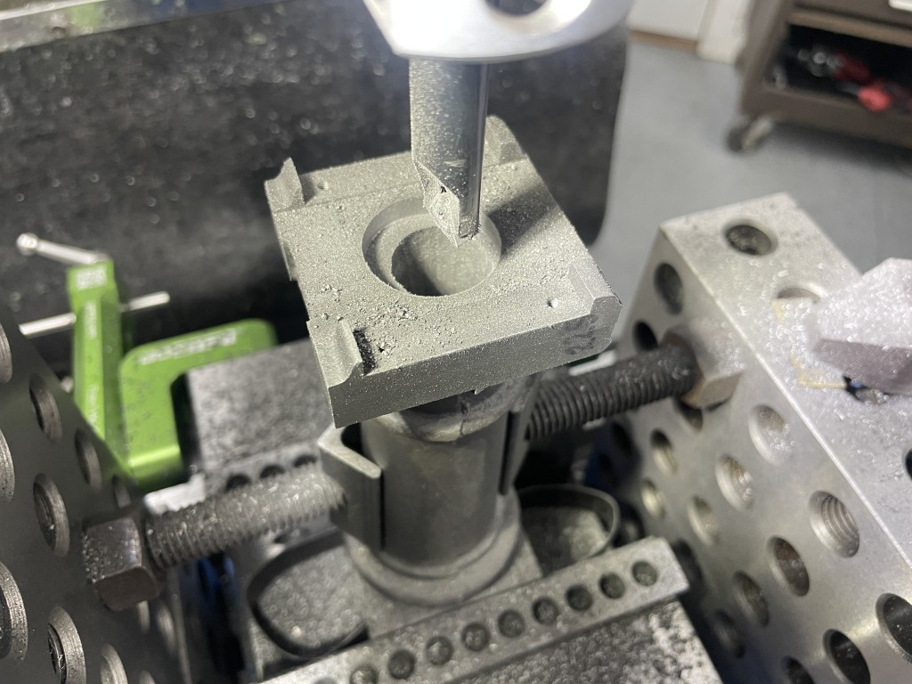

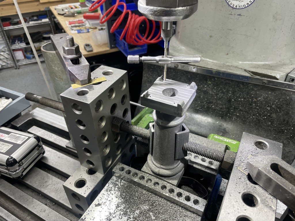

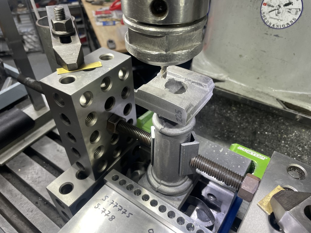

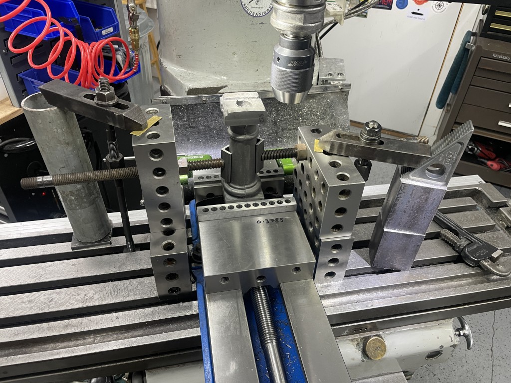

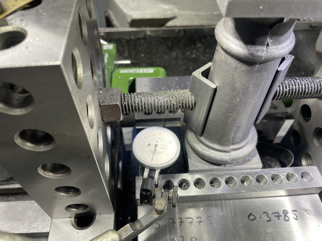

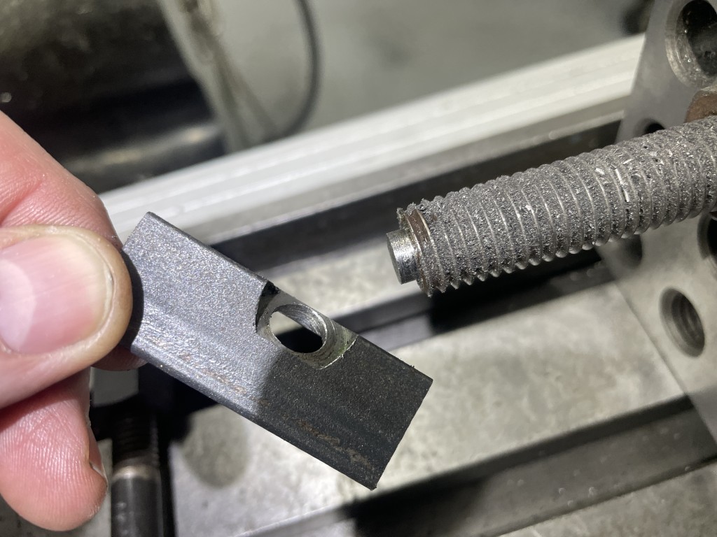

Stumbling forward at a breakneck pace, I actually clamped the base to the mill table tonight. It is clamped on top of a sacrificial aluminium plate which has been skimmed flat on both sides.
In order to get it lined up and ready I indicated the 4 red surfaces (edges) of the raised square, and the two long sides (blue).
I didn't drag the indicator - just went in and touched at several points along these edges, checking the DRO for offset. The part is basically within .005 along each of these 4 edges. They are surprisingly straight, which is why I used them. This is about as evenly set up as I can get it.
With it aligned, I will establish the center of the raised square in both the X and Y directions, and that will be the datum for drilling all the holes. Seems to me that basically everything on the engine is relative to the center of the beam column (and therefore beam pivot).
The heights of the various steps on the base will all be machined relative to the machined top of the square also. In this way, all these machined surfaces will be parallel to each other, so that everything is as square and true as it can be when assembled. What I am going for here, is an engine that runs without having to do much "bedding in".
So I started re-dimensioning the drawing to better show that and make for an easier reference. I did it long hand, by just doing the basic maths and writing it out on a copy of the drawing, but it started getting far too messy and I couldn't read my own writing.
It was more legible to make a basic model and show all the features using ordinates - and I can plot this out nice and big.
Also - I am using UNC and UNF threads instead of BA threads, just because of tap and fastener availability. I did a comparison of BA thread OD's and TPI numbers against the UNC and UNF series and found threads that are close enough. Not equivalent - they won't play together - they are just physically very similar in size. Should work out OK.
Then my evening of shed time ran out. So maybe tomorrow I can actually get some machining done. It's all in the prep anyway - do that right and the machining goes much more smoothly.

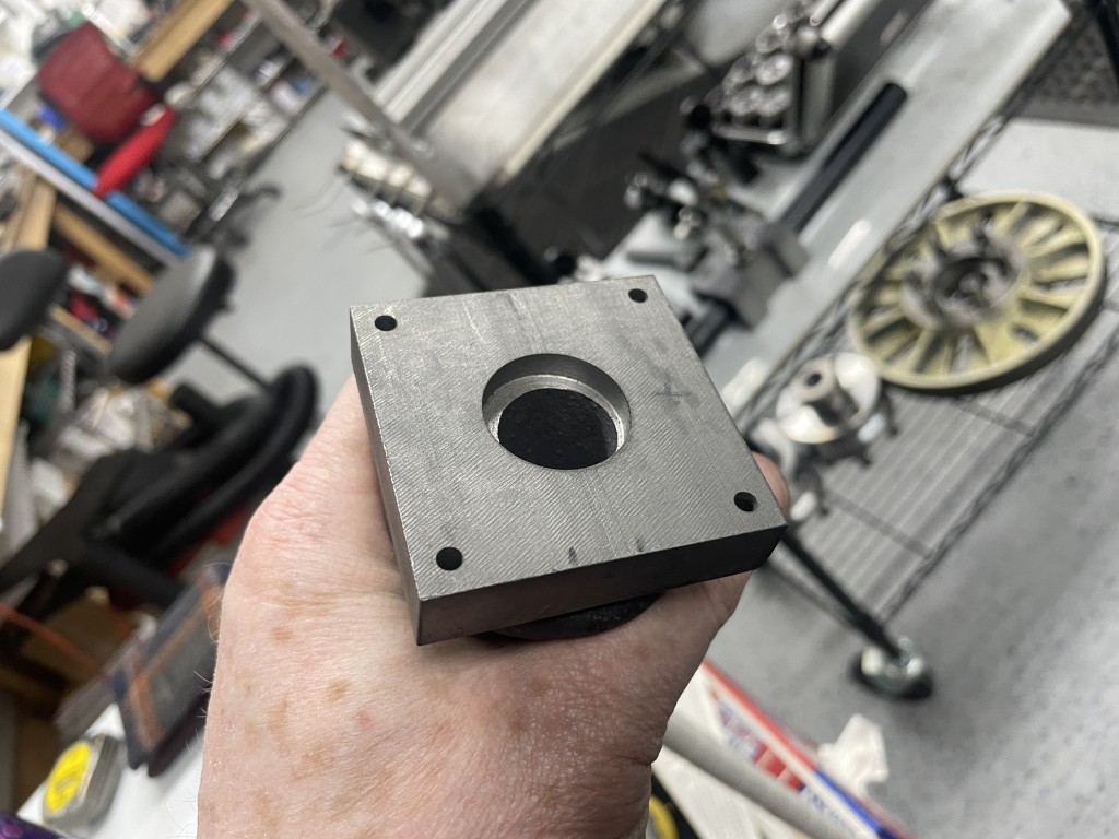

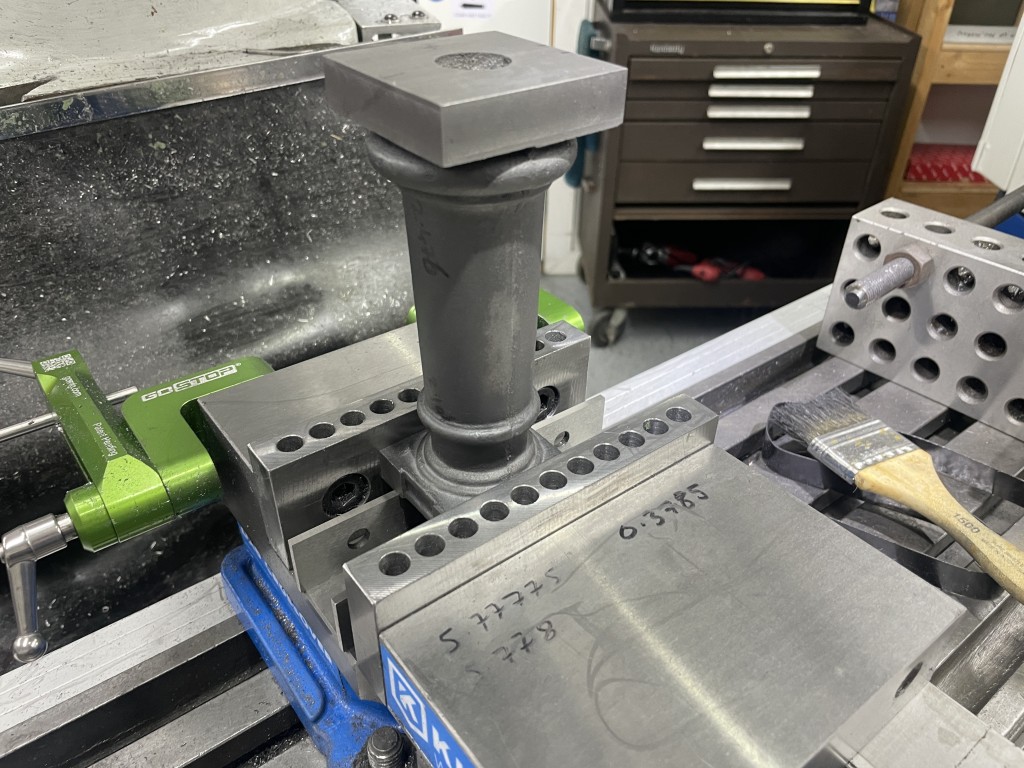

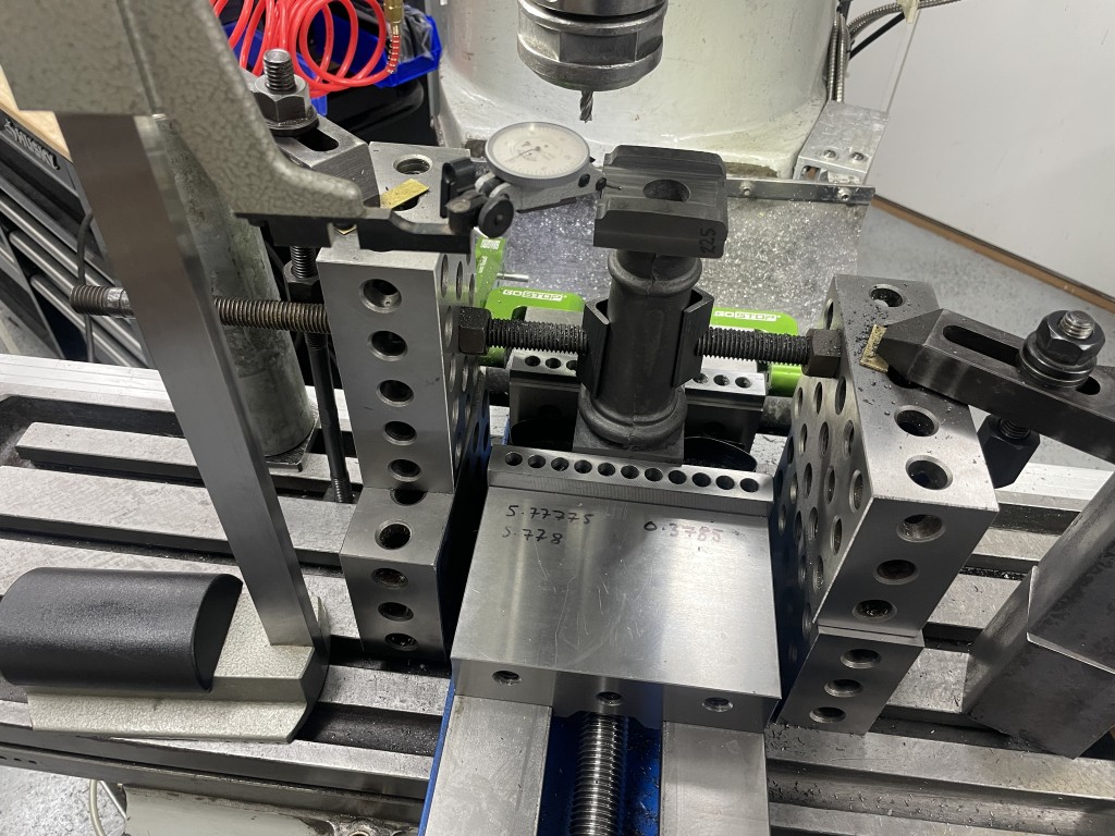

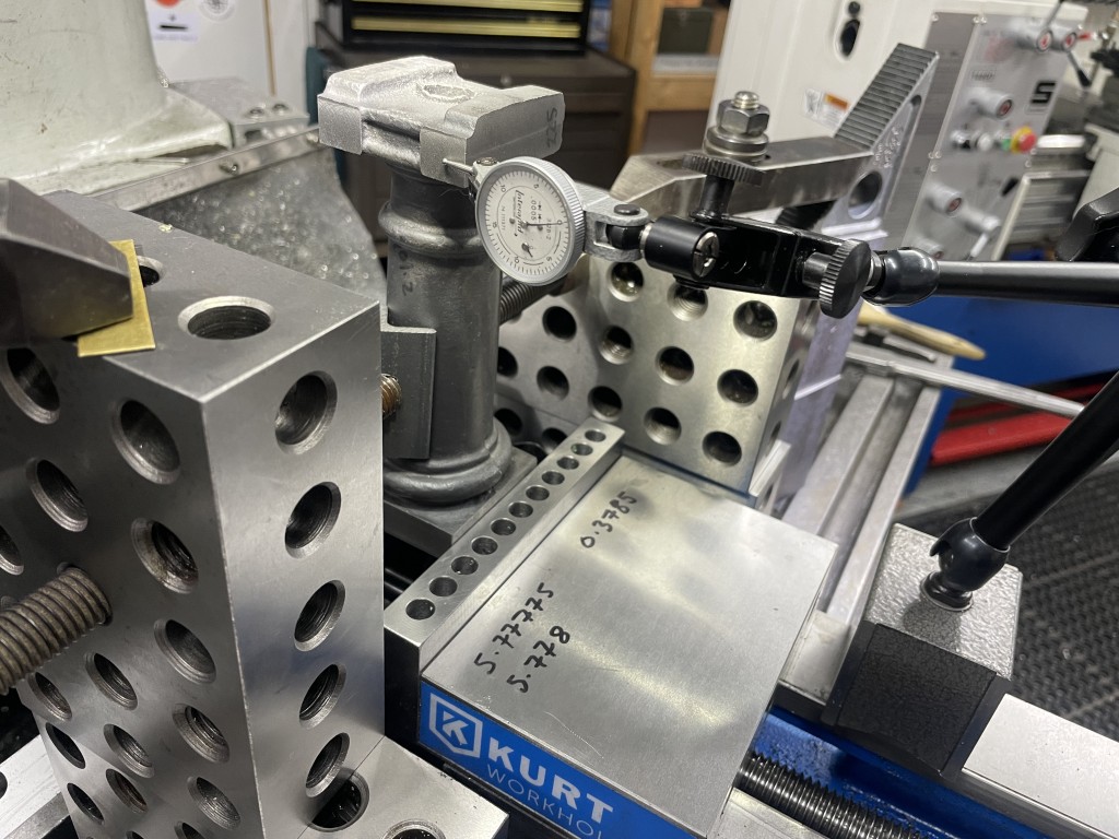

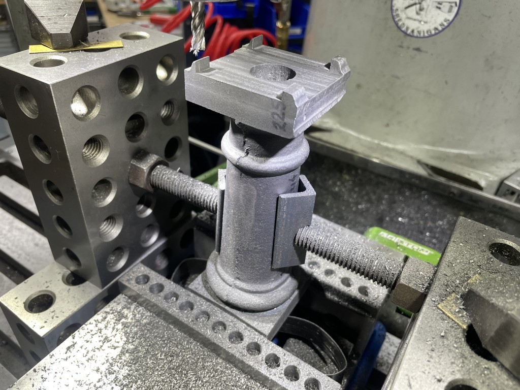

So next bit was simple enough really - touch off on the highest feature (having first measured heights of all the features to know what was to come off), fix the quill, touch off by raising the knee, establish the highest plane and raise the knee accordingly to clean off the other surfaces.
One feature had to be centered and machined on the width also to accept a bearing block later on.
This just shows my scratch where I recorded data about stock and heights etc.
Then the machined article. Ran out of time now so can't get the various holes in at the moment, but it's all set up well for that.

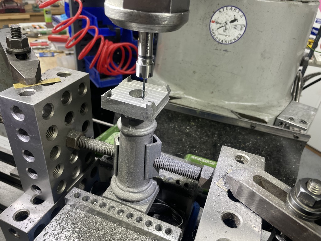

« Reply #20 on: December 24, 2024, 11:29:27 am »
I got time to drill holes. If you want you can watch the process here. It’s just drilling holes. I’ve been kept from machining somewhat by freelance engineering so this is all I got to do for the last month.
Bonus! Shedland Christmas light show spectacular!
I will post still images later. But - it’s just holes drilled and tapped.

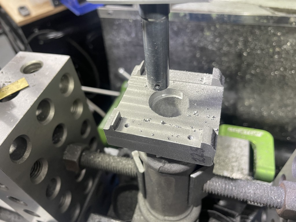

Not much to it really. I did a minimum clean up of the main bearing mounting surface and also the pump mounting surface. the plans don't call for that but I want those surfaces parallel to the other machined surfaces, so that all the final engine components play nicely together.
With that done I mounted a drill chuck - a cheap (it wasn't that cheap) and nasty import chuck which had loads of run out in it - fixed by clamping the jaws of the chuck to a nice piece of drill rod in the lathe and then turning the shank lightly - and installed a center drill and went around my ordinate dimensions and pecked every drill location. That was simply to look at the pattern and see if it was centered well enough on the casting.
I didn't take a pic of the pattern.  :facepalm:
I was happy enough with it - it looks well located overall. The patterns on the round boss are shifted relative to the boss center by about .015 in the X and .020 in the Y, which is easy to see by eye. I think this boss will be completely covered in assembly and not noticeable. If it is noticeable I may put the casting on my rotary table and lightly skim the diameter just to true it up.
Then, happy with that, I went around and drilled and tapped.
Followed up by dusting off the outside edges of the base to make them straight and clean. I also cleaned the flash out of the openings in the base. Did all that by eye and by feel just to get the ugly off, as Joe Pie says.
And that's that for the time being.
I have a little hand fettling to do yet. I chose not to do the base mounting holes quite yet as I have not decided on the final presentation - although really what else am I going to do other than bolt it down through those bosses? Need to hand fettle them round first where I had to cut into them. Or maybe mill them off altogether all the way round - hence not worrying about drilling them quite yet.

It has been a bit, but I picked this engine up again. I suddenly got an urge to mess with the column.
I'm pretty sure this can be made successfully by simple layout techniques, as the sideways position of the beam can float a lot on the pivot. Still I think it's a good idea to make things as accurately as possible - meaning making sure geometry of features is appropriately aligned, so I spent plenty of time measuring the casting to see where the material sat relative to where the finished part has to be. In doing so I discovered that the square base did not have enough material in spots to clean up, and the same was true on the top platen. So I made a basic 3D model and changed a few dimensions to look at the impact of altering things a bit, and came up with a plan, which included measuring the mating entablature to make sure that would attach and be the same width. I was happy to see there was plenty of material to take off the sides of the column top to match the entablature width.
Model (not all features are modelled in)
Column and entablature
Measuring included a lot of this kind of thing - shimming one end and flipping back and forth between opposite sides and touching off just to see roughly how central the column is. What I established was that with a 1/8" shim under the small end, I can bring the base and top to size and clean off the base square and get some reference surfaces to work with.
So then it's a matter of transferring that to the mill and getting on with it. Doing the pre measuring gives me the confidence of defining a process to follow. The one part of this that will be a bit freeform is turning the actual tapered column and decorative features. That will be a case of basically turning to clean up and it is what it is - but the mounting features need to be accurate.
With all the measuring pre work it's very easy to take off the appropriate amount of material each side of the top and bottom fatures and get them to size - plus I know they are true and centered relative to each other, which will make it easy for me to get the beam bearings located so they will positioned correctly relative to the soleplate positions and therefore the cylinder and flywheel bearing positions.
At the same time I squared off the underside using this long end mill that I happened to have on hand (was given it by a machinist at a place I used to work. He gave me all his old HSS tooling as he no longer used it).
The trick here is very light cuts and several spring passes so that the underside stayed square. The underside is NOT to finished dimension at this stage. I'm leaving material so that I can adjust that and get the height correct after machining the bearing mounting surfaces.
Then a double check to make sure the dimension from each machined surface is correct, as well as being sure how to pack the part up for machining the opposite sides.

A little more progress today.
I set the casting up on parallels in the vice, and having learned the hard way that a tall part can really move about quite a lot with no support higher up, rigged up the below arrangement.
The angle pieces were machined with a flat and a clearance through hole, and the ends of the studs got a little turned end to fit loosely in the through hole, with the effect that the angles can tip a bit to take up the taper of the column.
I had an indicator in place when tightening the side supports to make sure I wasn't deflecting the part.
This arrangement kept everything nicely supported, and I was still able to get in with a height guage and touch off on the parallels, thus getting accurate measurements during the machining.
Now, having machined the sides of the plinth accurately relative to the base, finding center was straightforward and it was just a matter of gently machining away to meet dimensions. I used a 1/4" end mill to keep loads down and just took light cuts.
The inner surface of the plinth is the least critical, but I completed that first to use it to establish dimension to ensure the bearing pads were correctly placed. Cutting direction was always parallel to the supports.
With that done it was a simple matter of drilling and tapping holes for the bearings (I am using all UNC or UNF just because I do not have any BA tooling) in this case 4-48.
Then I put in a counterbore, which will be used to hold a plug to properly support the part when turning the column. As you can see, the core is way off center. When complete, I will likely put a decorative brass plug in the hole.
I then inverted the column and repeated some of the process. Since the underside does not need any facing at this stage, only hole drilling, I did not need the side supports. I sat it on parallels and clamped it firmly. I did do a check with a square in both X and Y directions just to be sure everything was right.
While I had it set up, I put another counterbore in. I might use that for holding it in the lathe. I might not. It made sense to add it while I had the chance.
That brings us up to speed. I am happy with how this went - it was a very enjoyable process. I now need to make a couple of form tools for the radii on the column, and also at least one supporting plug before I can continue.
At some point I will also add some grooves to the sides of the plinth, but will wait until the entablature is done so I can match those decorative features to that.
Stuart - "He Meant Well"

Looks great and I like the way you made the clamps and the whole setup looks very soild ...... following along with interest  :popcorn: :ThumbsUp:
Offline Chipmaster
  • Posts: 1170
Re: Model Engineer Beam Engine - Reeves Kit
« Reply #57 on: May 02, 2026, 09:14:31 pm »
You deserve an accurate column having taken so much care Stuart, surely your entablature won't droop or be off centre.  :ThumbsUp:
Andy.

Nice photos of the operations on the column.  Your belt and braces set up certainly ensured that nothing was going to misbehave!  I think that when I machined the top of my column, on a big Bridgeport mill at work, to get the height, I had machined the underside of the base and then clipped the casting down with four dogs to the table, so achieved rigidity that way. Dave

I thought about setting it up that way, but was still concerned about vibration and chatter on a relatively tall component. Then I did see your detailed thread, after I’d done this. 😁
I have a habit of over complicating these things, but this didn’t take long to set up and added some reassurance. The other thing was the vise was already accurately trammed so made that part of the set up very easy.

Not too much done today, but made progress on form tools and supports for the column.
Just made some light press fit plugs for each end, with a center drill location in the end for the revolving center.
So it goes in the lathe hard up against the jaws, with pressure applied through the revolving center - a genuine Daintree Tools item that I bought directly from Daintree in Australia. A very high quality piece of kit.
Hopefully will get some time to work on this during the week. We'll see - spring means yardwork and other stuff, so it might be a bit before I get to this. At least I'm ready to go.

That was a clever setup to machine the top of the column  :ThumbsUp:  :ThumbsUp:  :wine1:
