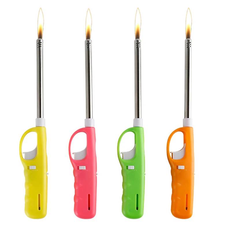

Ray if you use one of those lighters with the extended end then that will work with a vertical exhaust and you won't go dripping wax all over your engine. Cost about a pound

Thanks Jason. I've searched everywhere for candles with bent flames!

Discovered that a bent piece of 1/4" copper pipe fitted into the exhaust vent, so was able to try the candle test and got a nice strong blue flame with virtually no gas. Tried the engine at that setting, but refused to fire. Played around a bit more with the gas pressure and finally got the engine to run repeatedly for a short time when started with the electric drill. A few issues came to light such as things that needed tightening up, in particular the big end bolts, which accounts for the knocking heard on the video. I need to make some new bolts that are long enough for two nuts on each.
