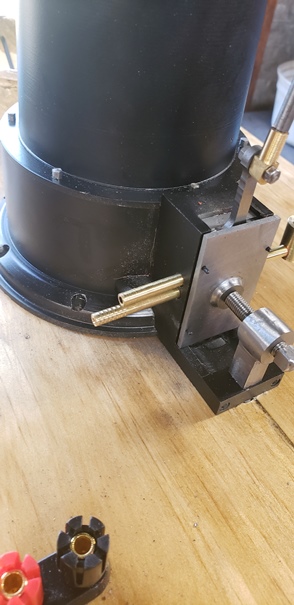

Today was spent working on the tubing to get fuel and air into the engine, and exhaust gasses out.  In the below photo you see the air and acetylene intake tubing.  The acetylene tubing is, in reality, a solid cylinder that I’ve drilled out.  It has a restrictor at one end that is drilled to .025 thousandths of an inch.  I’m thinking this might be a bit too narrow, but I’ll start there and go up if needed.

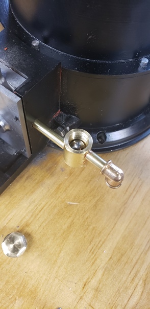

Things get more interesting on the exhaust side.  The exhaust needs a one way check valve in order for the engine to operate correctly.  This is because the slide valve returns to the “neutral” position, where the exhaust port is opened to the cylinder, before the piston has been driven down toward the bottom of the cylinder by atmospheric pressure.  Without the check valve, air would just rush into the cylinder and the engine wouldn’t get all the power out of the atmospheric pressure it would otherwise.
The full size Otto Langen engines use a ball valve and I’ve designed this little valve to function likewise.  The full size has an oval casting with internal passages; something I really can’t duplicate by machining.

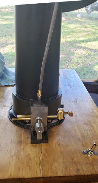

Here’s a photo of the completed valve and tubing, ready for application of the flexible acetylene delivery tubing.
I just couldn’t resist making some kind of builders plate for the model.  I just made up a patent number.  It’ll be interesting to see if someone notices.
