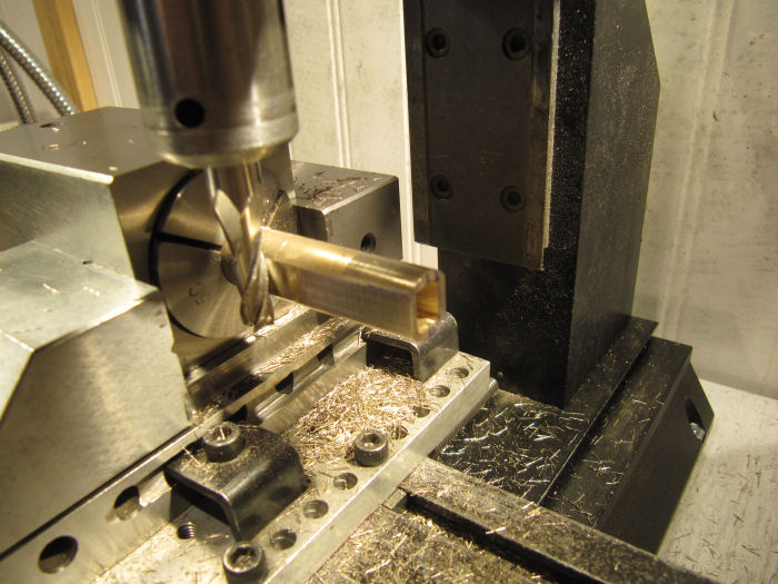

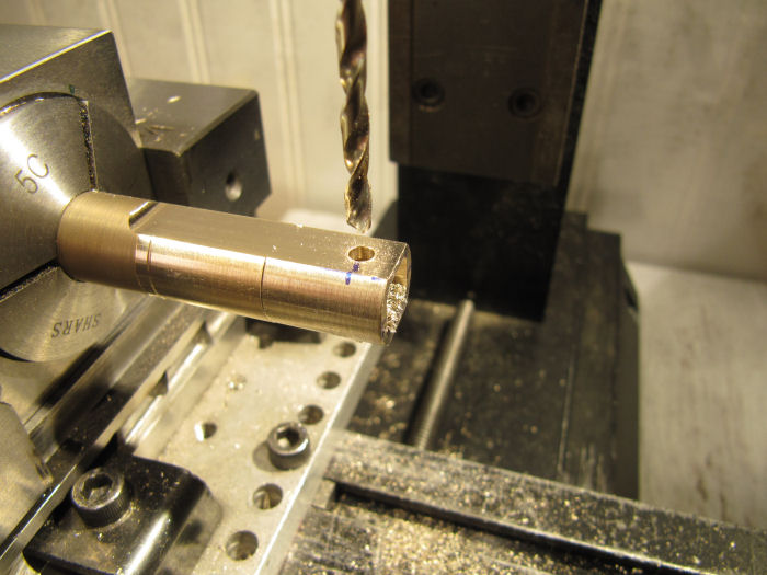

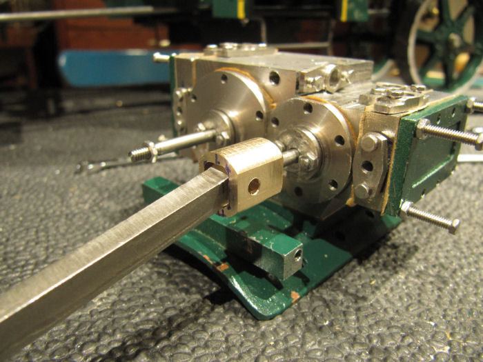

Started in on the crossheads, beginning with the HP cylinder one. Turned a length of bronze bar to size and drilled the hole for the piston rod on the lathe, and then held it in a 5C collet block for shaping the rest of the way. Milled the opening in the end for the connecting rod first
then milled away the flat on the side. Took it back far enough for both crossheads, since I can leave the rod in the collet from here on.
Turned the collet block 90 degrees to drill the hole for the wrist pin

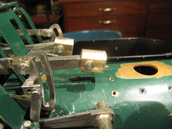

Then sawed off the piece to length, and cleaned up the cut face on the lathe. Here it is on the engine...
The forward end of the block is threaded, and there is a lock nut on the piston rod end to hold it in place. So, on to the second crosshead, for the LP side. Another verse, same as the first!

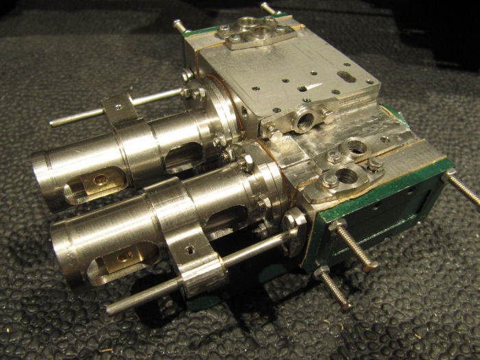

Today made up the shoulder bolt pivots for the crosshead/con-rod connection - had to go thin on the heads to get them to fit in the guides.
And then spent a while getting the crosshead guides and lower end caps all bolted up with the gaskets. The LP studs were easy to tighten up, but there is very little  room on the HP side so had to go one flat at a time, lots and lots of turns!
Then loctited the valve rod support arms into position on the guides, using a section of the valve rod stock to align them. Will let that set up overnight, next up will be the valve sliders/rods/nuts/clevises.

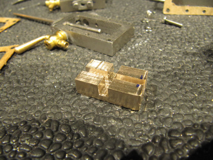

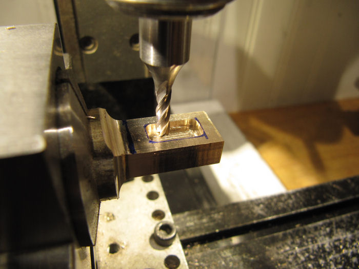

Couple days out of the shop, mainly taking care of my mother (priority! ), back at it again this afternoon. Got the holes drilled/tapped for the drain cocks that will be in the bottom of the steam chests (no room for ones on the cylinders), and also got a start on the HP slide valve. Started with a length of bronze bar held in the 5C collet block, and shaped the end to size (those square blocks are great for this, very repeatable clamping in the vise).
Then milled in the opening in the underside. Actually did these first two steps twice, since the first time I made the opening in the bottom too deep, and it would have connected with the valve rod.   :wallbang:
Turned it over, and milled in the slots for the valve rod and adjusting nut using a small end mill
Here is the part so far, cut off from the main bar. Still need to trim it to final length, take some material off the top, and lap the bottom smooth for a good seal. You can see the drain cock in the steam chest in the background.
