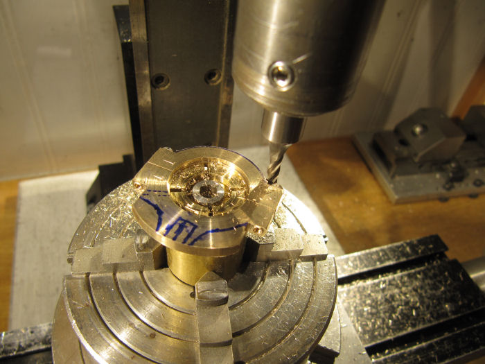

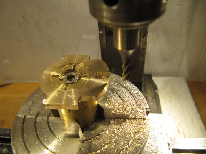

Got started profiling the eccentric followers, beginining with the bottom end which is a simple arc. Used the expanding arbor on the rotary table to hold them:
Once all four had the bottom ends shaped, turned them around and milled in the slot for the arm going up to the reverse link. These arms will be steel, and silver soldered in place.

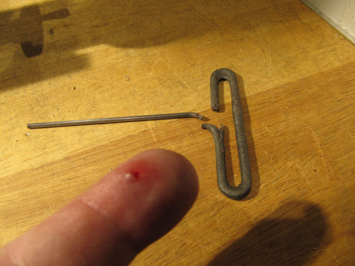

Oh, and when tightening in the end mill to the holder, my trusty old t-handle hex wrench apparently was possessed by an angry shop gnome - it broke at the top bend and bit me, the little bugger!
Do shop gnomes carry rabies?   :shrug: :Jester:

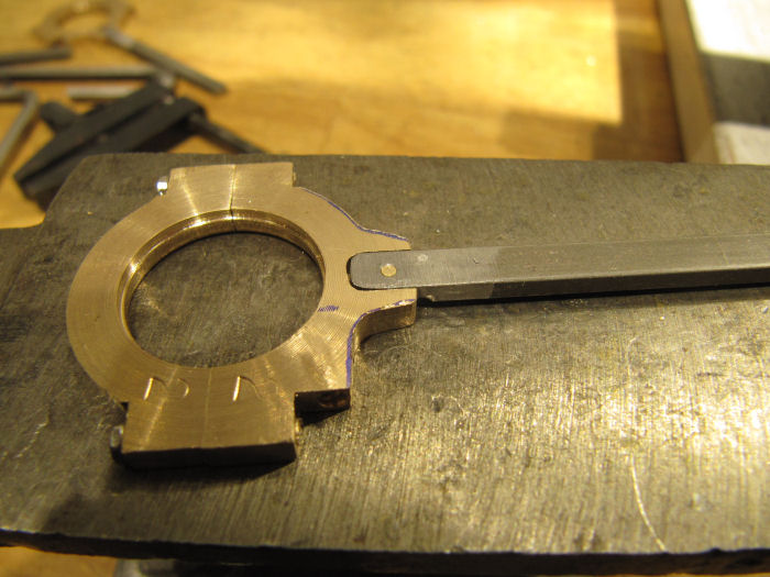

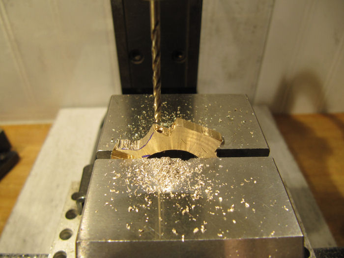

Catching up on some work on the eccentric followers, I had finished shaping the outside profiles and drilled the oil passages. The end of the hole was counterdrilled out larger to form a little cup to help the oil drop go it (I have a needle tipped oiler that is handy for these sorts of spots).

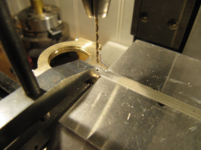

Here are the followers along with the blanks for the steel arms. The end of the arms at the follower is rounded to closely fit the slots, the other end is left long to take the yoke for the reverse link.
To hold the arms in place for soldering, drilled for a 1mm brass rivet:
which holds it well for the next step:

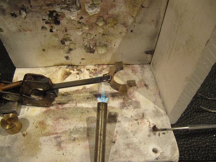

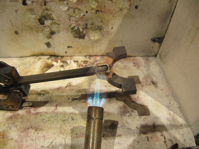

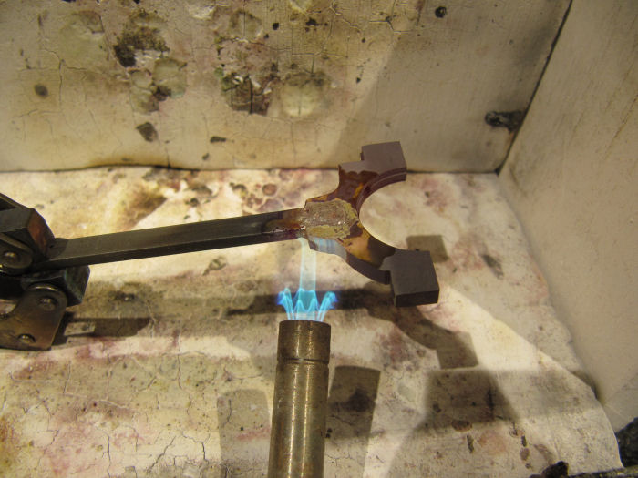

Never tried taking photos while silver soldering before, but here goes. Held the end of the arm with a clamp so I could hold the torch under the part, fluxed the joint and put a little u-shaped piece of silver solder wire on top. The flux is Harris Black, the solder is Easy Grade 20 gauge wire, 65% silver. With the torch underneath, started heating the part. The flux first boils off the water, requiring a poke with a pointed rod to shove the solder back into place.

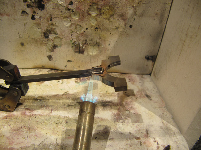

Here the part is getting up to temperature, and the flux has gone clear:
Solder starts to melt and flow into the joint:
Added a little more solder from the coil end for good measure, and heated till the solder was liquid all round - stopping too soon will give a weak joint.

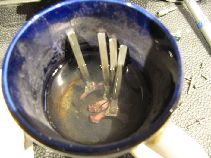

Did all four, let them cool, and started to clean them up. For these parts, which are steel and bronze, I did not want to use the Sparex 2 pickle that I use for brass since the steel will contaminate it, and the solution will transfer some of the brass color onto the steel. So, I put some white vinegar (common grocery store stuff) into an old cup (which is used only for this) and put the parts in to soak.
I gave them an hour or so, rinsed and wire-brushed them, and put them back in for a while longer, pics later when they are clean. I like using the vinegar, cheap, safe, easy to dispose, just takes longer than a stronger acid does, but that is a good tradeoff.
Interesting... I also use Sparex and find that my steel parts come out with a copper/brass color coating on them.  It's very thin and easy to buff off, but I never really thought about where it came from.  So is that just from the Sparex? Or from the brass parts that have been in the pickle before them?
Very nice in-process shots of your silver soldering, Chris!
Re: Chris's Mann Wagon Build
« Reply #1064 on: November 25, 2020, 05:57:37 PM »
I think its some coper or brass residue from the parts before them. Sparex makes a nbr 1 version that is meant for steel parts. Harder to find but its out there. I try and keep the Sparex just for the brass/copper/bronze parts - I did pick up some of the Nbr 1 version but never got around to mixing it up in another container.
