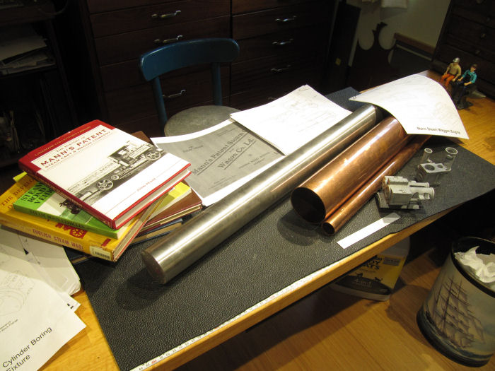

I've gotten the workbench cleared off, moved the excavator up to the big bench in the wood shop where it has room to maneuver, and brought in the books and plans, along with the materials for the boiler and engine:

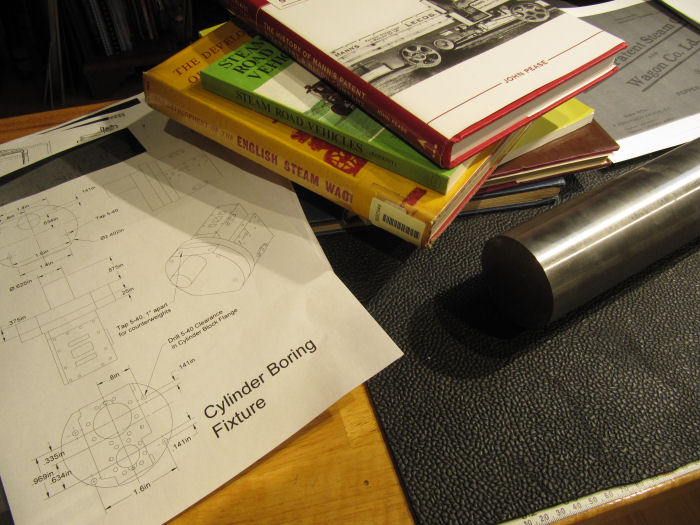

The big steel bar was a good find - was pricing out short lengths and found this offcut drop at Yarde Metals - over 3' long for less money than a 1' piece at the normal suppliers. Heavy beast, 50 pounds, but a lifetime supply of 2.5" diameter 303 stainless! Also had the engine components 3D printed for reference, have found that a very handy thing to help keep track of parts with odd shapes and to plan out order of cuts.
Got the 2D paper plans all made up from the 3D model, along with figuring out the holding fixture for the engine block, shown with the stack of books. One nice find was a copy of an original Mann catalog that I got from the Road Locomotive Society over in England. The gentleman who runs the storefront was kind enough to dig out their copy and scan it for me (reprints were long sold out) - I sent them a nice donation for the time and postage, was great that he was willing to take the time for that.
And to fill out the rest of the 'castings', my bar stock supply should work out pretty well. Also have enough copper sheet stock for the end caps on the boiler.

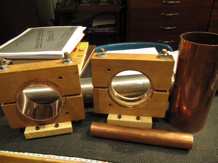

And first swarf made! measured out and cut the copper tube for the boiler shell, smokebox shell, firetube, and the ring to hold the smokebox on. The ring will be cut through at the bottom so it can be expanded to fit over the smokebox/boiler shells. Also, dug out my super-high-tech fixtures for holding the shells on the mill for boring out the holes in the side. Yup, real high tech, blocks with semicircles cut out and threaded rod to clamp them together around the tube. The last boiler I did was a larger diameter, and I had cut out the semicircles to fit. For this one, cut some rings from wood and glued them back in, using the pipe as surfaces to clamp against while some wood glue sets....

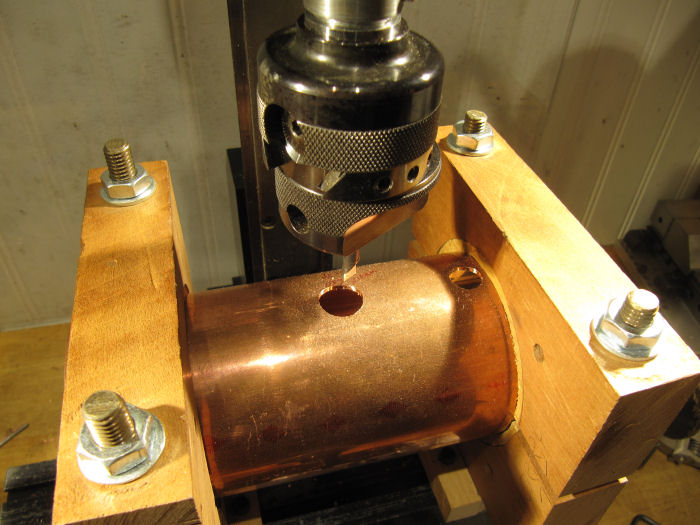

And here are the tube holders in use, to drill/bore the holes for first the water fill bushing:
and the 'steam dome' opening. In the Mann Overtype wagons, the engine bolts down over this opening and the inside of the engine acts as the steam dome, with the throttle valve at the top. There is a gap between the cylinders up inside the engine for the steam to rise.

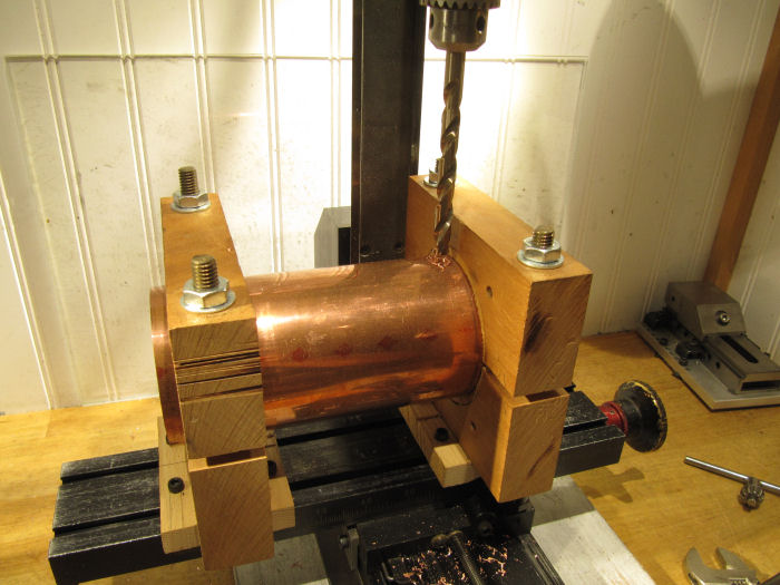

To position the tube for the different holes around the tube, there is a tick mark on one of the holders at top center, and I have marked out ticks on the end of the tube at top/bottom/sides, and at the angle down for the cab bushings. These were done by standing the tube up on an end view of the boiler plan, and just marking the tube from the paper plan.

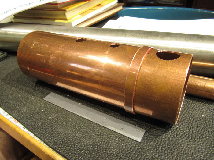

After lunch continued with the rest of the holes in the boiler shell, pairs of them on the sides for the bushings to take studs to mount to the rear frame and the cab supports:
Those bushings will be small threaded ones, with blind 5-40 holes to hold the studs on the outsides.
Then switched over to the smokebox, boring the large hole for the smokestack:
Boiler and smokebox shells all drilled:
The connector ring was then cut through and flexed over the ends. This will get drilled/riveted in place later on.
