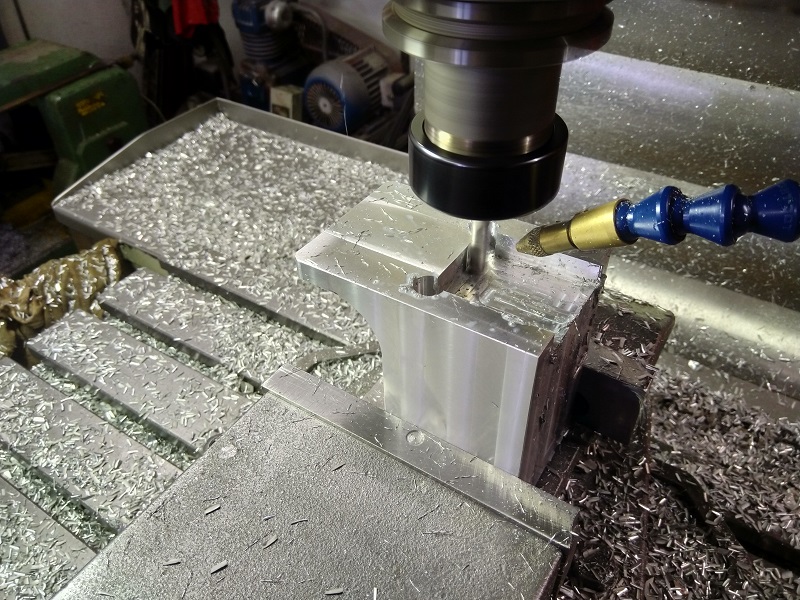

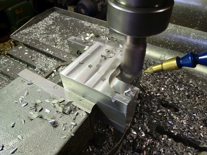

Hi everyone

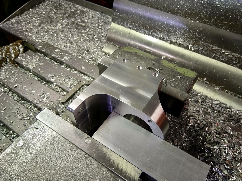

Since there is quite some material on the bottom of the engine frame, I decided to place there an additional plate with four screws for each half of the frame in order to fix the parts of the frame.
This requires an additional pocket to be milled in the bottom of the frame, like so:
I started then with milling the front half of the frame.
Squaring up the stock.
Milling the front radius
Milling the pocket and reliefs for the fixing plate.
Pocket done and holes drilled and tapped.
Threads where the water hopper will be fixed and hole for the lubrication.

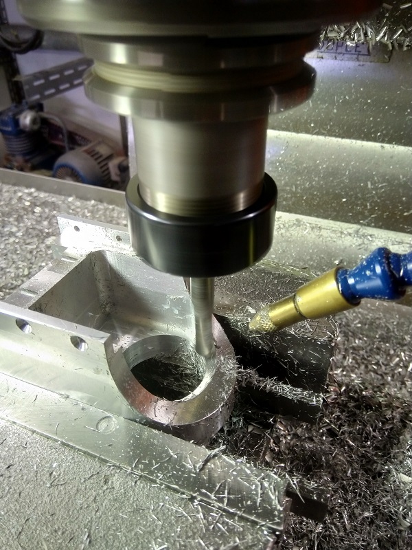

Then a pocket was milled where the cylinder will be fitted. The pocket is a bit deeper than the wall of the frame will be.

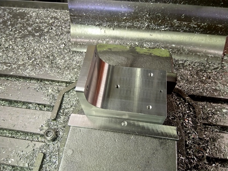

Next the radius on the upper side of the frame was milled.

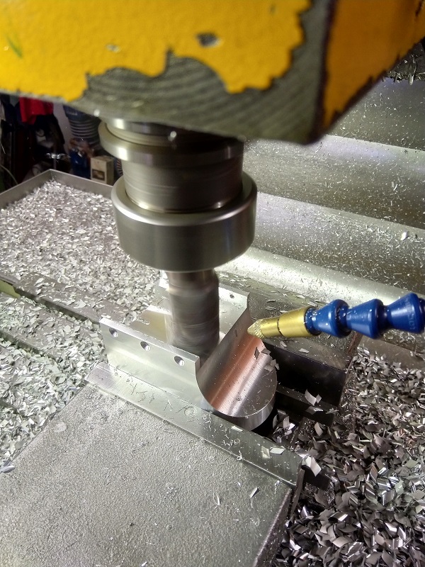

Milling the top radius.
Holes for the bolts to connect the frame parts drilled and countersunk.
Milling the connecting part of the frame.

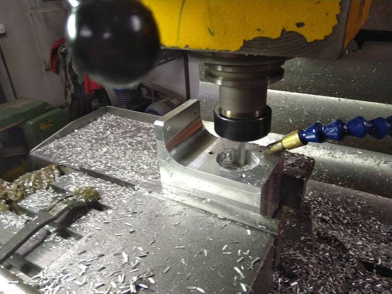

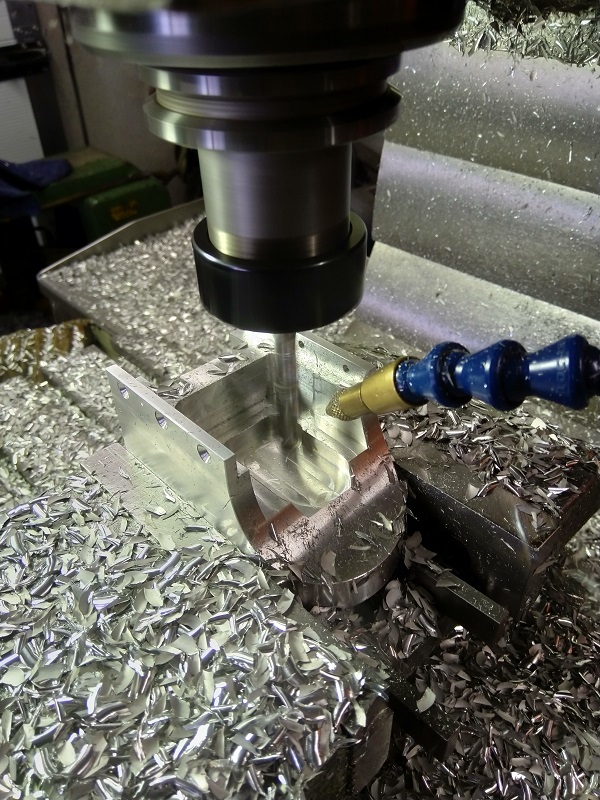

And then there is only a pretty deep pocket left to be done.

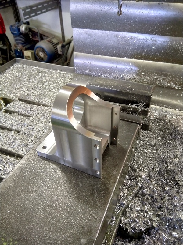

finishing cut with a ball nose endmill to create the radii in all corners.
Done  ;D  The thread for the oiler on top is missing, since I haven't decided on the size of the oiler yet.
