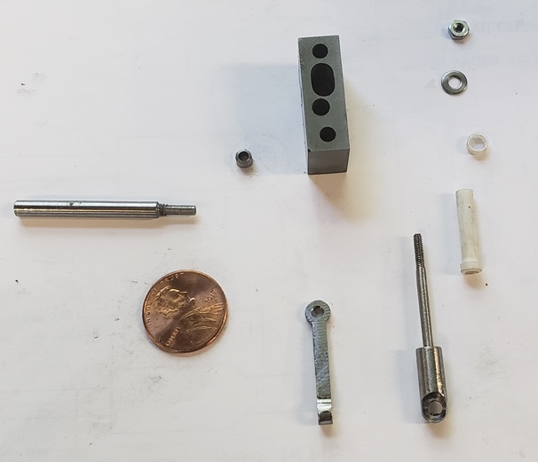

Other duties called over the last few days, but now Iím back in the shop.  Iíve started building the igniter: more little parts to fabricate.
Below you see the igniter frame in the top center; then a spacer to the left and the igniter drive shaft on the far left.  From top right to bottom are a 2-56 nut to hold the insulator assembly together, a washer, then the insulator top washer followed by the insulator.  At the bottom are the stationary electrode and the moving electrode.  I still need to silver solder the contacts into the electrodes.

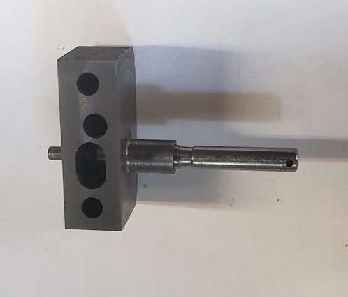

Here is a photo of the igniter body.
The problem with this design is that the side of the body where the drive shaft protrudes is very slim and it doesnít make a good airtight seal.  The leak on the small side of the shaft isnít appreciable but it is substantial on the large side of the shaft.

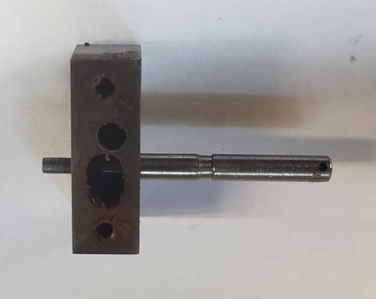

I re-designed the igniter body; below is a photo of the re-design.
The extended shaft raceway provides a better airtight seal; after assembly I canít blow any appreciable through this new assembly as I could with the previous design.
With the re-designed igniter body Iíve re-assembled the igniter to the engine; tomorrow Iíll see if my compression problems are behind me.
