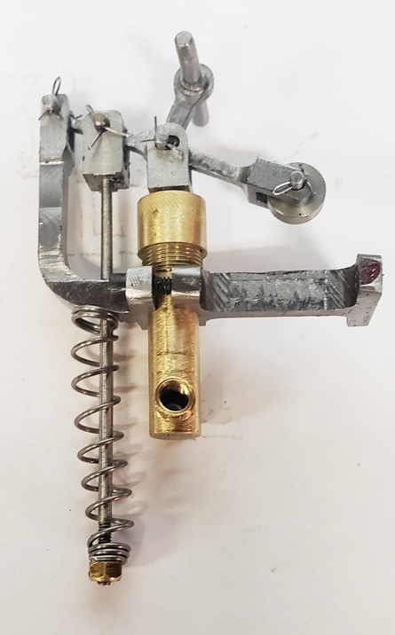

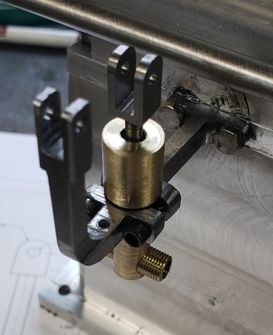

It’s been a few days since my last post; but I’ve been busy.  I was a bit negligent in ordering the flywheel castings (in fact I just got to it today).  I could use them now, but there still is a lot to do so I can afford to wait a while yet.  I’ll be using the same 10 ½ inch flywheel casings I used on the Crossley Otto Langen, and probably be removing around the same amount of material.  This engine is characterized by large diameter flywheels with thin rims that, in my opinion, gives it a lot of its “curb appeal”.

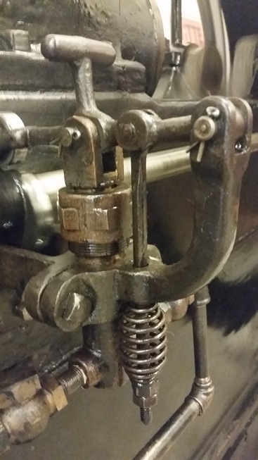

I’m currently working on the fuel pump.  Below is a photo of the pump on the full size original so you can see where I’m attempting to go.
Here are a few photos of my progress so far.  The fuel pump is “front and center” on the model so it deserves a bit of attention to make it look somewhat like the full size castings.

I spent the entire day working on this pivot arm.  It took two tries; the second attempt came out not great, but acceptable.  The remaining parts to this fuel pump should be somewhat easier to make.

Excellent work on lots of fiddley little bits  :praise2:  :praise2:  :wine1:

Maybe a watchmaker could put in all those fillets and chamfers.

That looks like quite a lot of work for such a small piece. It looks great! You look to be making good progress.

Craig, I think you made a mistake. The part is much smaller than the drawing on the plan ... :)
Continued excellent work on those "fiddly little bits"!

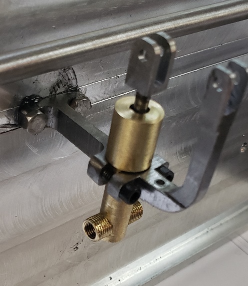

I’ve finished the fuel pump.  Below is a photo.  I would have placed it on the engine for a final shot but, I had a few misaligned holes on the base to repair with JB weld and couldn’t re-assemble everything while the cement dries.
