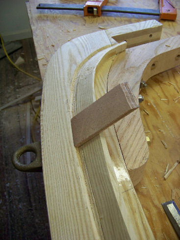

with the heavy stern keel work done, started the heavy work on the bow sections and fitting the brass cut-water,, not much fun working the oak here also, thinking I should have made a 1/6th scale adze ::) ::)
what the @#&% over
  • Posts: 18689
Re: 30ft 1890's navy steam launch 1/6th scale
« Reply #371 on: December 08, 2022, 02:54:19 AM »
My first reaction to those last two pictures was 'hey, he stole my sailboat stem!'    :Lol:
One thing that was done on some traditional boats was to build up inside where the planking goes by adding filler pieces, like the two shown behind the stem here:
here they are installed and faired in:
then the shallow notch is cut in to take the ends of the planks. This method gives a winder landing for the plank ends and screws without having to cut such a steep notch in the original stem
You are doing a great job - this summer you need to start on the full size launch hull!
