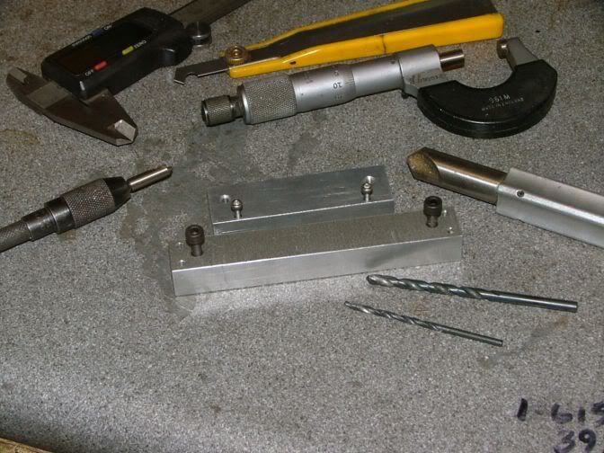

Another of my transfer posts, but this time, there are a fair amount of hints and tips in the post that could be used elsewhere, so you will have to get bored and read the lot.
This all started a few years ago, when I installed my then new lathe, and decided to fit a couple of extra DRO's, one on the compound and another on the tailstock, to compliment the two it came with. Once you get used to the accuracy of using something like this, you soon realise that drilling to 'accurate depth' under normal situations is not very accurate at all. More like a disaster waiting to happen.
On the tailstock, I had machined a rail carrier for the glass slide out of ali, and had it running on four ball races. Unfortunately over the last year, swarf had found it's way into the top channel, and the rollers had then forced and embedded it into the aluminium. When you operated the tailstock by the handle, you didn't feel anything, but once the rail was disconnected from the tailstock ram and slid along by hand, it felt rough as old boots. This will only get worse, so I have decided to relocate the assembly to on top of the tailstock and make the rail out of a more durable material. Then I should be able to protect it a little better than I had done before.
This is a picture taken before I set to work.
Ten minutes had the tailstock almost back to original.

All that long steady machining had really paid off. The bearings were a perfect fit in the slots, with only the merest hint of side play.
A little relief was made in the side to allow for a modified fitting regime. By doing this, I can squeeze the complete read head width up by as much as 15mm compared to the previous fitting. Also a couple of mounting holes were drilled and tapped to 4mm.
This picture actually proves that you can make a silk purse out of a pigs ear.
The original rail is in the middle, the new silk purse at the bottom and what bolts onto it at the top.
