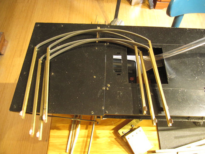

Continuing on with the cab framing, cut a pile of the bottom gussets out of thin sheet stock, notched the outside of the frames for them, and soft soldered them in place. These would have been welded to the floor sill on the real machine, but since I want the frames to be removeable (screwed in place) they are just attached to the frames. The will rest on the sill, and help keep the frames from canting to the side.

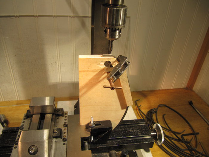

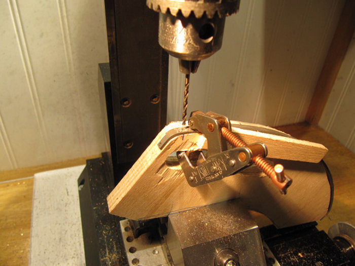

Started in drilling the ends of the ceiling ribs so they can be screwed to the tops of the wall frames. Using the bending jig as a holder in the mill, cut a slot for a clamp and added a block on the side so they can be inserted consistantly along the edge for aligning the drill in the center.

Yup, jig worked out well for bending and drilling - will get more use when drilling the holes for the long ceiling beams too.

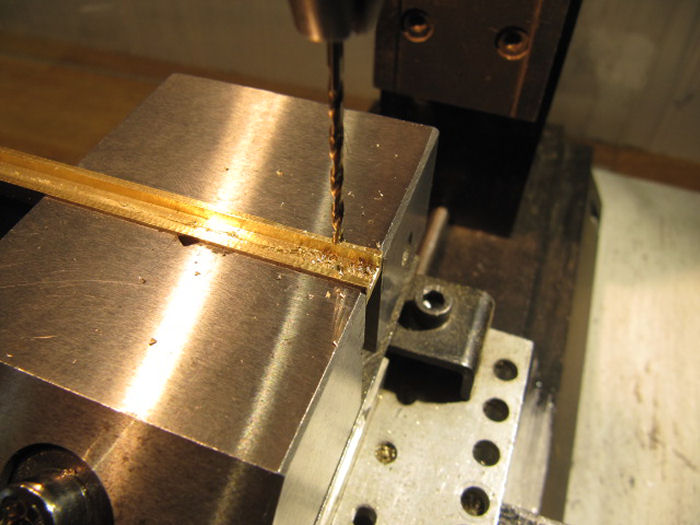

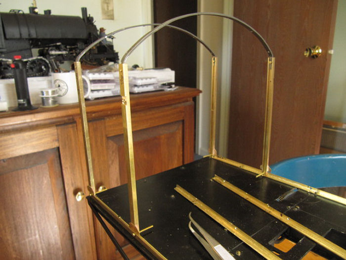

Got the holes at the top of the wall frames drilled/tapped 1-72,
and have started test assembling them - some minor filing needed on a couple for a good fit.
Next will be drilling the holes in the floor sill to attach the frames to, then start notching/drilling the ceiling beams.

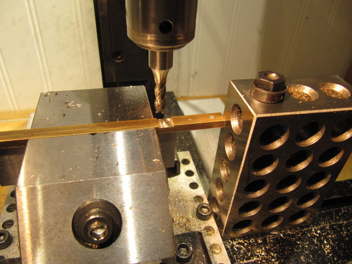

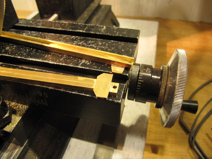

Got the screw holes drilled in the floor sill angle strips, and milled the half-lap in the wall frames that will have door headers in them. Used a 3-2-1 block as a stop to get all the notches in the same place...
Using the ceiling beam bending jig to drill the holes for the lengthwise beams, which will notch over the cross beams. There are six long beams, so am setting up to drill the holes a pair at a time in the cross beams, drilling one then turning the beam around to do the matching one at the other end, then will reset the position for the next pair farther in.

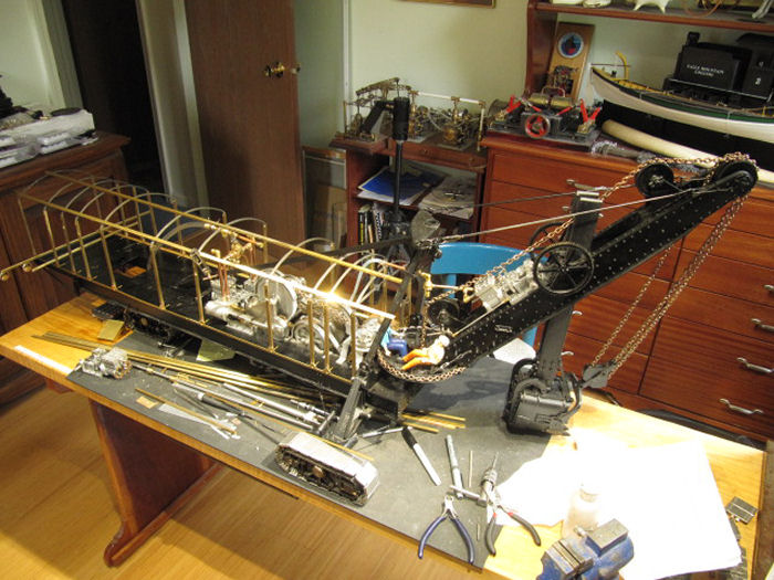

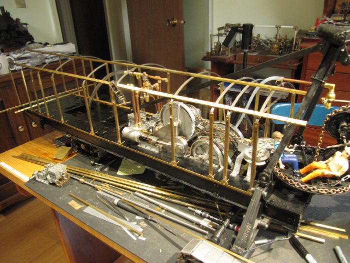

Flashing back to playing with my old Erector set (Meccano in other countries) as a kid - started putting together the frames on the model. The sill plate is screwed down using the existing screws holding the floor plates to the main frames, and the wall/ceiling frames are bolting to that. Doing them one at a time as I get the ceiling frames tapped for the lengthwise beams.
Going to start looking like a cab pretty quickly!   :wine1:

« Reply #3929 on: May 24, 2019, 05:57:18 PM »
Wow, this is really changing the appearance of the model, making it look even longer than before. Got the rest of the wall/ceiling hoops up, ready to notch and install the ceiling beams (two set in place in the photos, there will be six of them altogether).
